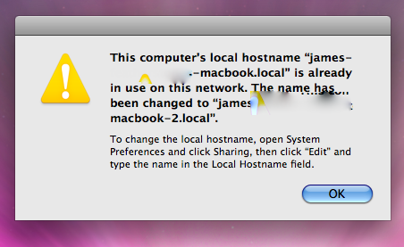

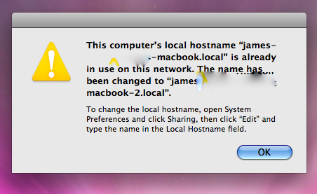

Ok now I got this:
Is anything to worry about?

Ok now I got this:
I don't think so. I've seen that happen when deleting locations and/or network devices (at least, that's what seemed to cause it). You can just change it back to what you like per the message's suggestion.
Good, I did change it back. I am going to do what others said and see if I an get this thing working. I just got AppleCare for this also, so at least I have 2 more years to get this working.
