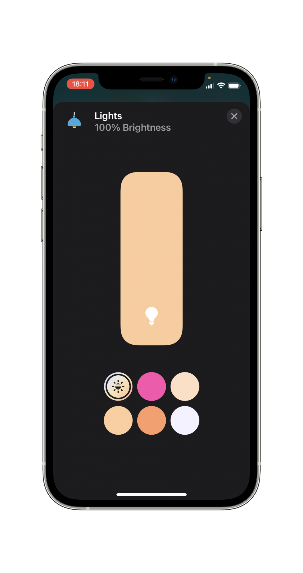

As you may know, Hue recently announced support for Adaptive Lighting in iOS 14. I have successfully installed the firmware update, enabled it per device and per scene as shown below, but... it still doesn't seem to be working.
To be very clear on what I have done:
  1. Installed firmware update through Hue app.
  2. Opened Home App on iOS, enabled Adaptive Lighting through prompts.
  3. Opened the "Good Morning" Scene (which I use every morning) and shifted EACH Hue light to the Adaptive Light settings
    1. Additionally, to ensure that there is not something wrong with the scene, I independently enabled the Adaptive Lighting setting outside of the Good Morning scene, and it results the same way.
  4. The lighting correctly adapts to the morning tone, but does not change throughout the day or in the evening.
Has anyone gotten this to successfully work? If so, can you give any steps you took?
