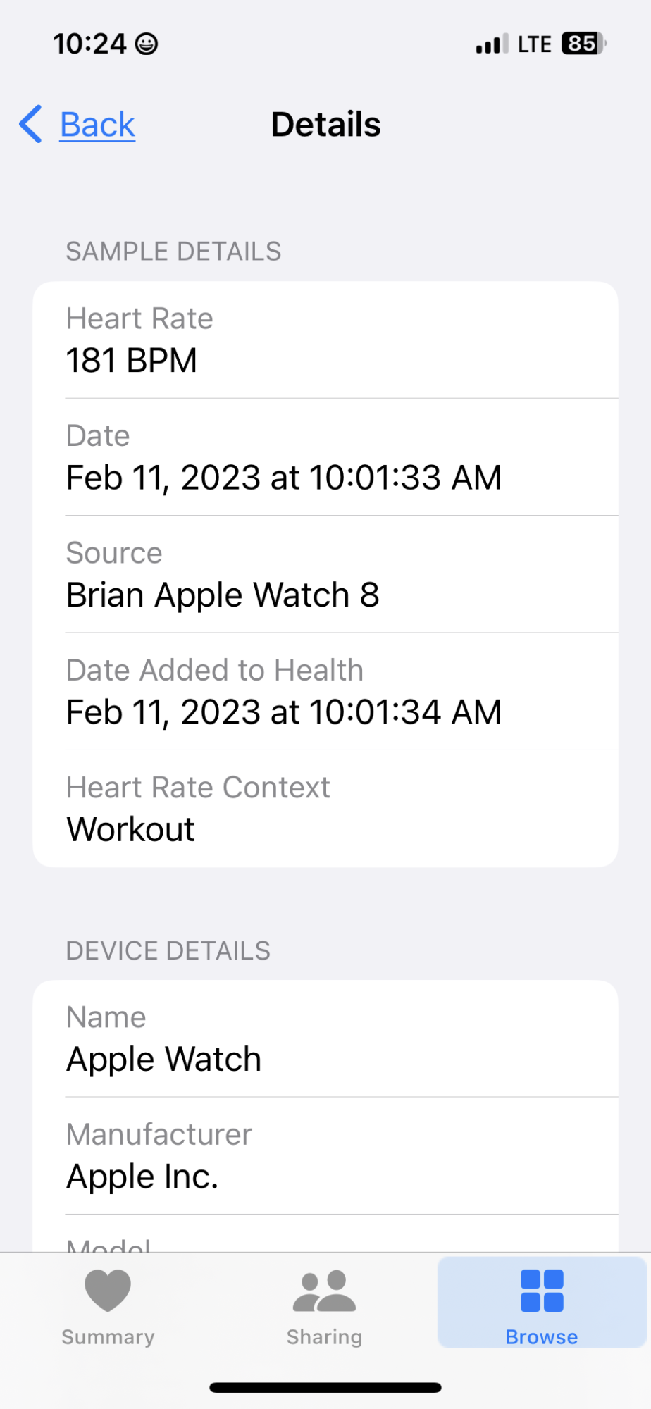

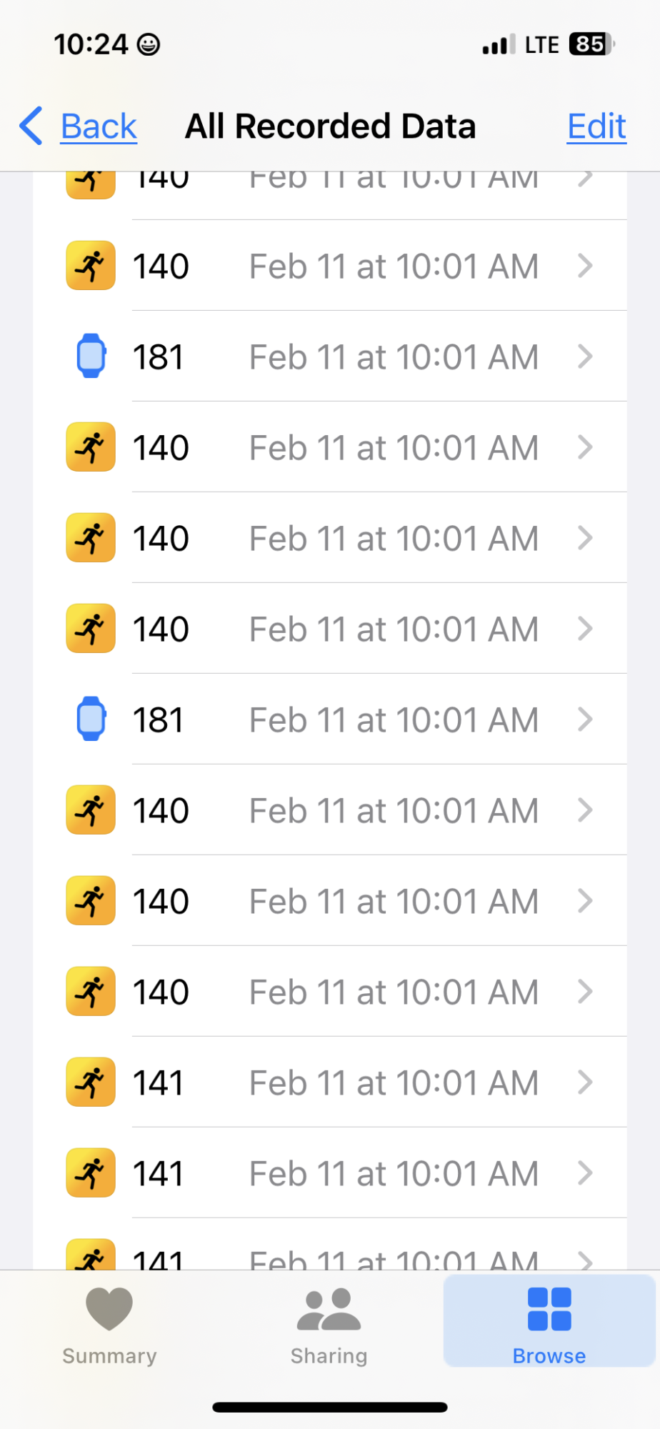

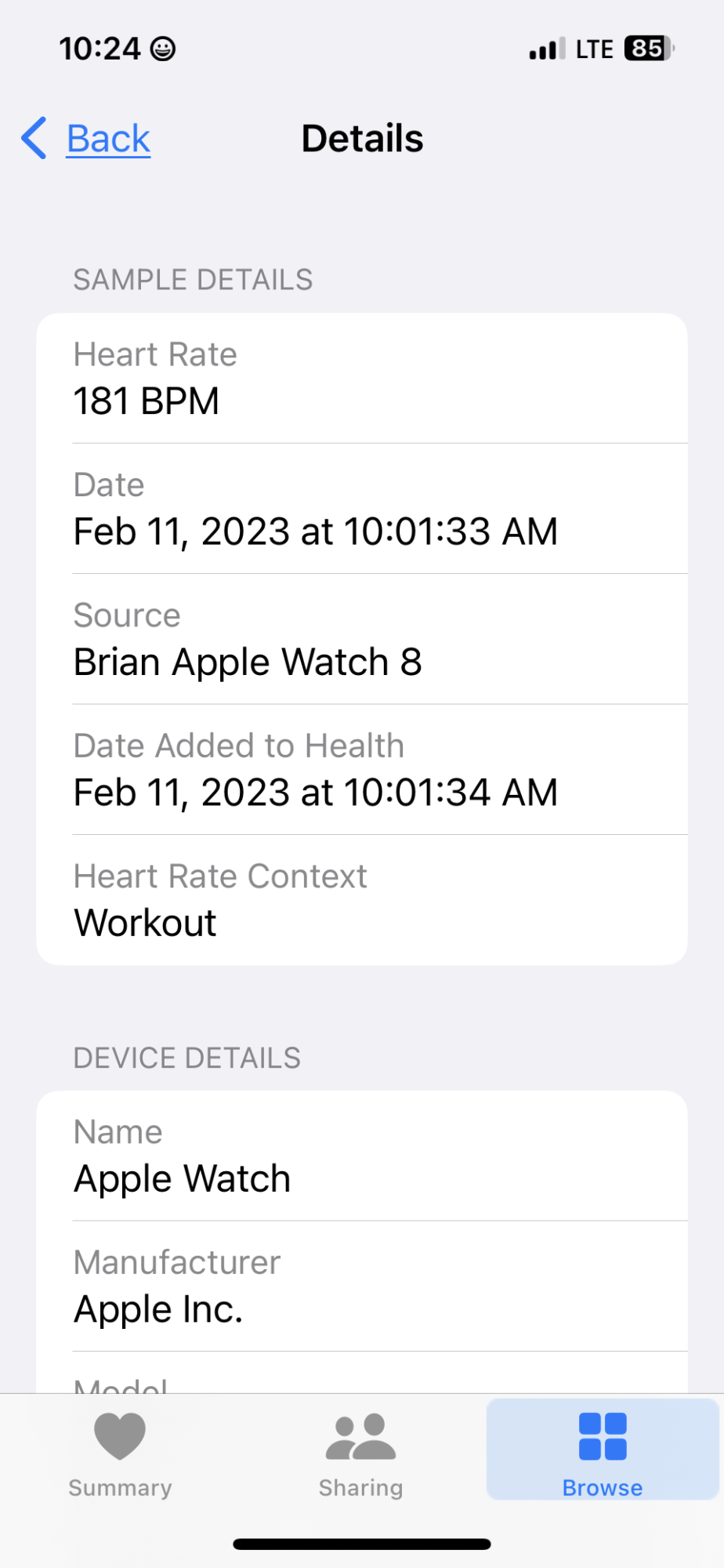

At long last, I have finally found the smoking gun for my elevated heart rate numbers.
The situation is: I use WOD to connect to my Wahoo sensor. I do absolutely nothing with Apple Workout on my watch, but apparently it still records regular heart rates during the workout. Absolutely No idea why Apple Watch is consistently recording a heart rate in the 180s at the exact same moment that WOD is recording 140 from the Wahoo.
In any case, now that I know what the problem is ... can I assume that there's no way around it? I guess I need to connect my wahoo to Apple Watch so that it won't use the sensors on the watch itself. Which is unfortunate because it's so much more convenient to connect via WOD.
Does anyone have any ideas here? Or can I just assumed that I am out of luck and need to stop using WOD to connect to my heart sensor.
View attachment 2157245View attachment 2157246
It's almost too ridiculous to mention, but I have found somewhat of a "Workaround" to my long-running problem with Apple Watch heartrate monitor recording un-realisticly high values during WOD workouts.
I have found (by accident) that if I wear my watch all the way up to the top bony part of my wrist, this is where the bad behavior happens. It's no uncommong for me to get readings as many as 40 beats higher from Apple Watch than for my external heart rate monitor.
However, if I wear my watch about 1/2 inch below the bony part, for whatever reason the heart rate values from apple watch are more consistent. They might be 2-3 beats higher at times, but it doesn't completely ruin my average and max heart rate values when I wear my watch this way.
I have tried the "below the wrist" method for about 5 runs now, and this is consistently working. There are no outlandish (190+) readings when I wear the watch lower.
Likely nobody else cares, but this is a serviceable workaround to this long-running problem for me. As a result, my VO2Max values are starting to get reasonable again and my running program (TrainAsOne) seems to be throwing me more challenging runs
