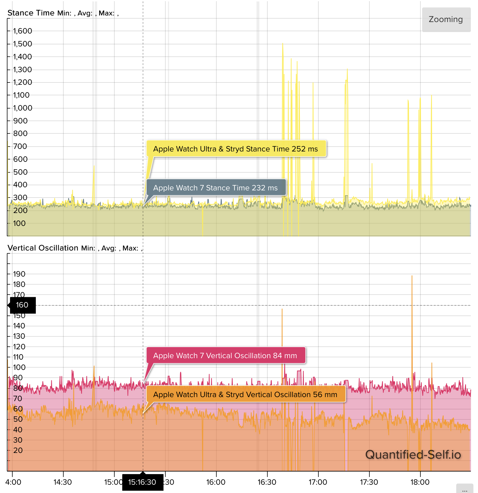

Sorry, there are issues with GCT and VO when using Stryd. To be honest I am deciding whether or not to remove support for the Stryd footpod because it seems more hassle than it is worth. Also their lack of help when I ask for it makes me think that they don't want other apps supporting their hardware.
However I figure that while the main data is still working then I will keep support for it. If I do look into VO/GCT and can't fix them then I may change the app so that it gets VO and GCT from the watch rather than Stryd, even when using Stryd.

In my last run, I found vertical oscillation from the Stryd Wind connected to AWU and AW7 worn on the other wrist pretty different tho, which makes me curious to double check by connecting the Stryd on my Garmin Via ANT+ to compare.
As seen on the graphs, the Stryd footpod reports ground contact time creeping up and vertical oscillation decreasing over the duration of a 4h30 run. IMO much more representative than what the Apple Watch estimates from the wrist.
Huge discrepancy between the Vertical Oscillations values.

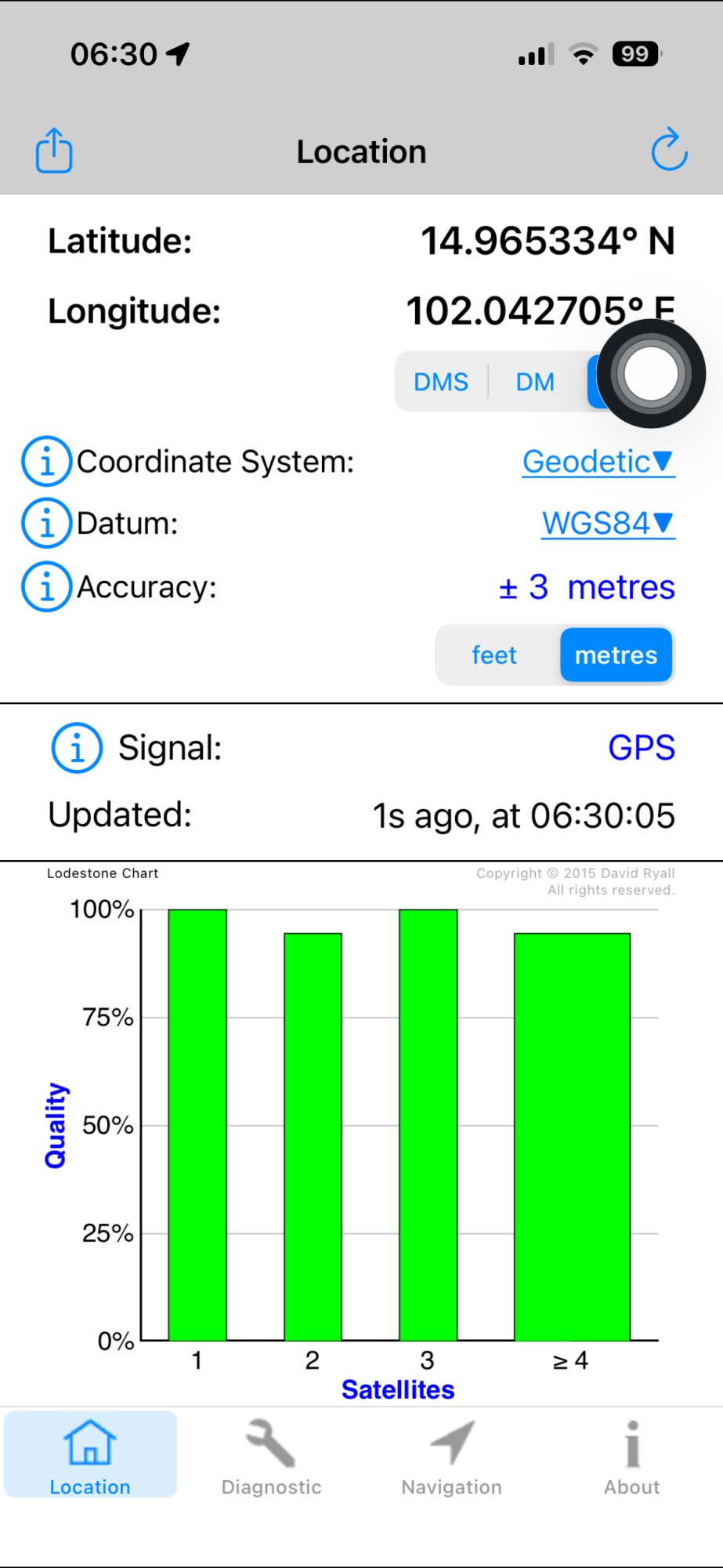

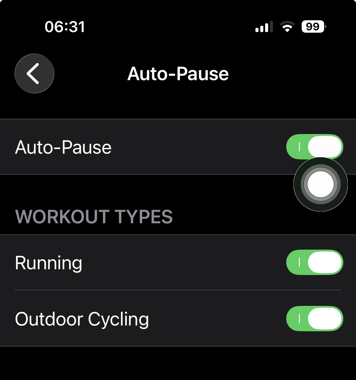

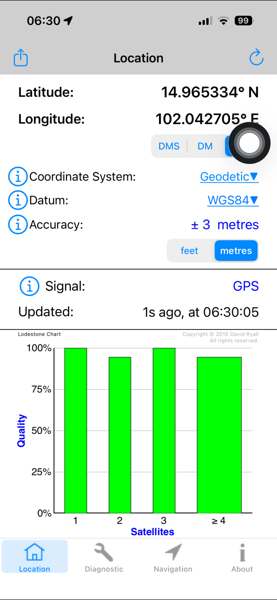

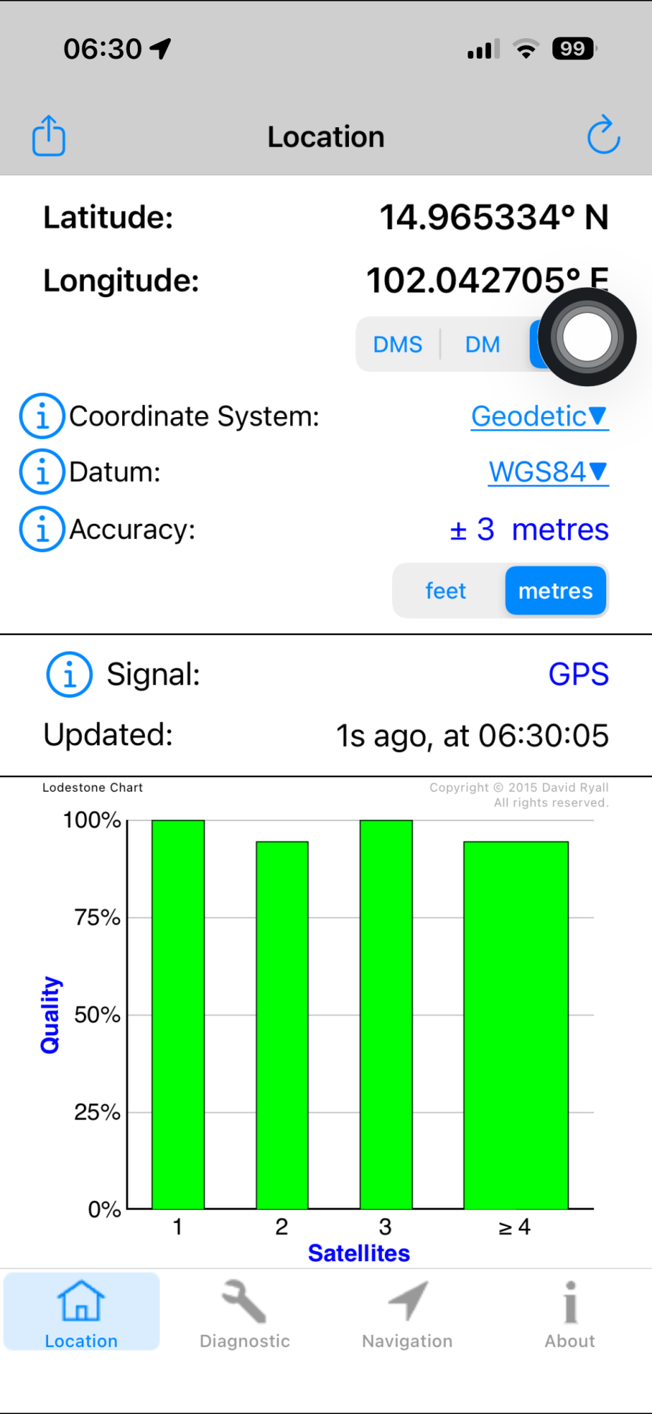

Spurious Auto-Pause​
Ultra 1 - OS 26.0.2
I've been using WorOutDoors for several years now and couldn't do without it.
This morning I started a running workout as usual. First I opened the Running workout to the START screen and put on my shoes while I waited for the heart rate data to kick in.
Once it did I started running. But after only about three seconds I got an auto-pause. I decided to continue running to see if it would resume, but it did not. So, I walked back home and started over again. Same thing; auto-pause after just a few strides. This time I ran a couple hundred meters more to see if it would resume. It did not, so I walked back home and started a running workout with Apple's Workout app. This worked fine with no spurious Auto-Pauses.
When I finished the run I used the GPS Diagnostics app to check the GPS signal and it was fine and nominally accurate. I checked the settings on Apple's Workout app and found, as expected, that Auto-Pause for both cycling and running was enabled.
So, what did I do to cause the spurious auto-pauses in WorkOutDoors?
Ultra 1 - OS 26.0.2
No-one else is reporting that. Do you have the app configured to use Apple's auto-pause or the WorkOutDoors auto-pause? To check go to Settings / Pausing (in WorkOutDoors, not in Apple's settings).
Also please could you send the wkt file for that workout to info@workoutdoors.net and I will take a look. To do this tap the Export button 3 times quickly.
