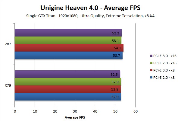

Regarding PCI-e 2.0 vs 3.0 have a look at this benchmark from toms hardware.

Talking about PCI adapters, you just can't update the motherboard to take advantage of PCI 3.0
1. Is placing a PCIe card in an empty slot really a compromise?
2. How does one take advantage of PCIe 3.0? List items that take advantage of a PCIe 3.0 slotted card.
3. If the items you list pertain to music and or video, I will list the alternative route.
