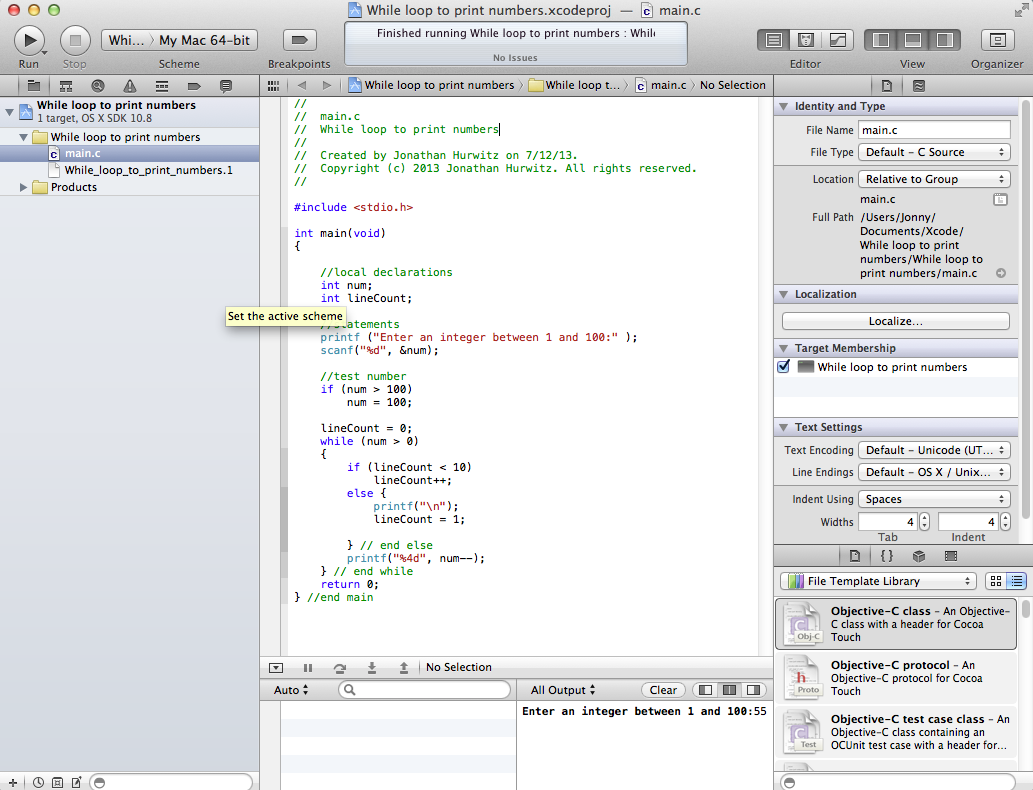

Well here is my first program. Please keep it mind it isn't elegant or complex, but if you can find my error I'd be very grateful. When I run this code, the output box shows "Enter an integer between 1 and 100:"
When I enter anything at all, it will just stop there. Please see the attached image.

On a Macintosh, the "Return" key and the "Enter" key are different keys and behave differently. Pressing the "Enter" key or Control-C will stop the program. Use the "Return" key on the main keyboard.
I'm an idiot. I've been using Mac OS since OS 9 and I made that error. Many thanks for the sanity check!
