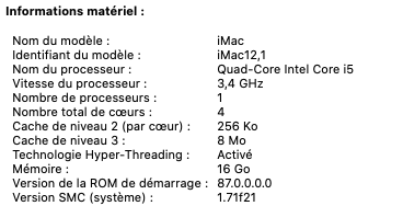

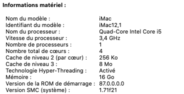

Hi,
the only test I saw was on a 27 "and it seems to work.
Being very curious, I ordered one for my 2011 21"5 iMac,
I would not fail to give the results of the test, otherwise I could,
but much later test on my 2011 iMac of 27 "(it is not at my place for the moment) if it does not work on the 21"5.
Have a good day!

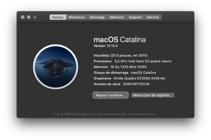

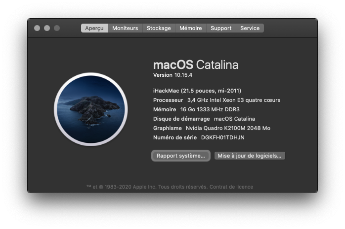

Hi,
installed, my Windows 10 installation no longer works, but I don't care! (No IGPU in the Xeon?).
Very happy!!! 😁
Edit: "comme quoi il n'y a que les imbeciles qui ne change pas d'avis" I remade it specially for I imagine all the Xeon E3 DSDT.aml, Windows 10 Boot well.

Hi @StephN999
This is so cool!
I also have iMac 21.5" 2011, but in Mojave.
1. Could you please let me know what was the purpose for the DSDT? Is it only for CPU naming?
2. Will the iMac work out of the box without it?
3. How's the iMac now? Is it stable? Fan spins loud?
Sorry for looots of questions, I'm so hyped to get this thing done in my iMac as well. 😄
Thanks.
Bonjour,
I thought that the SSDT would allow me to have a hibernation again, it is useless, on the other hand the DSDT is essential for Windows, not for macOS.
Otherwise ventilation level, no changes, even pushing the benchmarks, there is perhaps even better because the thermal paste must be better than the original (thermal grizzly kryonaut).
So stable, yes, but no more hibernation, at least for now.
Bonne journée. 🙂

Bonjour, 😊
do I need to flash rom/microcode to use the CPU?
Or does it work out of the box?
Thanks!
Re,
No, it is recognized natively just it will be marked as an i5 quad core in about this mac, as I use OpenCore for my graphics card, I just ticked a box (Update SMBIOS in platformInfo) and it is seen normally, but it is purely cosmetic and does not change anything. 😉
Re,

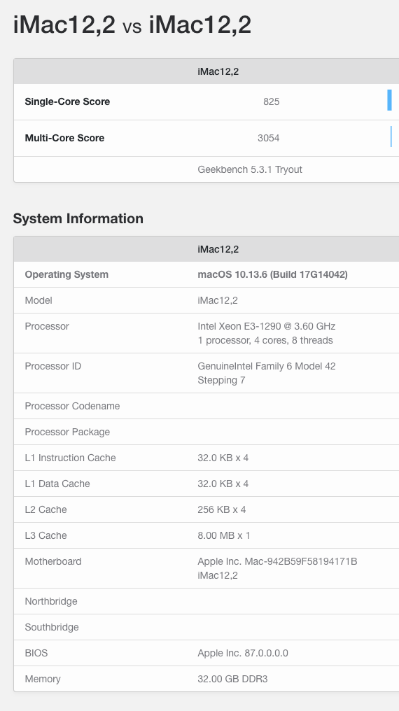

I have a Xeon E3-1290 running in my iMac 2011 27" with a HD 6970 2GB. I have to say i works great and fast. Currently i installed a Gigabyte Gaming Box with a RX Vega 56 Nano but get lagging Workflow in the Finder. maybe because of that. If somebody has an idea or tested a eGPU on the TB 1 i would be glad to hear about.
