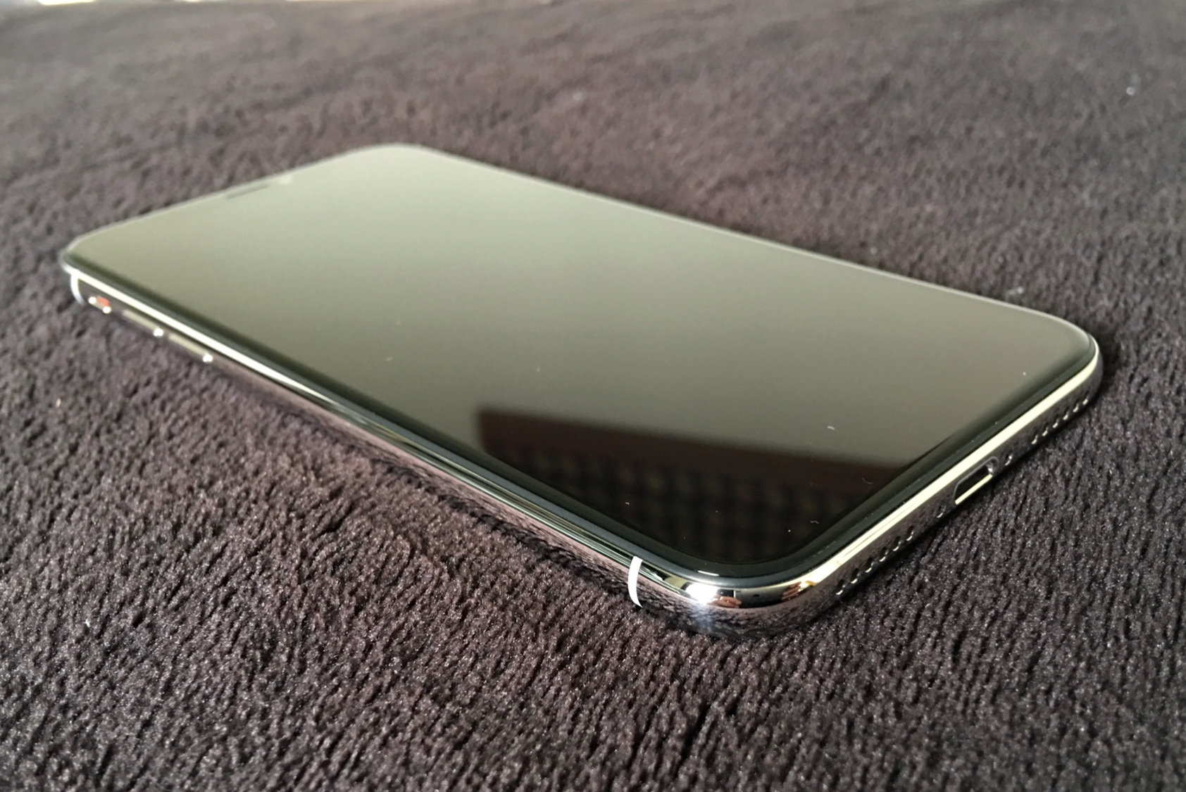

would like to see hi res before and afters of phones that have been polished
Post scratch removal:
(No Before)
(Borrowed photo from another Member who removed the scratches.)
