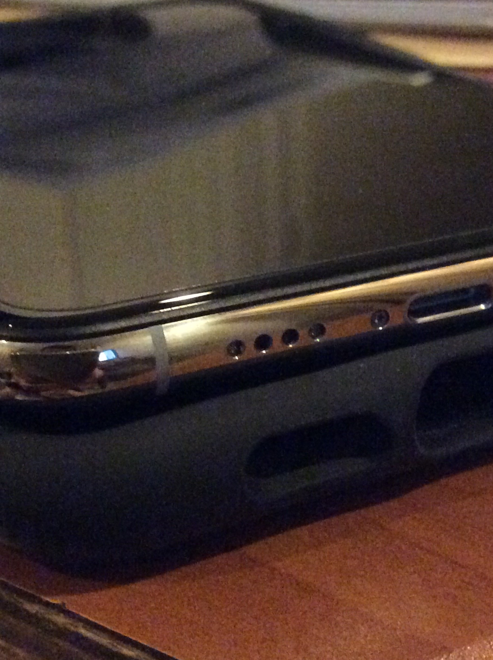

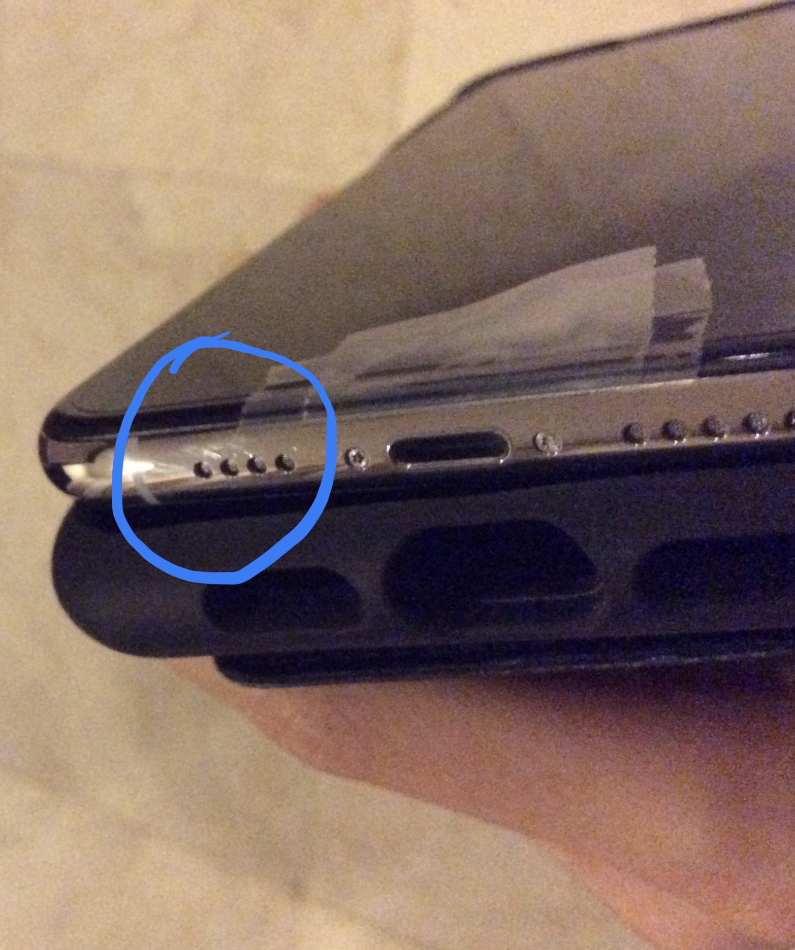

Pictures if you can.
first pic : i marked one of those “micro scratches” with the blue circle.
2nd and 3rd pic : micro scratch becoming straight line scratches after i wipe them more. but thinner and less visible.

The scratch was a pretty deep one from looking at the image. The autosol would remove it quicker due to it being more abrasive but left the abrasions in the direction of use. The CapeCod cloth should remove.

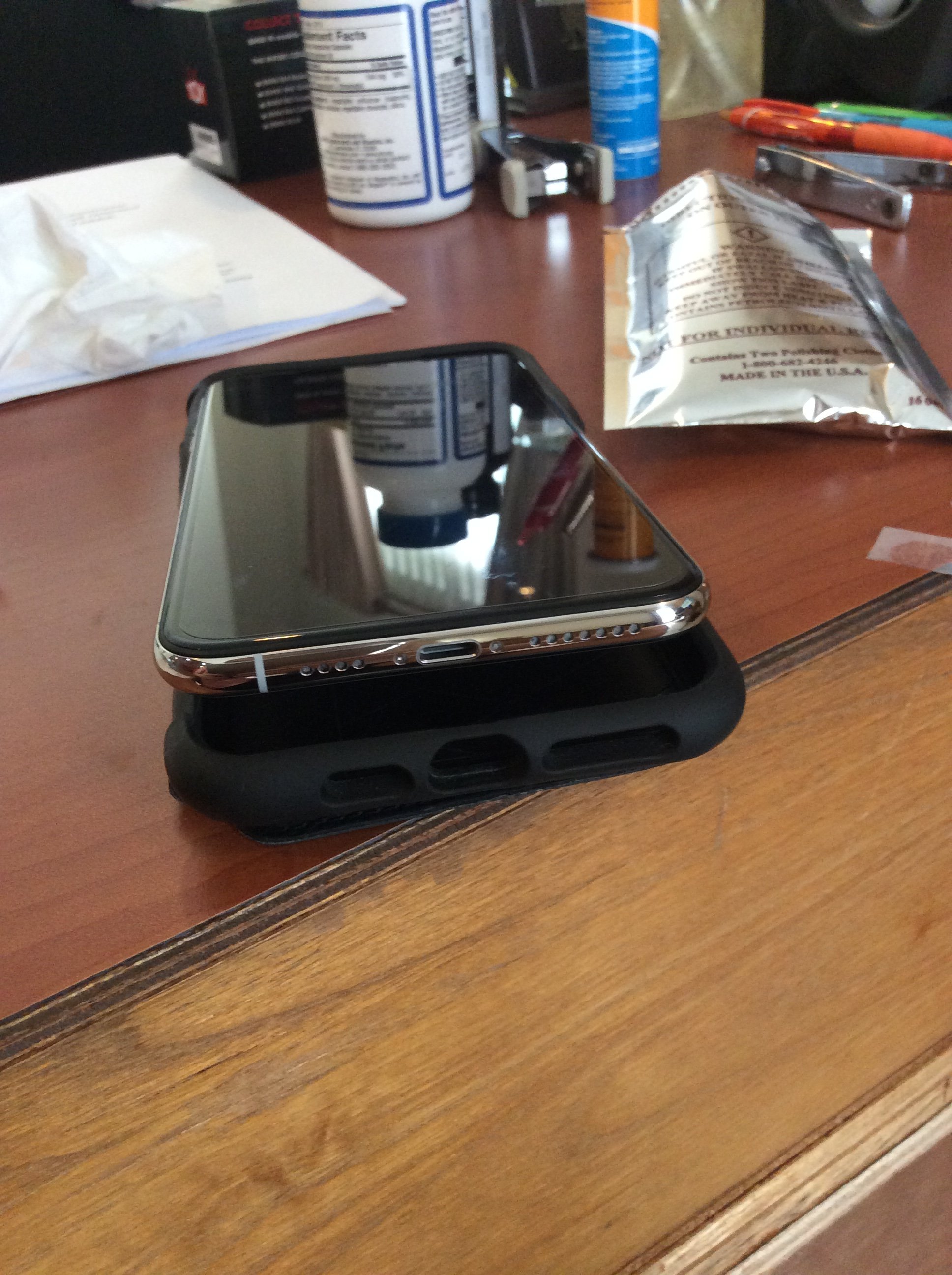

ok just finished using the cape cod cloth and the result is amazing. i only use maybe 20% of my finger pressure for 20-30 seconds. wiping it down in a very gently manner . and all the super fine micro scratches are GONE. now back in a mirror finish like brand new. thanks a lot Newtons !!
ps : the cape cod cloth is VERY OILY. not sure why they make it this way. maybe this is the good thing so they dont leave any abrasions like any other polishing cream ?
