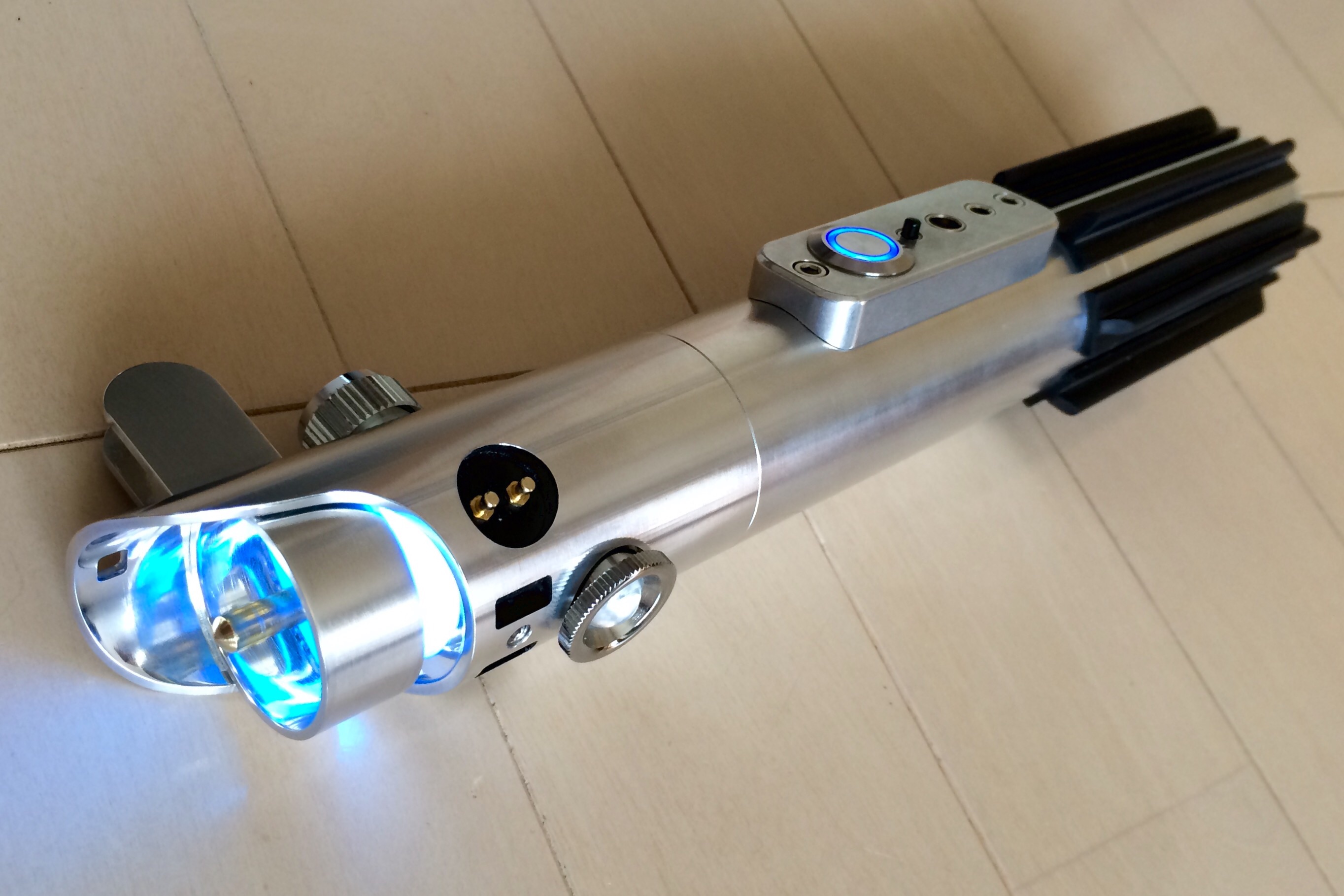

I commissioned a 'local' saber smith to make it for me, having wanted one since I saw a Graflex replica ESB prop when I was eight years old. Only took me thirty years to get one! 🙂
Mine was made using TCSS MHS parts, and was designed to approximate Luke's ANH saber. I ended up making the emitter ring myself, using a hacksawed bit of aluminum pipe I bought on Amazon. It was roughly machined and even more poorly cut (by me) but I ended up sanding it down to a beautiful satin finish on the outside, and a mirror finish on the inside. My point in this thread was that you can, in fact, polish aluminum to a mirror finish. I used various grit sandpaper (starting at 800, then 1000, 2000, 4000 and finally 8000) followed by Mother's Mag and Aluminum Polish.

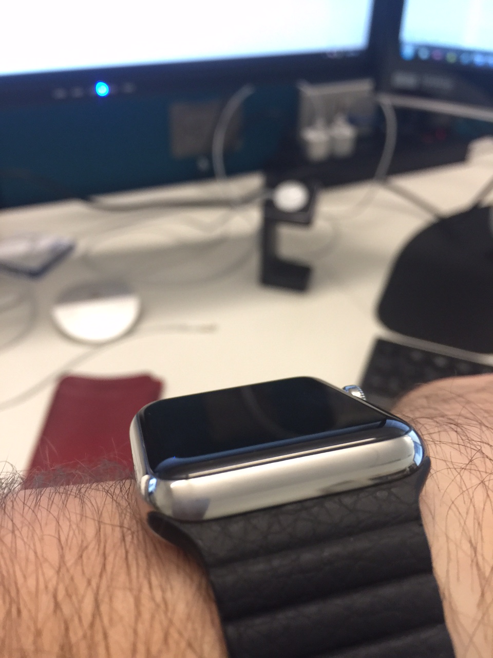

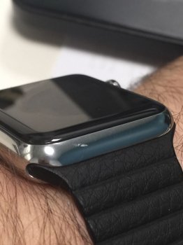

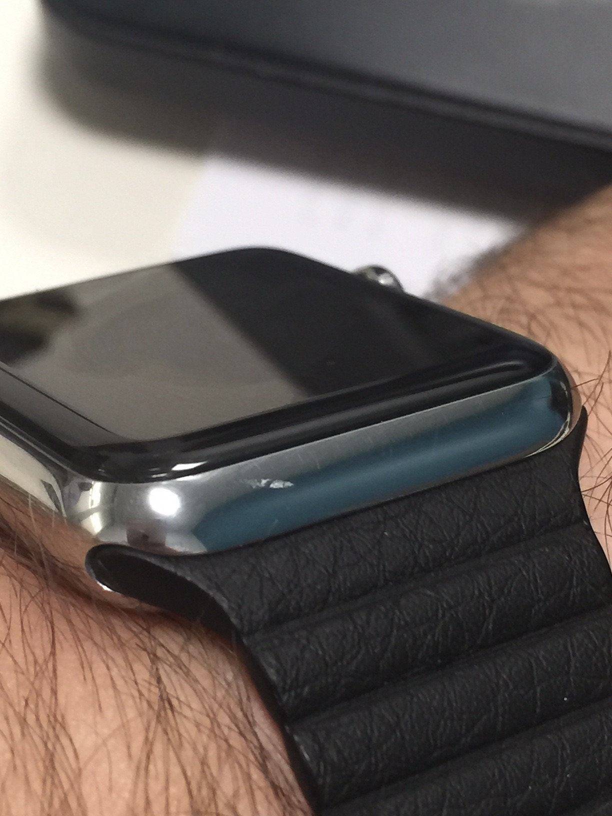

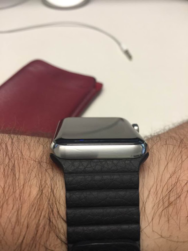

I hit my watch pretty hard yesterday, right on the edge of a tempered glass counter. It not only scratched but actually gouged the case, right below the screen. I guess I got lucky there - if it had been the screen that got hit, it may have chipped or shattered.
Anyway, I masked the screen with a piece of cellophane tape when I got home and then sanded the scratches down with 800, 1500, and finally 2000 grit sandpaper. I then cut a few Q-Tips in half, put a little Mother's Mag and Aluminum Polish on the tips, and fitted them in a battery powered dremel I have, using them to buff the casing out. The end result was pretty damn good! I'm attaching before and after shots.

Thanks! I was nervous, but just went slow and was really careful. I masked the sapphire with some tape so it was somewhat protected; anyway the main thing is that polish. That stuff is awesome!! I have a dollar store dremel - literally, it cost like $1.50 - and if you remove the bit, you can fit a Q-Tip stem in there. It's perfect! A little Mother's on the tip, and just buff the casing out. It looks brand new!
First of all, GREAT JOB. That thing looks PERFECT. I honestly think this particular case deserves a new thread with your easy to follow instructions. I've had my watch for 3 days and have looked like a fool avoiding the inevitable. I have AppleCare, but I was still worried about scratching on everything but you have singlehandedly put my mind at ease.

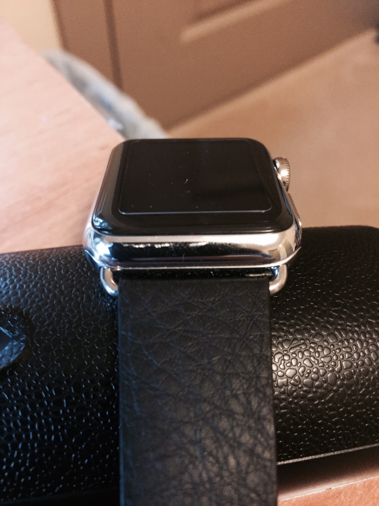

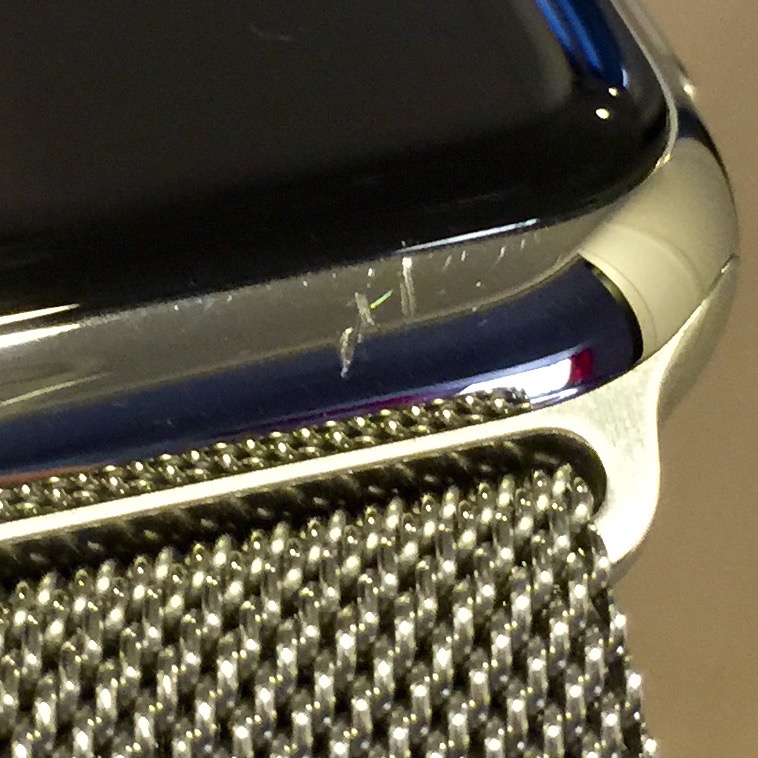

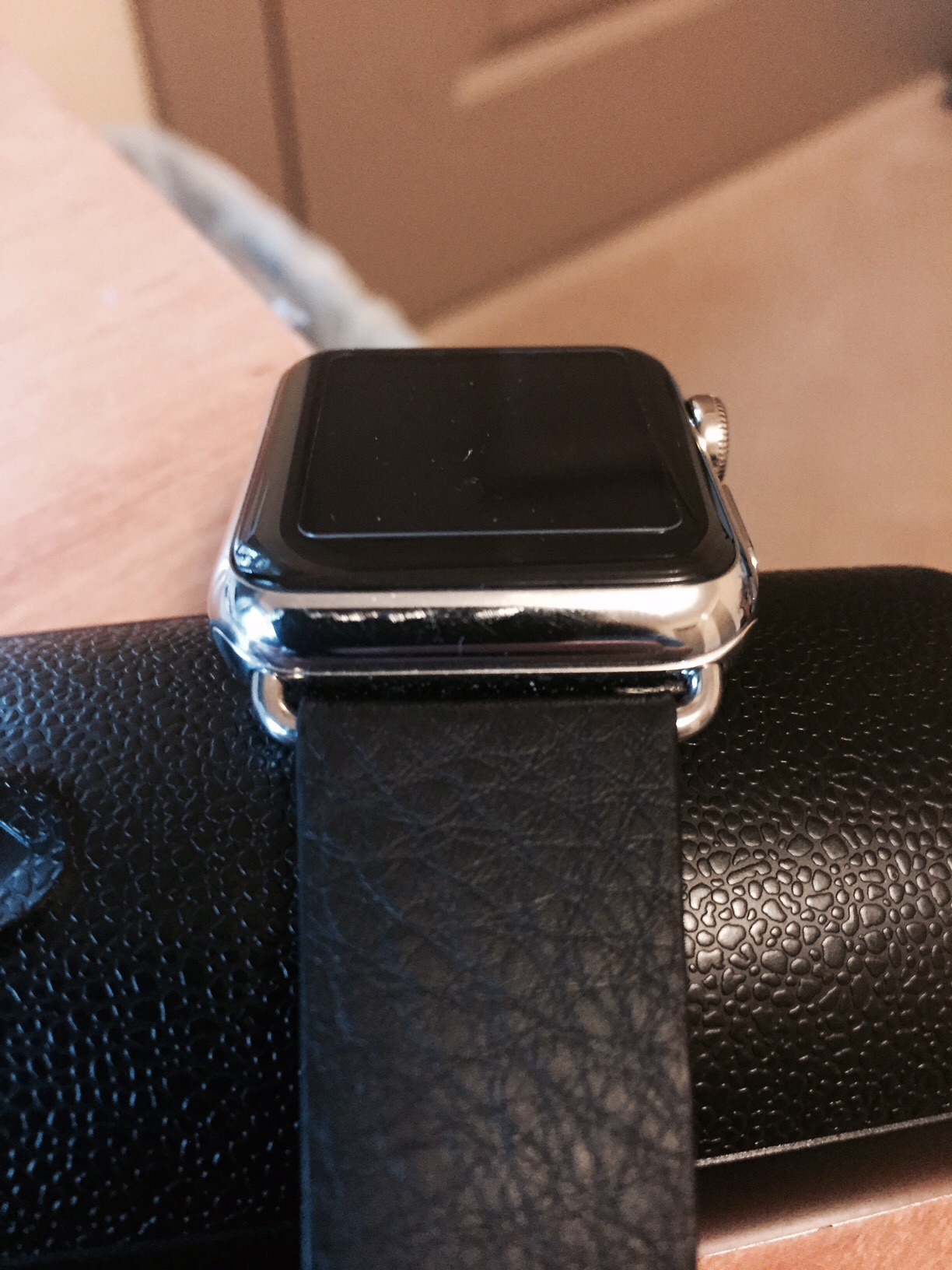

I did something similar - dropped it into my sink taking it off to do dishes. It hit the corner of the sink. I buffed for about 2 hours with Brasso. This is as good as i can get it. After seeing your post, I still have some hope that I might be able to get rid of it completely. Do you think some Brasso on the tip of QTips put into a dremel might buff this away completely?
I don't know about Brasso, but if you follow my method exactly, your watch will look brand new.
Buy sandpaper in various grits - I'd start with 800, then do 1000 or 1500, and finally 2000. You really only need a tiny piece of each, but starting with the 800, sand that spot/area fairly aggressively and then move on to the next grit. I did mine wet, too - literally a single drop of water is enough. Finally, after you've finished sanding with the 2000 grit, touch the tip of a Q-Tip into the tin of Mother's, and polish it manually or by fitting the Q-Tip into a dremel. The Q-Tip will almost immediately turn black, as the Mother's does its thing. When it does, get a fresh Q-Tip and repeat. I went though about five (each cut in half, so 10 tips) but the results were pretty much the same after the first few.
Once you get the hang of it, it's actually a pretty quick procedure. I could probably do it again, start to finish (including prep time) in less than 10 minutes. 🙂

Awesome - Going to try this tonight. Today I'm noticing the Brasso seems to have taken some of the glean off of the watch. Hopefully the mothers will bring it back.

I actually ran out and got the materials on my lunch break. Is the idea to sand it until the scratches are no longer there and then polish? How much sanding should I do? How do I know when I've done enough of each grit?
Yes, the idea is to sand the scratches away, for the most part, or at least to make the difference in height (?) between the edge of the scratch and its deepest point less pronounced. Start with the 1500 or even the 2000, if you want to test it out. My scratch was really quite deep, so I started with a coarser grit and actually I ended up going through the whole process twice, just to get it perfect. Make sure to sand it with deliberate, careful motions, but that Mother's Mag and Aluminum polish will get rid of any scratches the sandpaper leaves. 🙂
Man, I don't know what to say other than - THANK YOU SO MUCH!

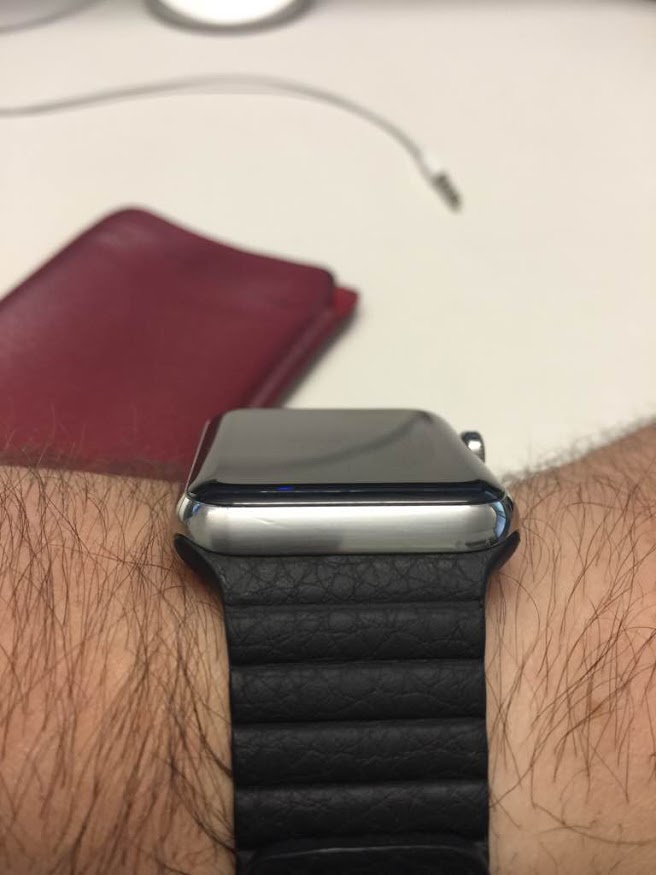

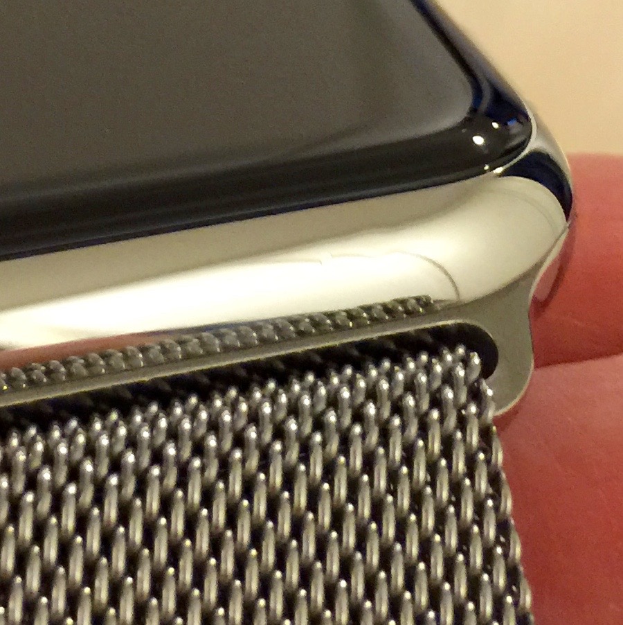

Followed your technique using 800, then 1500, then 2000 - then used Mag and Alum Polish - and check it out. You would never know anything happened to it! I'm very very very relieved to know this works and can work in the future (although I hope I won't need it again).
Dude, it looks great! Good job!!! 😀
I'm glad it worked as well for you as it did for me. Like you said, it's relieving to know that you can fix this stuff if it ever happens again.

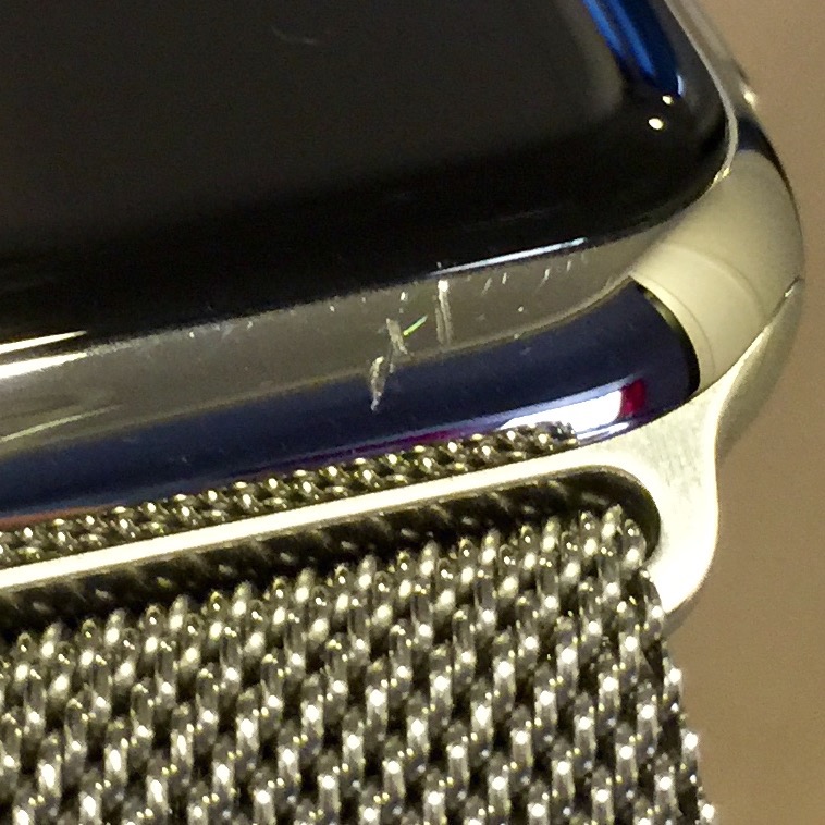

I have 3 minor smudge-like scratches [but definitely not smudges] on my link bracelet and I've only worn it twice. Is this something I should try to get a replacement over or is it par for the course?

If you've ever had any watch with a band like this, it is just going to keep getting them, and over time it will look "worn" and have character. So returning it will do no good and probably make you look crazy, IMO.

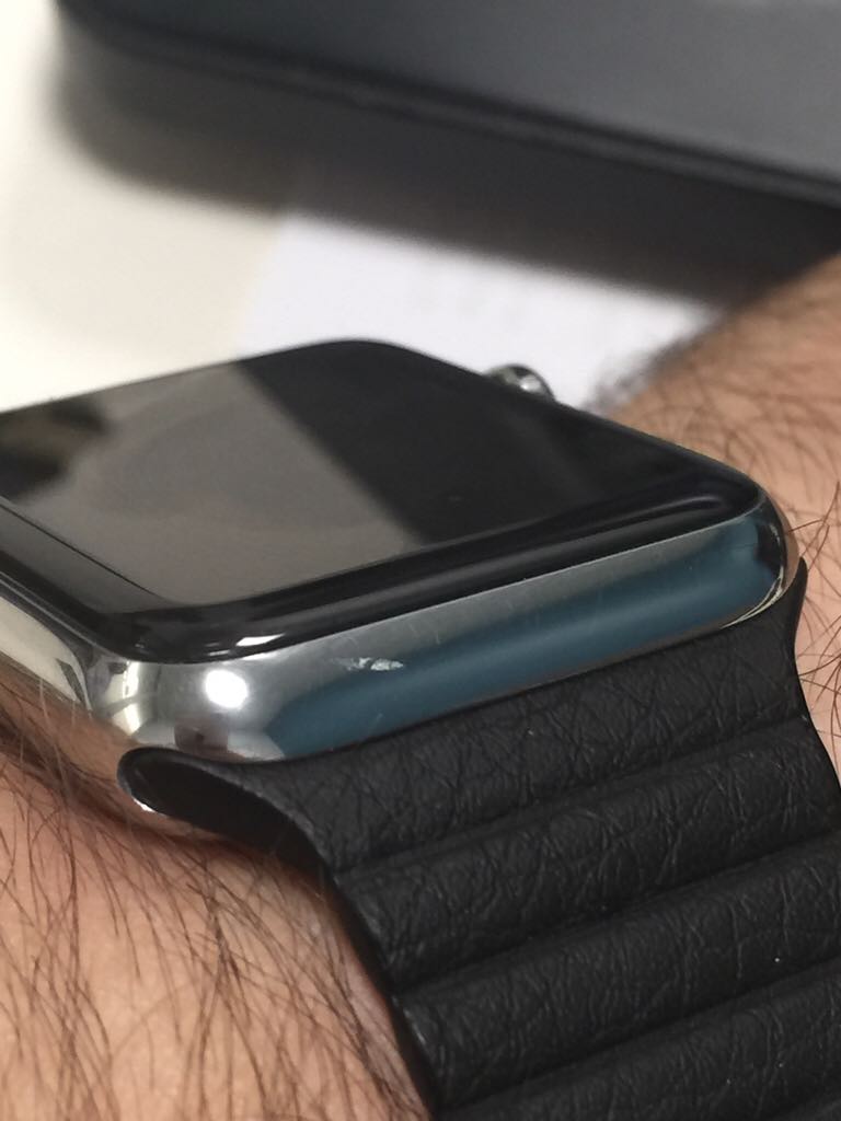

My first war wound. Not sure how it happened. Especially on that part of the case.
