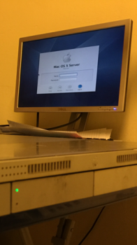

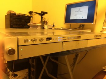

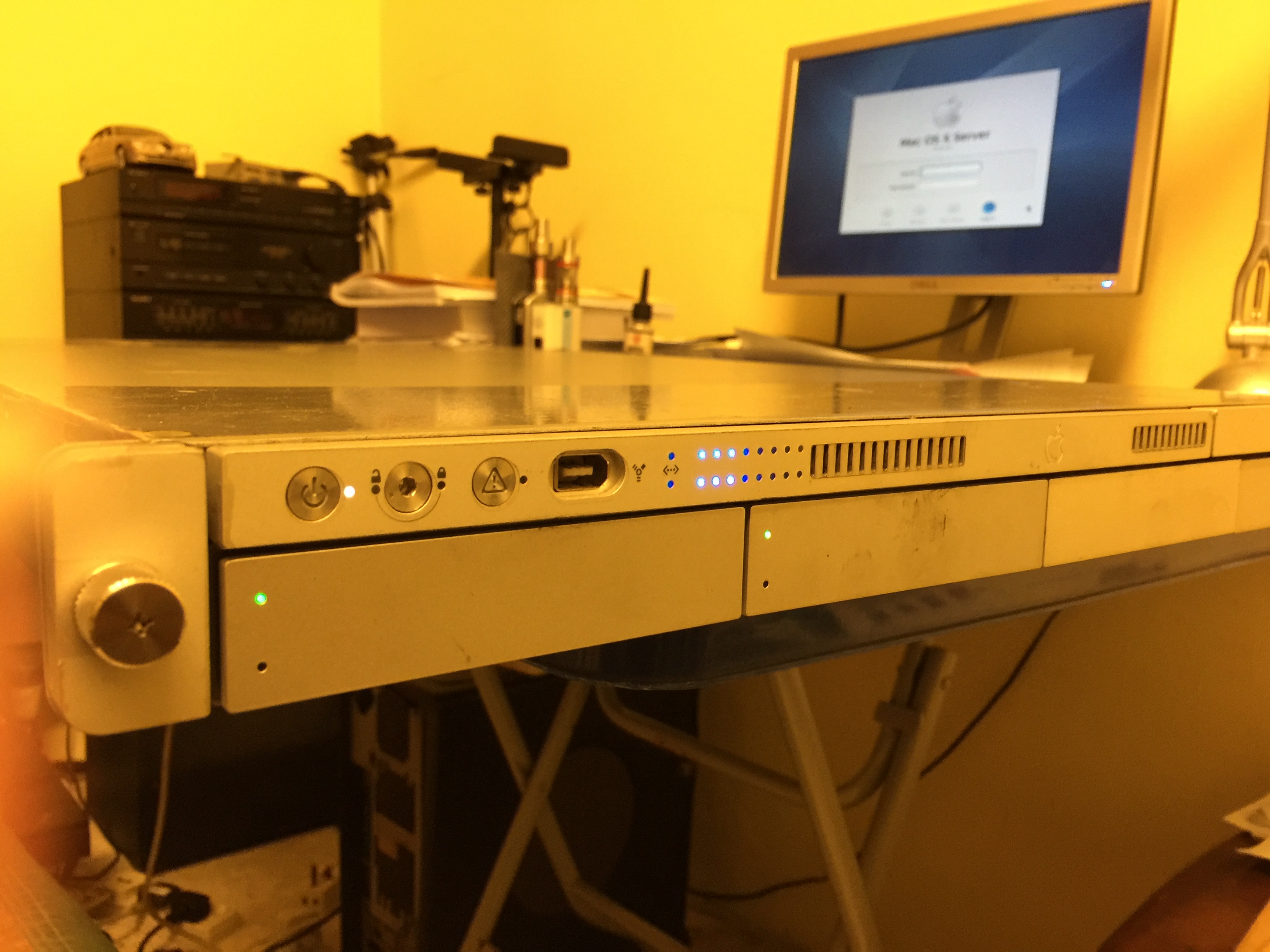

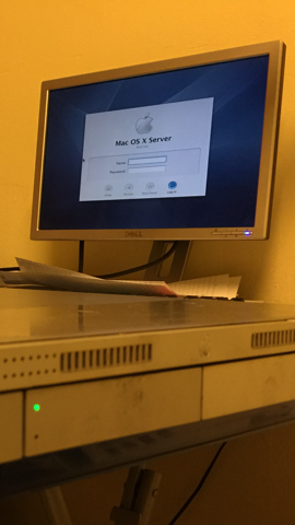

US 50.00! A bit expensive for its spec i guess, but after four deals for various machines failed consequently.... I Was not letting this go ... 1ghz, 265mhz ram, 500gb hdd. Its the first model- not the dual.
Have i lost my head ? What was i thinking when i went to get this!
Seriously, this the first xserve ive seen !
I ddnt expect it to be so big....
However, the guy who sold it to me does not have the pw nor any install discs, i guess he is making a quick buck of the items his office is ridding of...
I am guessing that its os x server 10.4 ( if there is a tiger version) if it is, can i use the normal 10.4 retail disc to reset its pw? I tried but it stopped at the grey apple logo... Or i need the server os x to reset the pw.
Saw this , but dont know if its the retail discs or the server version, which iis required. https://discussions.apple.com/thread/2116105?start=0&tstart=0
Any guide will be much appreciated.
Btw, this thing can compete with a vaccum cleaner!

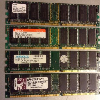

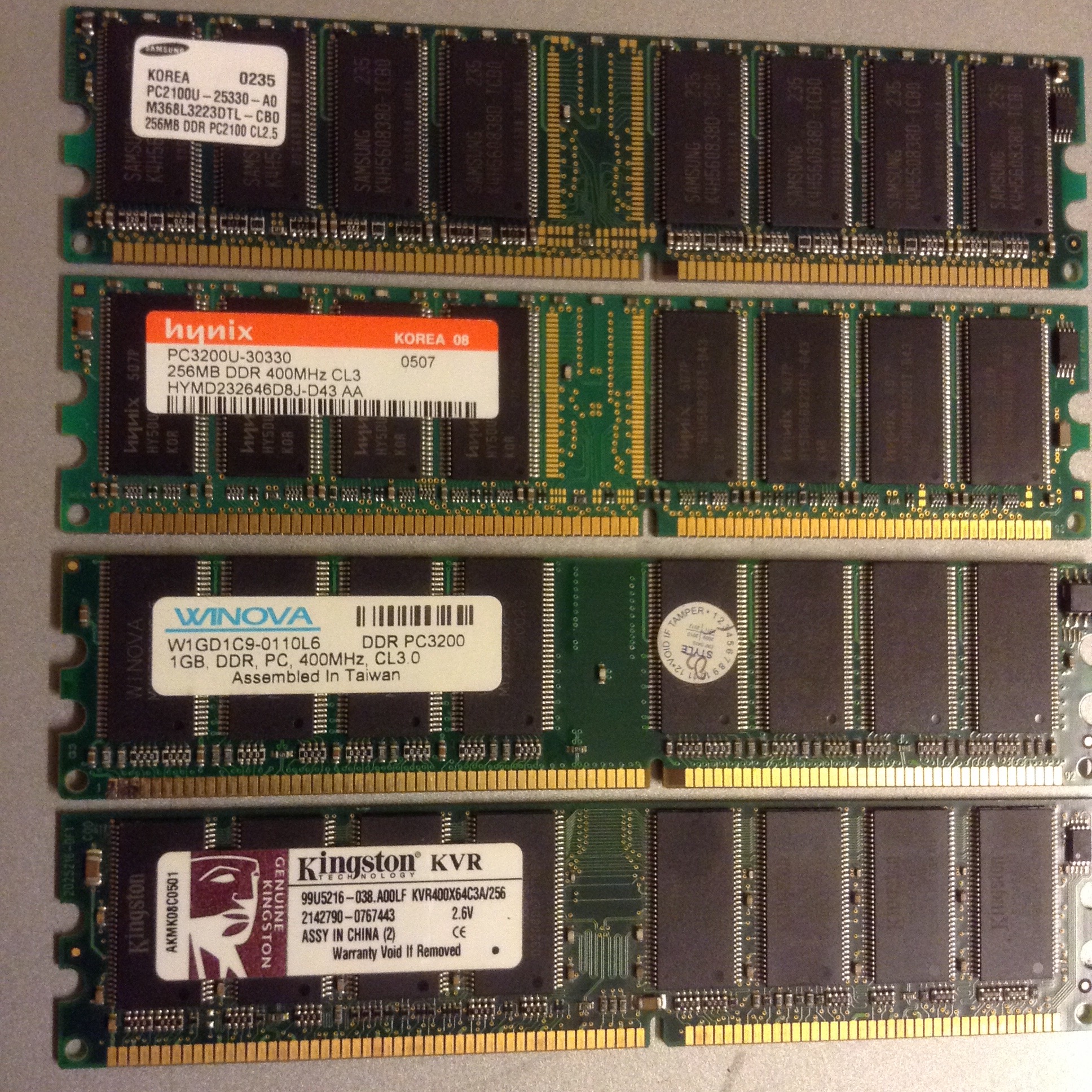

I dug up som rams which i had, will these work on the Xserve ?
Yes they will since:
- the 2 middle ones are PC3200 which is compatible with motherboards requiring PC2100 (as the original stick)
- from its markings, the bottom one seems to be 400 MHz = so PC3200 too
For reference:
PC2100 = 266 MHz, 2.1 GB/s throughput
PC2700 = 333 MHz, 2.7 GB/s throughput
PC3200 = 400 MHz, 3.3 GB/s throughput
PC2100 sticks work only with PC2100 motherboards
PC2700 sticks work with PC2100 and PC2700 motherboards
PC3200 sticks work with PC2100, PC2700 and PC3200 motherboards
