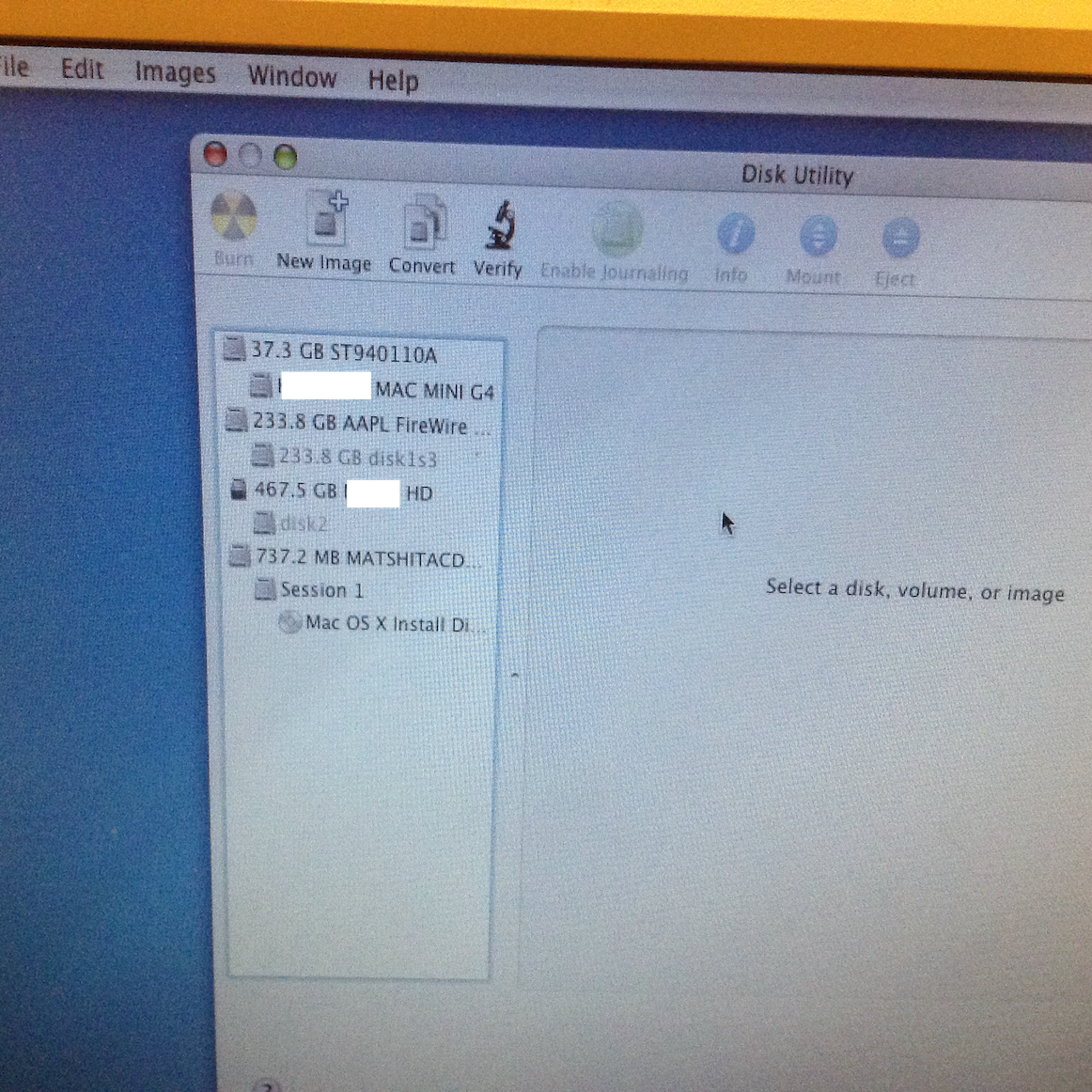

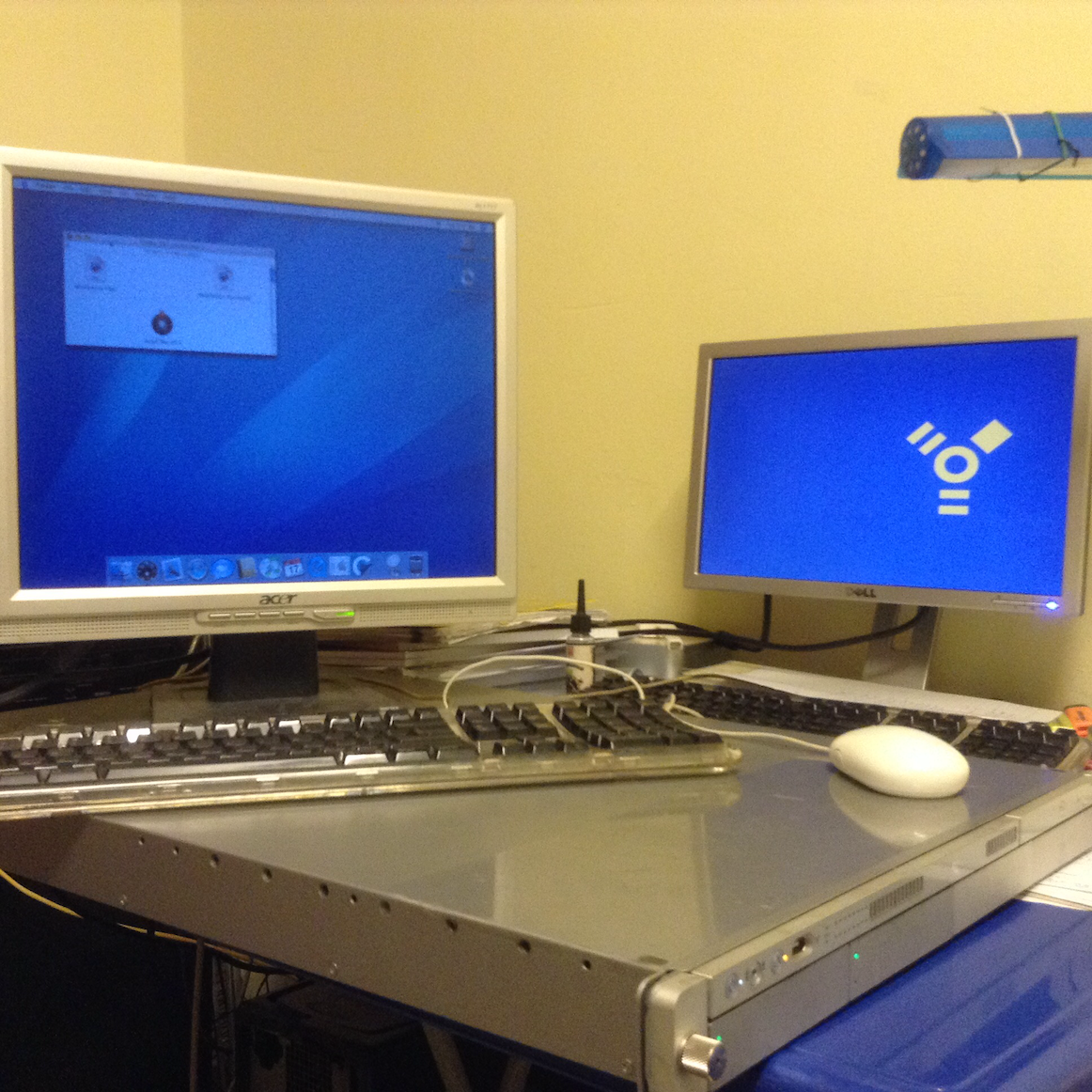

Anyways, i did try to install the client version of 10.4, but it won't install. Tried Target mode as well, but the Xserve's hdd does not appear in the other Mac, which i had mentioned above.
Tried to reset pw via the other Mac with the install discs but the option to reset Xserves pw did no appear. the hdds were visible in the disk utility though.
Just a while ago i meddled with single user mode, tried to create a new user account and now i am stuck with the serials !
Removed the hdd from the xserve and thought of installing a fresh OS via another Mac, the screws on the drawers are so tight and won't budge !

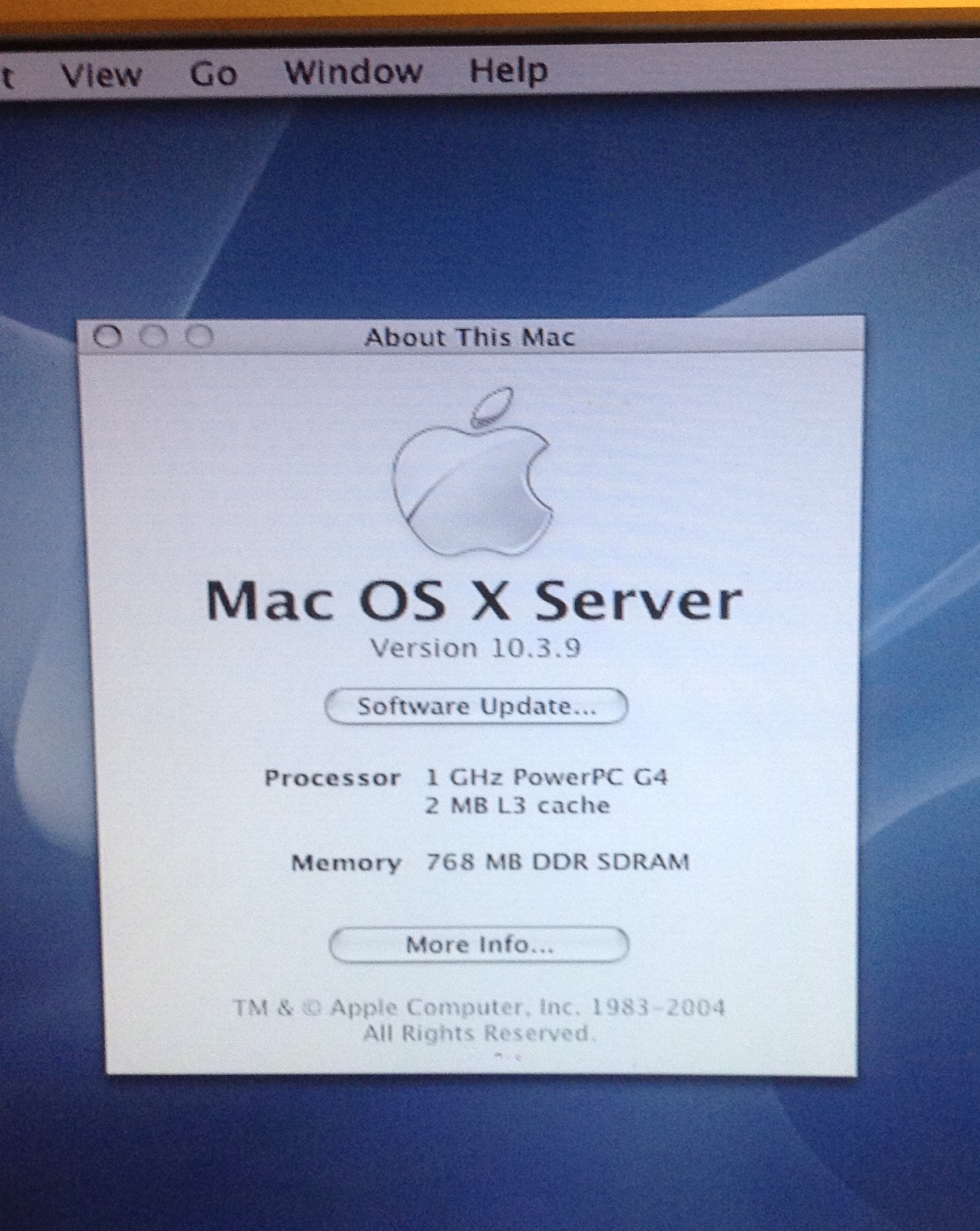

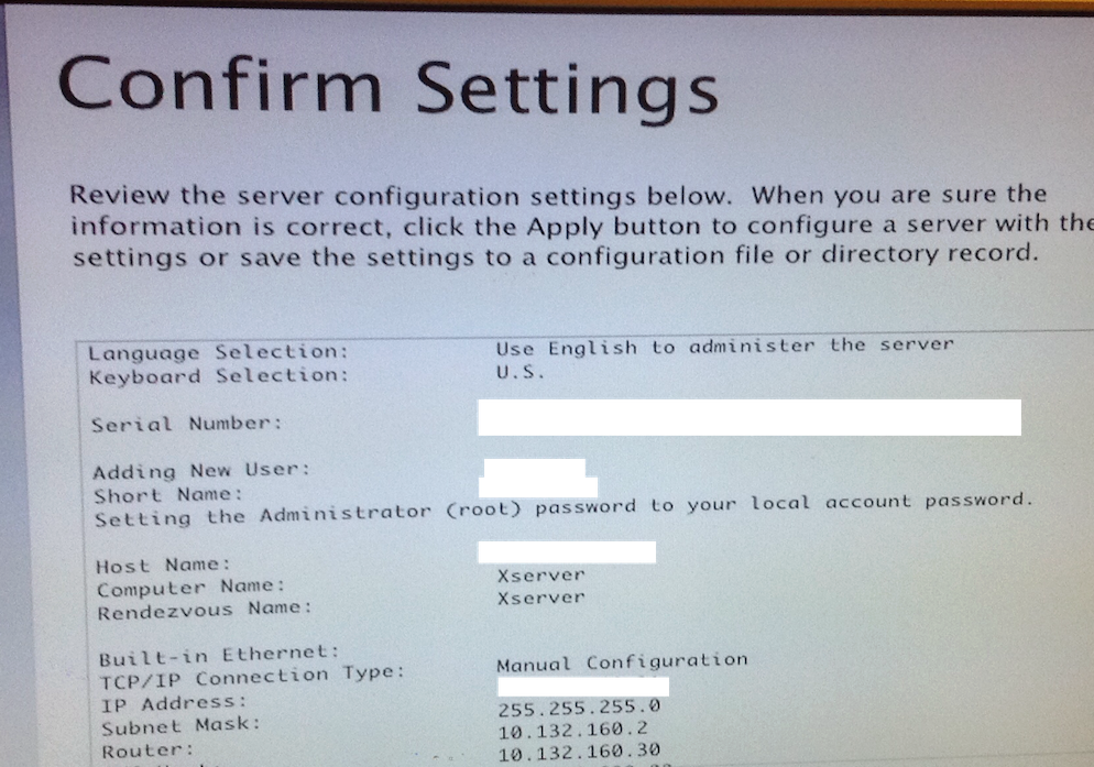

It won't give in easily ! managed to get in, did all the settings, used my normal pw, restarted....and the pw does not work !!! what the heck !
it is running in 10.3
Try using the user Localadministrator and your password
nah doesn't work.
re-tried the whole process, set the pw as 1234. changed nothing in the settings, all default, still can't log in. during the settings, the username was greyed out though, the old username was there, i had no option to change it.

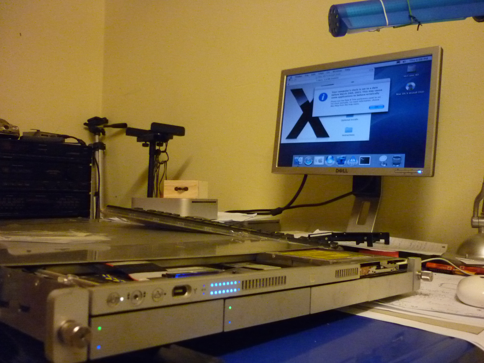

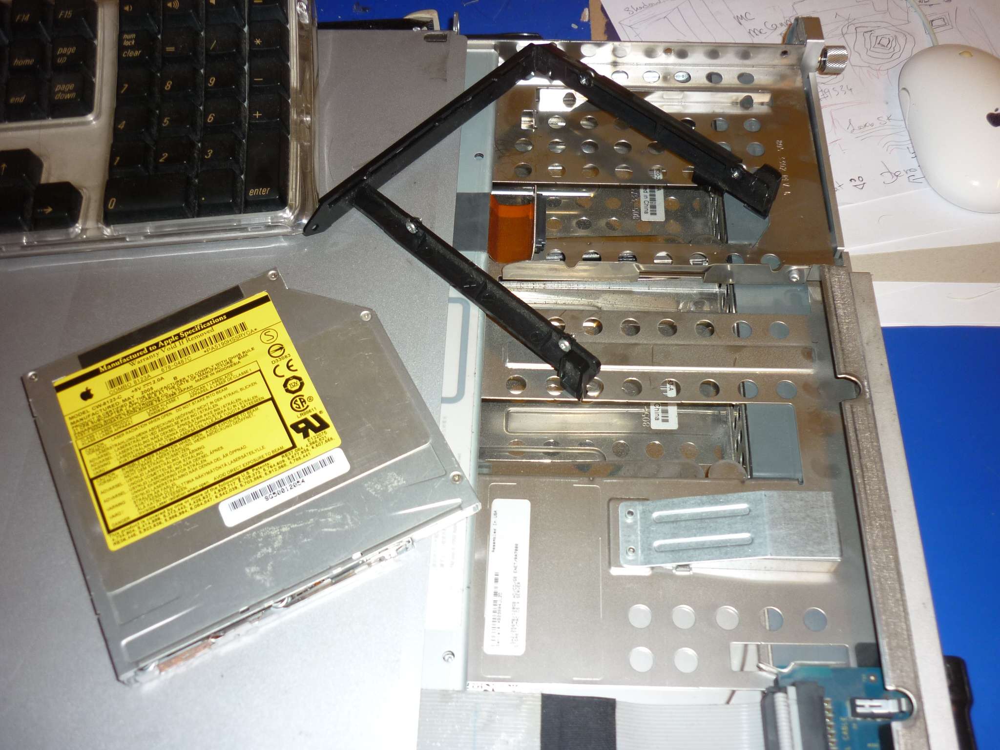

....playtime, @Surrat 's transplant act gave me a push to what i was contemplating to do, yeah steal the superdrive from my iMac G5 17" and plant it in the Xserve, though could have attempted other options, i went for this. This iMac was already cannibalised!
Just to install OS, then i'd replace the optical drive, as it can't stay in the Xserve since its a slot load.
Prior to this act, went around looking to buy a DL Disc, suprisingly the couple of outlets near my home had ran out of it....what a bummer. Well that was not gonna stop me, i was gonna go ahead with the transplant and get the disc tomorrow.
And yeah, the superdrive was a beauty, i tried slotting a 10.5 retail disc and it picked it up !
Then i thought about the pw reset option since the installer began to run... attempted it, whooola it did proceed, had a number of user accounts, did what i was supposed to
IT WORKED....woooohoooo. The pain in the ass had paid off finally!
It was worth, the gamble and sweat, it was .... now its whether the OS X Server 10.5 installs fine or .....

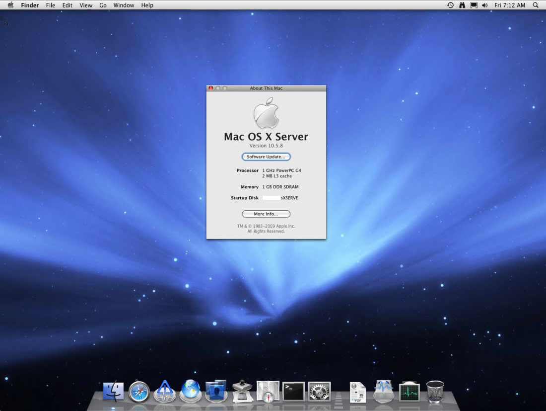

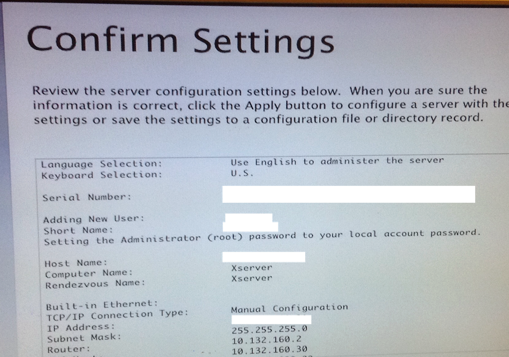

phew.... two failed DL discs, failed HDD in a Mac Mini g4 which was to be used as the host for TD, incompatible firewire for the intel mini..bla bla.... this is has been the most difficult Mac to install an OS !
Finally it runs 10.5.8 Server. I like the default wall!

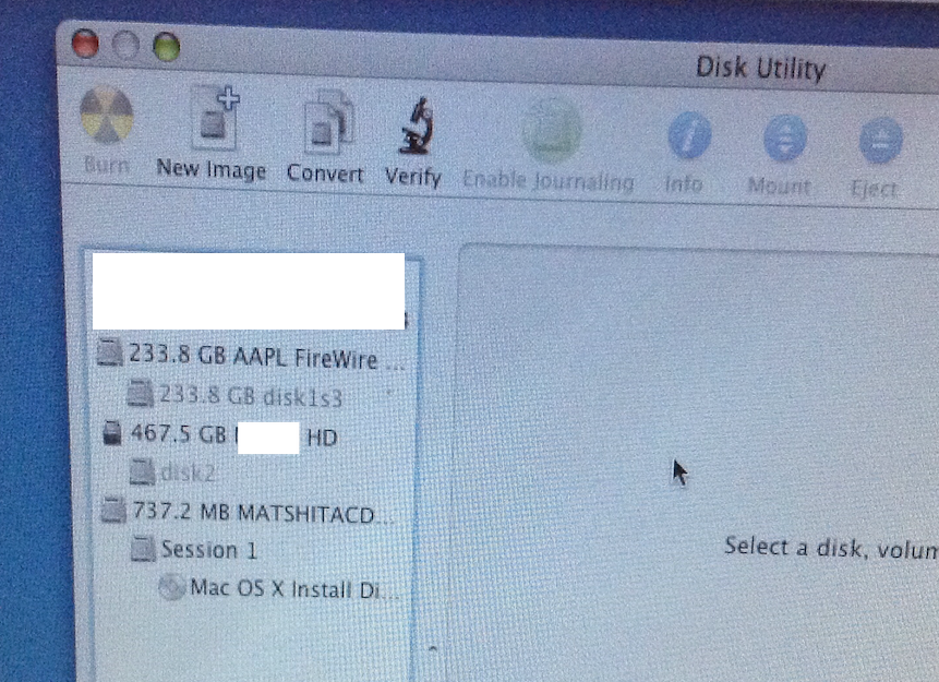

I am now wanting to set RAID and having no experience in setting one, i seek some guidance from you guys.. for starters...
* since i am not using the Xserve Raid (the external raid box), can i assume that setting up raid in this Xserve is just the same as setting up Raid in any other Mac ?
* do i have to begin the installer and then jump to the disk utility to set the Raid or can i just begin while i am logged in the OS X Server ?
* the picture below shows the HDDs in the previous install. I notice that though there are
2 X 250GBs in the Xserve, there is a combined reading of 467++GB, does this mean that the previous install was in RAID 0 ?
* does this link sound like a good tutorial for me to install RAID 1 ?
http://macs.about.com/od/usingyourmac/ss/raidmirror.htm#step2
This would be my first attempt at RAID, so any guide, do and dont's and comments will be much appreciated. Thank you guys!

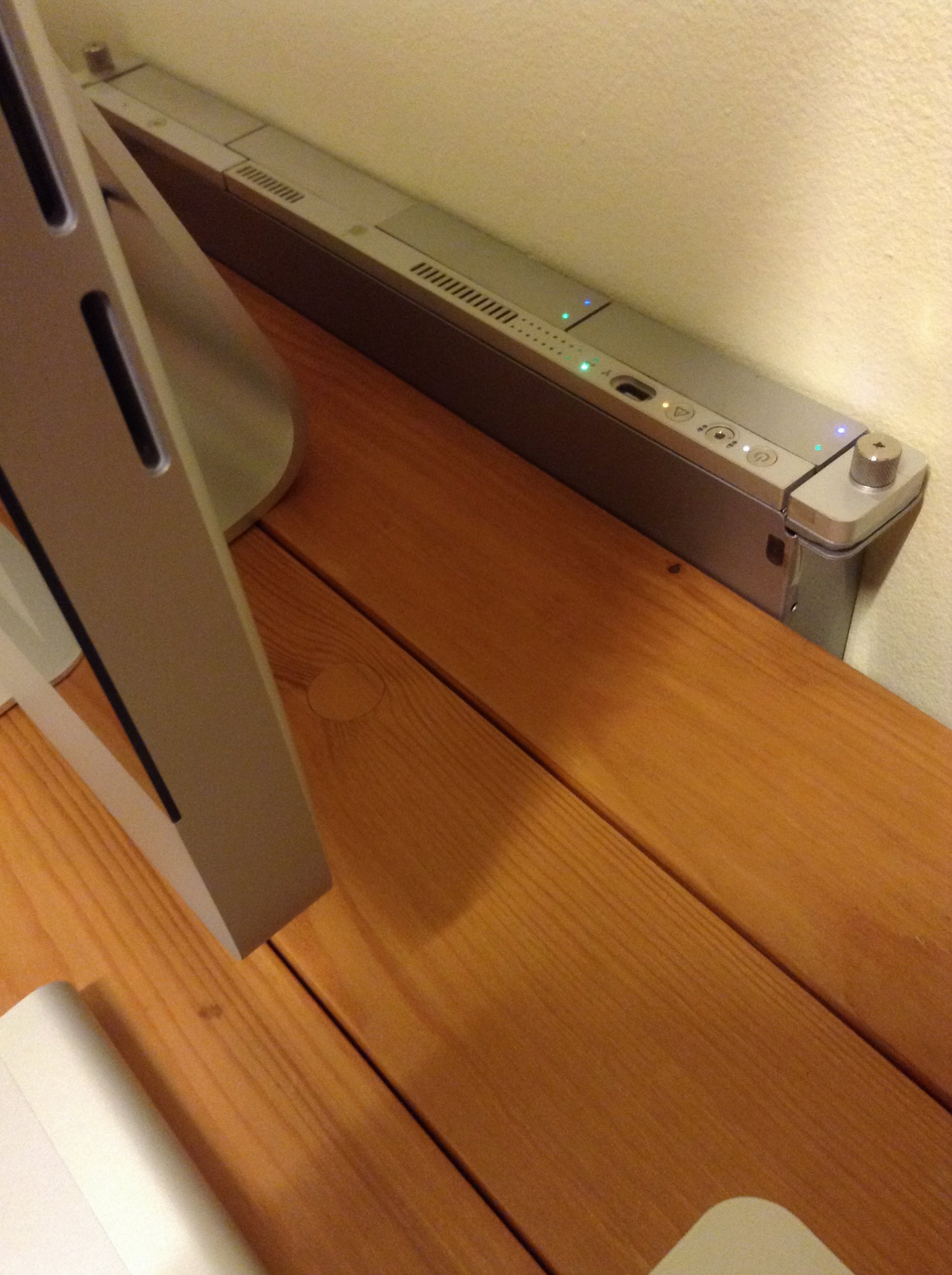

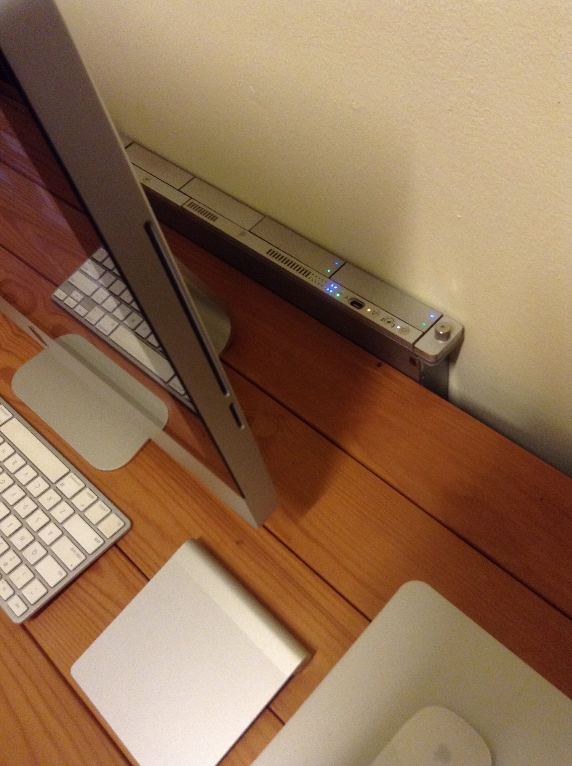

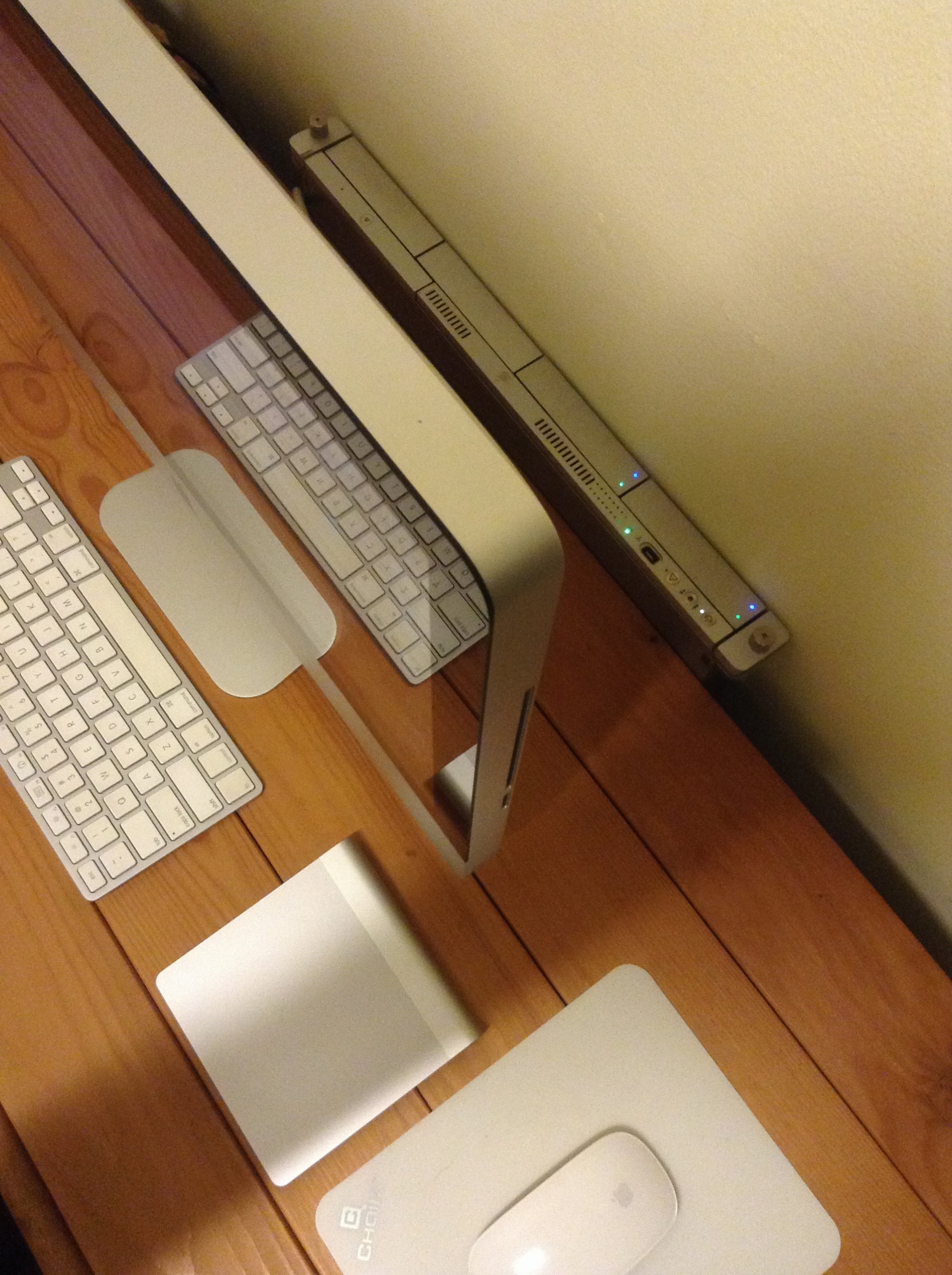

Settled this PPC some time ago, so its to learn how to run this OSX from now on. Placed it, though have a bit more of tweaking to do.

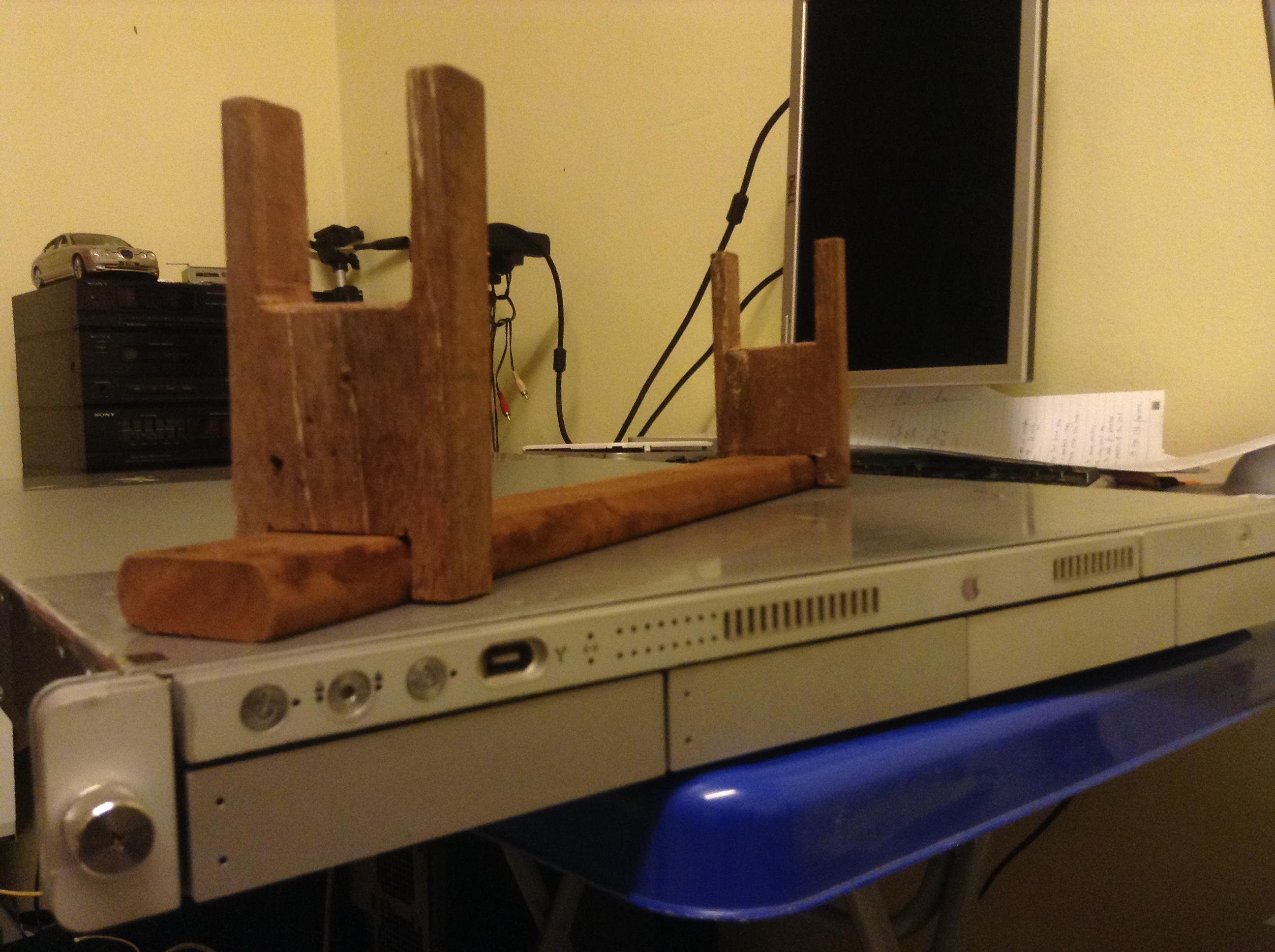

Don't have enough place to lay it horizontally, so made this simple stand to give it a leg. Didn't bother to give a good finish, as it will be hidden beneath.
placed it right behind my iMac, as it will be the primary mac which will feed the Xserve.
Need to do a dovetail there, to exactly fit it in. Sadly the table is not slightly higher, so that it totally submerges the Xserve.
