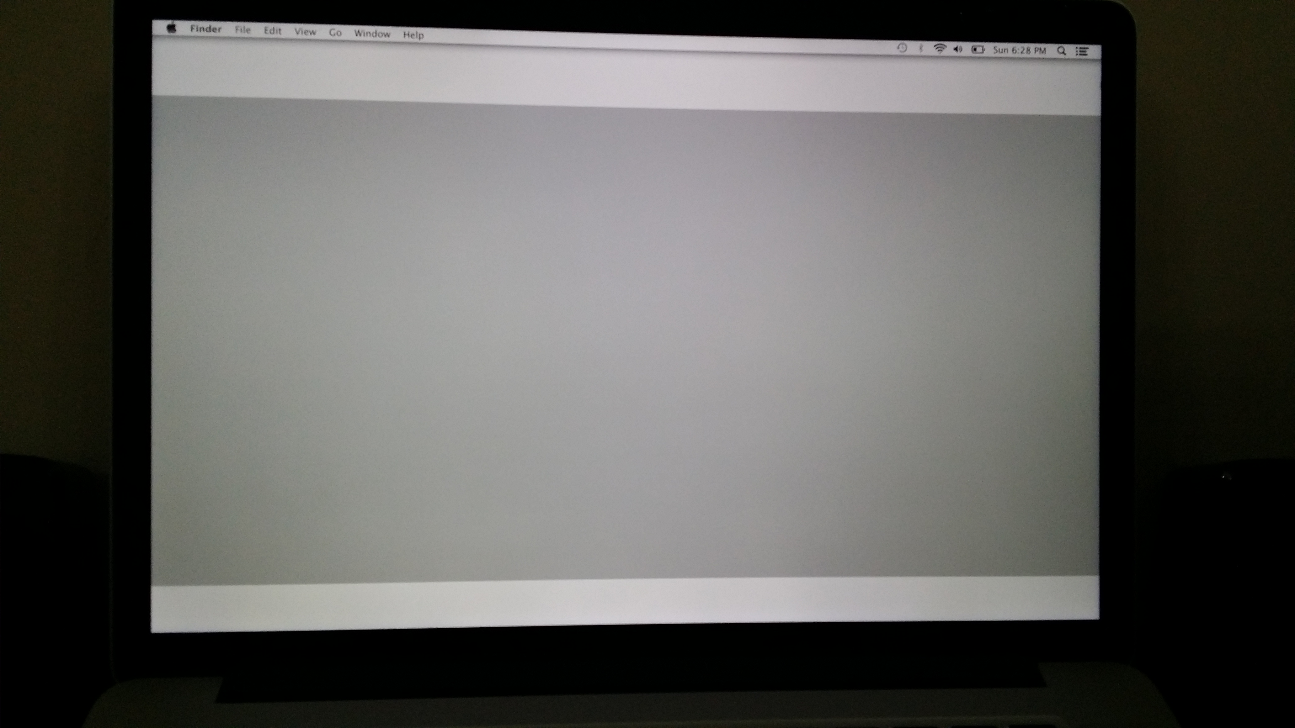

hi
Guys is thus "yellow tinted"?

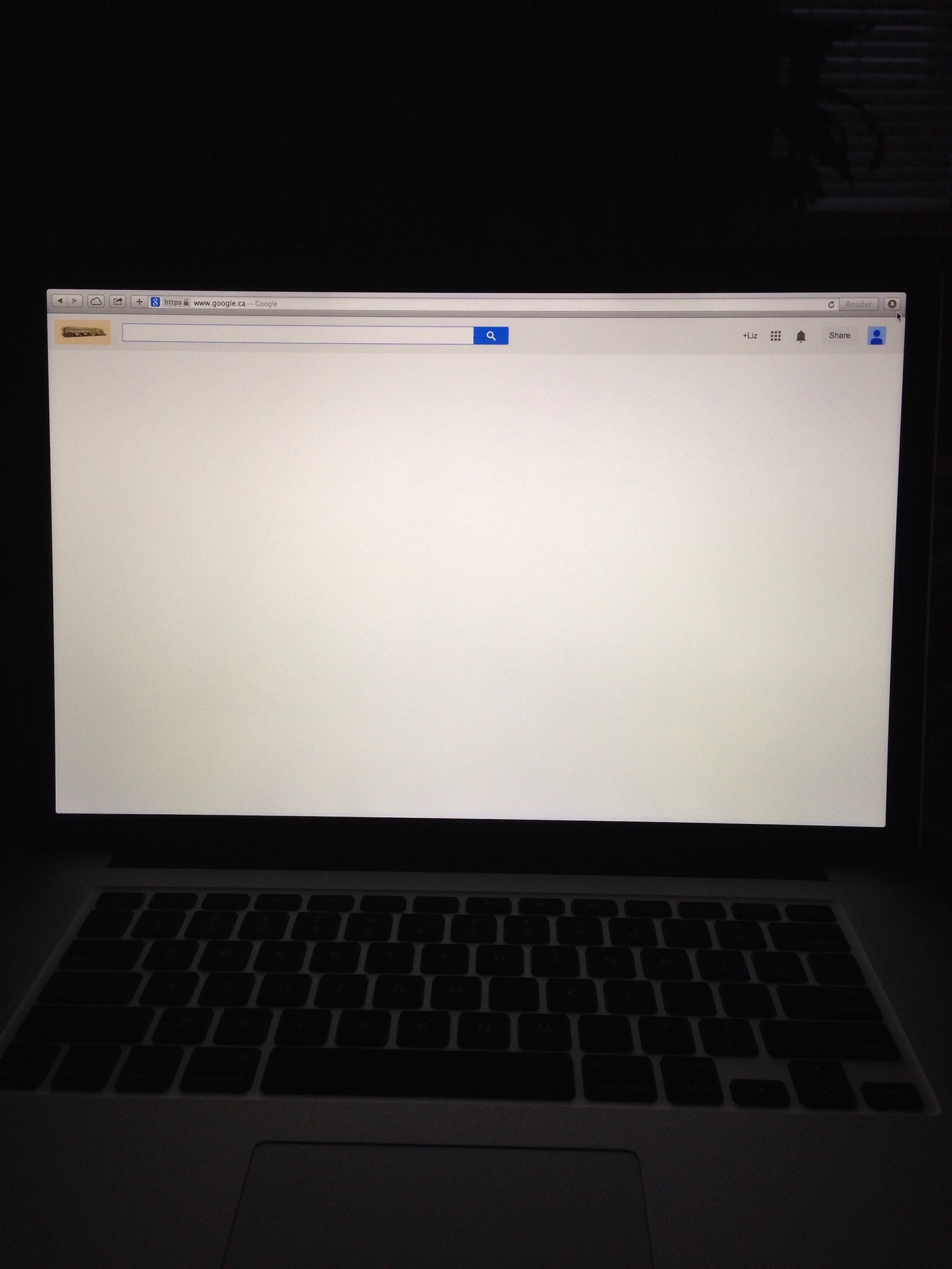

A bit of a dilemma here. I got my mbp a few days ago and have been using it casually. With light browsing the display seems great and nothing seems wrong with it. I loaded up a blank white page and it seemed pretty uniform to me there as well.
However when I tried to do the checkerboard test to check for image retention, I noticed that the white checkerboards were distinctly whiter than the ones near the bottom corners. I wouldn't notice if I wasn't looking very closely but there was definitely a difference. The disparity diminishes once I turn the brightness up and in regular usage I see no problems but only on the checkerboard I can see that it is slightly less white.
So is there a way I can be sure my screen is yellow and not just my eyes playing tricks? And is it worth it to return the laptop and ask for a replacement for this level of yellow?
edit: Here is a picture comparing it to my old computer. The picture makes it look way more pronounced but there you go.
Well, your rMBP screen is definitely "dirty" yellow in colour. On the other hand, I think the display on your old computer is a bit too cool in colour temperature, meaning it's slightly too blueish.
But really, the white point is way off the mark in your new computer. White should look white, not yellow.
Do you think it's worth returning?
That sir, depends entirely on you. I wouldn't be happy with a screen like that on a high end notebook. But if you return it, you may have to do so more than once to get a better screen than that one. I don't know for sure though... It's just that so many people have gone through multiple replacements, including myself, that it seems like most of the screens are poor quality.
