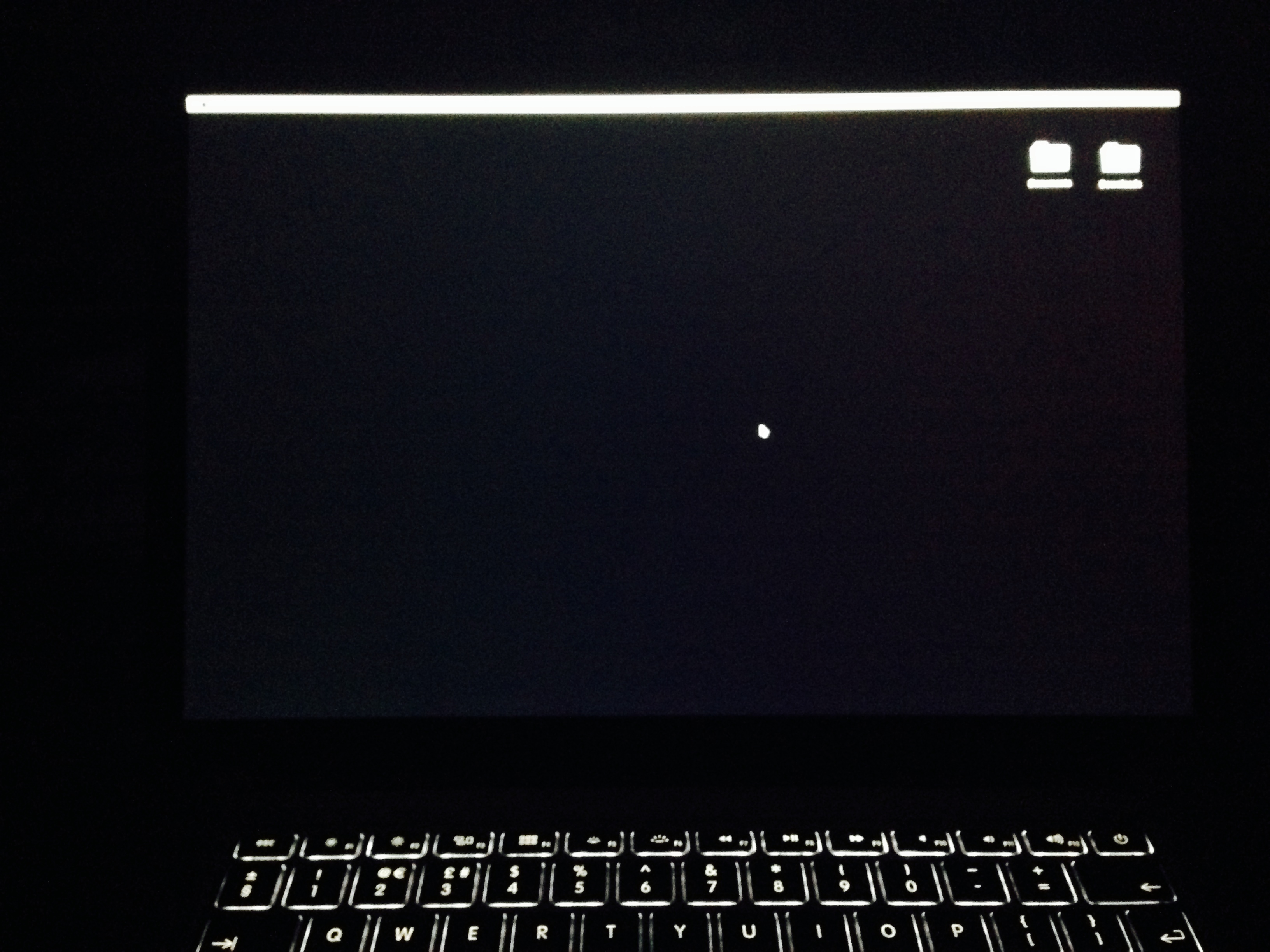

It's not a perfect screen, but I think it's acceptable. The first one I've seen here.
Having seen some of the other sample pictures it's nowhere near as bad and it could perhaps be classed as being acceptable. Time will tell though.
Whites / non shadows and consistency looks good. Some Problems are more apparent with a black screen though. Can you post pics?
Yep, check this picture. Same as before; screen at full brightness and source is an iPhone 5. From my own view, it clearly is no Pioneer Kuro or Panasonic VT/ZT but it's not wholly bad for a laptop screen again I feel its within the acceptable limits of the quality expected.
