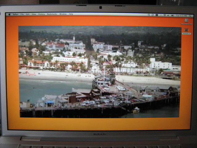

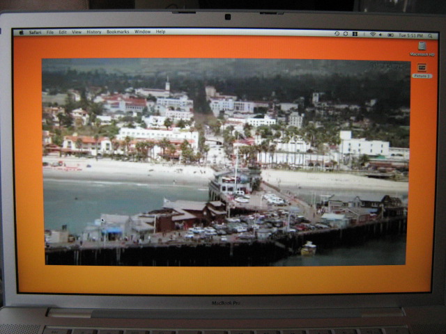

Its called viewing angles. 2/3 pics look completely fine. The last is a angle issue
This is correct, you won't find a screen that doesn't do what yours does to some degree. Some might be slightly better, most will be as good or worse. Your screen is fine.
Color shift does occur when the viewing angle changes but the posts here saying it's viewing angle are all wrong. If you lean the screen back the viewing angle of the top should shift more than the angle on the bottom if you are more in line with the bottom of the screen which is what picture 3 shows.
In this case you are seeing the truer color of the bottom. If your eyes are in line with the top of the screen, the bottom of the screen is color shifted lighter so the yellow tint actually appears to be less.
This screen has a yellow color shift at the bottom of the screen. You can debate whether it's acceptable or not, but you can't debate this it's not there. This is not color shift.
I've compared several 15" and three 17" MBP LED screens. All the 15" screens had it to some degree and none of the 17" LED screens had it. It's a screen issue. Getting a different 15" or sending it in for repair might make it better or worse, but I can't understand this blind denial of an obvious issue.
Amen.

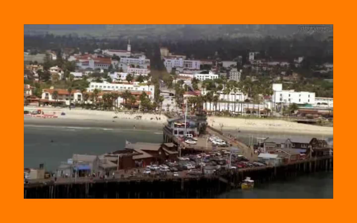

A test im using..
A test picture I use, the upper part and the lower part of the orange field will never be the same color if the screen has yellowing or uneven backlight. And you can see the gradient on the sides.
Where did you compare these screens? If it's at the Apple store those comparisons are meaningless because the displays aren't accurate there.
I have calibrated 3 of the 17" LED screens and about 6 of the non-LED screens and they all do this to some degree. Sure, every panel is different and if it bugs you it bugs you, but there's not much that can be done about it besides play the screen lottery and end up back where you started.
I've compared 3 15" and one 17" (new) at home and calibrated them with a hardware sensor. The others I have seen in stores.
I agree I have not seen any yellowing on the 17" screens. The new 17" LED seems to be a much higher quality than the 15", not only is there no yellowing with 17" but the viewing angles seem to show much less color shift than the 15".
The 15" LED is another story though. Although I like the brightness and the instant full on, every single one I've seen has yellowing issues including three I've evaluated in varying light conditions and have calibrated at home. Comparing a known 15" screen to one in two different Apple stores I see the same issues there. And the yellow isn't that the whole screen is yellow, it's a band at the bottom taking up usually about 1/3 of the screen height.
Again, I'm not talking about the 17" LED, but the 15" LED. Aside from size and resolution there seem to be significant differences between these screens to me.
And if you were a genius and told me to get medication, I'd tell you something too! Come on, WHY would you accept that after paying all that money? Doesn't it bother you that Apple is counting on customers not caring because it's too much hassle, that Apple is cost-cutting but not either passing on some of the savings to you with lower prices, OR making sure that you get the best quality for your money? Instead, they charge a helluva lot AND give you mediocre quality.
As a customer, I find it really insulting. And I'm surprised that anybody would suggest that somehow the customer is crazy or OCD for demanding better.
That post was a bit tongue in cheek. I do agree with you for the most part, but you have to realize even though the machine is called a "pro" I bet that the majority of the owners don't really make a living off of their MBP. Those of us who have gathered here are a specific bunch. I'll be the first to admit that I DO need something for my OCD. But you're right, we shouldn't expect any less from a company like Apple who charges the premium for it's self touted quality.
