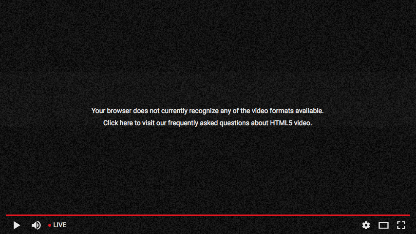

Nothing but the ancient Flash seems to work for YouTube livestreams. This is what I get using the HTML5 player in the latest TenFourFox 45 beta:
And this is what I get using PPC Media Center or Quicktime Enabler:
[doublepost=1470963129][/doublepost]Has anyone had success with CorePlayer? Have not tried it yet.
I don't know whether HTML5 worked for live streams previously as I didn't try it.
