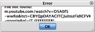

Strange..I was doing this last summer, then Youtube changed something so it wouldn't work. Just tried again with your script and again nothing works - Quicktime fails to load the clip as does Coreplayer.
Can you cite an example that works for you so I can try it?

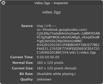

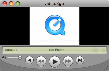

No I get exactly the same results, Quicktime tries for a few seconds then gives up and Coreplayer refuses.
As I said, this method worked for me until summer last year, then no attempt to stream 3gp worked - until I married youtube-dl to mplayer.

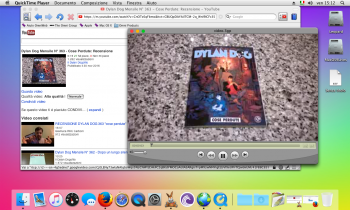

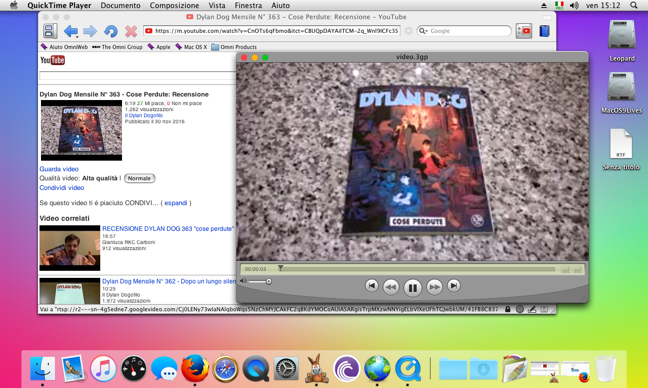

I am italian too. I'll try and I'll let you know.
It works. Nice find 🙂
However I find pointless to play videos in Coreplayer as they have a low quality and they play smoothly and almost instantly with QuickTime. If they were 360p videos or above, I would have tried with Coreplayer, but less than 360p is just fine on QuickTime on my MDD.
Not all videos work: all VEVO videos and maybe others won't work, this is a problem I met in the past when we had phones and not smartphones. By accessing the mobile version of Youtube you will be only able to watch videos from general users, and the ones from "official" channels like VEVO not.
