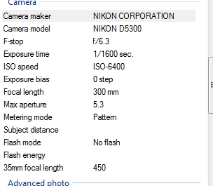

The EXIF data of the photo shows that the ISO was set to 6400. This will produce grainy pictures on almost every camera. Look at a comparison at cameralabs for example.
The aperture has nothing to do with the graininess of the image.

I had it set to AUTO..If I set it to Program mode where should it be set at to get sharper pics?
You are correct!

The lower the ISO, the less noise in the photo. Digital noise translates to grain.
Lower ISO means the sensor is less sensitive to light, so the camera has to compensate with a slower shutter speed. When you use a longer lens, you have to use a faster minimum shutter speed or else you get blur. Since your camera is using a faster shutter speed to combat blur, it's compensating by making the sensor more sensitive with a higher ISO which will cause more noise.
Learn about the exposure triangle between shutter speed, ISO, and aperture and it will explain everything.
If you adjust one of those settings, you have to alter the other two to expose a photo properly. Sometimes this will produce a properly exposed photo, but the results won't be ideal.
For $900 you should be able to get a third party 70-200 with a non variable aperture, maybe even a f/2.8 depending on what brand.
You could actually use a 1/400 shutter speed and ISO of 1600 for a less noisey photo.
Why would the auto setting choose iso 6400 ???
Because of the low-light you mentioned. And because you're using a telephoto lens. Since long lenses 'multiply' ever shaking movement you make, the shutterspeed has to be high to eliminate that. To have a high shutterspeed in low light condition means you have to use high ISO.

If this lens has VR, then 1/1600 shutter is completely unnecessary.

Thanks guys.. I appreciate your help! I just figured that when on AUTO mode the camera would of picked the PERFECT settings.. Ill try playing around with the iso a bit... If it was bright and sunny would the AUTO setting be a bit better when the camera chooses ISO 6400 ?
Shooting menu > ISO sensitivity settings > Auto ISO sensitivity control = ON > Maximum sensitivity = [number <6400]
yup, this sets the maximum iso in auto modus. set it to anything lower (try 1600 or 800) that produces less grain. but be aware that you might get into trouble when using this in a real low-light situation - as the camera now won't go higher than, say iso 800, it has to compensate by opening up the aperture and setting the shutter to longer exposure - which could lead to unsharp photos because of motion blur or shallow focus.

I would imagine that the limit is OFF by default. If you drop the value down to 1600 your photos should be noiseless (unless you really want to go looking for noise). The downside is that you might find the shutter speed a little slow for 'action shots' in poor light but this is also dependent upon aperture, which itself is influenced by degree of zoom (ie the maximum aperture size decreases as you zoom in).

I'll be brief - while I am not an exact fan of the site, it does offer some good info in your case. Go to DPreview and look up your camera. There are often test shots and some explanation. Cameras often have a 'sweet spot' of ISO's where the camera performs well and up to its best. What was not really mentioned is that some cameras also have very low ISO output challenges too. So as example a camera that supposedly does ISO 100-6400 might perform well at 200-1600 with maybe ISO 400 being the "best."
As someone else here was right to do - use the term noise not grainy.
If you practice, you can go to a location and figure out what would be the best range of ISO and if you are shooting sports, you know that in order to stop the motion you will need a fast shutter speed which implies more often than not leaning upwards in the ISO facet of the equation.
Simple exercise -
Find a similar site to where you shot your pix with similar weather conditions.
Do a set of test shots on ISO starting with 6400, 3200 and so on. Also consider the lens and that not all lenses are at their best when shot wide open. The point of the exercise is to find which ISO is acceptable under those shooting conditions. You may find that 3200 or 1600 does better for you and may or may not provide adequate shutter speed. For sports, often photographers want "faster" lenses.
