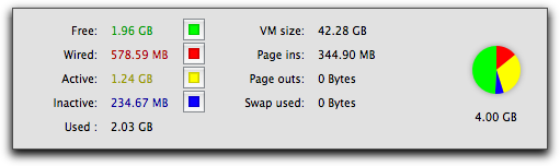

Here is my set up. MBP Santa Rosa with 2GB of ram.
Eudora PPC running under Rosetta. close to 20,000 emails + few other apps running.
This is WITHOUT running iTunes (>200gb of music on external drive), photoshop, VMWare, etc.
Currently showing in Activity Monitor: System Memory, VM size = 13.37 GB.
(Yes, I am going to swap a 4GB set of RAM in this week...)
So someone with only 1GB of physical memory can conceivable need more than 10 GB of disk space easily.
That's a bit misleading - the system sucks up what VM it can based on available resources:
I'm only running a few apps, freshly opened, so I doubt I need the 42GB of swap. :D
