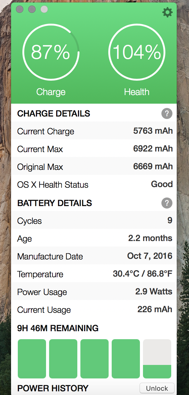

Here is my idle usage with my MacBook 15". It's barely using ANY power.
if a power usage of 5W on a 13" is good for 10ish hours battery life. Whats the ideal usage for a 15" ?
