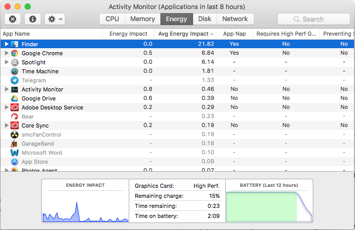

Here's what I'm getting AFTER the update just with normal use: 3.5 hours. :mad::(
Exactly same as before the update.
(yes, for some reason the graphics card is on high, which appears to be from an external monitor being plugged in - but I'm just web browsing and messaging mostly so I can't see why it would be taking up so much energy just to send a video signal. The monitor has it's own power, obviously. )
EDIT: unplugging the external monitor drops power usage by 20W or more, which gives me much better times. Looks like the graphics card is a hungry beast.

Can you comment on the battery performance when you are not using an external monitor?
Yeah having the external monitor plugged in was definitely the culprit I think. It's a good old 27 inch LED cinema display with a Thunderbolt 2 adapter.
This seems to force use of the high performance graphics card, and that card really sucks power even when I'm not doing anything.
Yeah having the external monitor plugged in was definitely the culprit I think. The good graphics card really sucks the juice.
Oh, thanks. If you are using a high resolution monitor, then the dedicated graphics card would come into play I guess. From my understanding that is used to upscale the resolution. I am not sure, Apple people might have something more technically accurate to say.

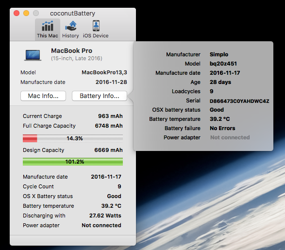

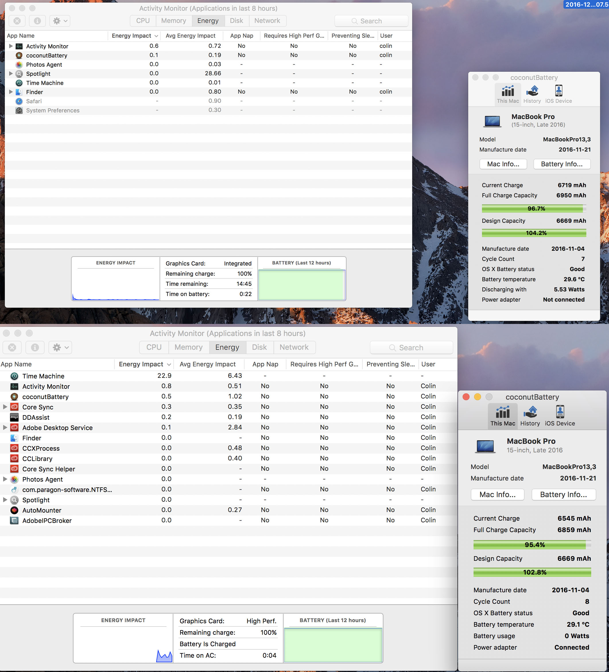

So, I installed Sierra 10.12.2 on a USB flash drive and booted from there. On the fresh installation on desktop with just activity monitor and coconut battery running I'm using 5.5w with an estimated 14hrs of battery left.
My main installation uses 20w just sat in the desktop. Clearly my main installation has something wrong with it or it's something I've installed along the way.
I'm attaching screen grabs of both systems running just from boot on desktop. Note that on my main installation Adobe CC is engaging my discrete graphics even though I've stopped creative cloud app from running. Bad form Adobe. I have to kill all the CC processes if I want to run on integrated GPU.
