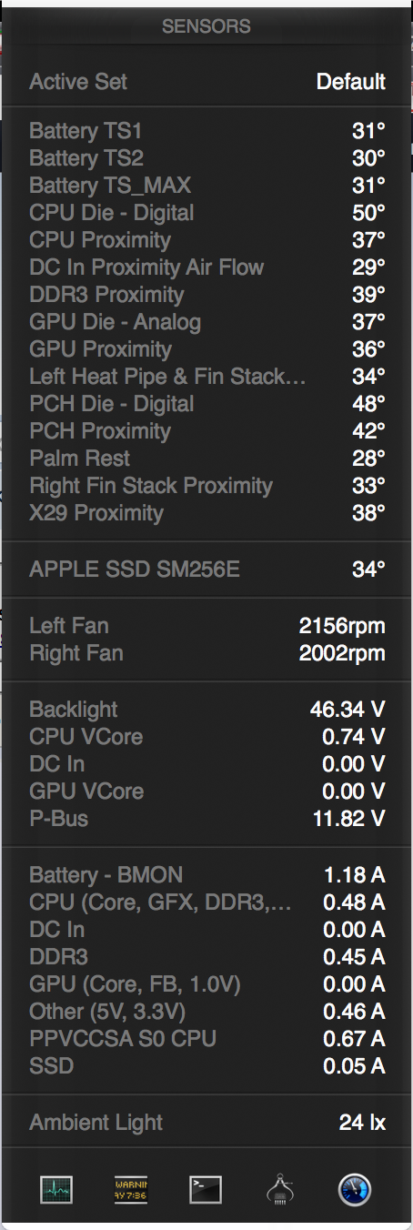

Wow. Should I assume there's something wrong with my rMBP? Which iStat version are you running?
12 tabs open on Chrome, Sparrow, Dropbox, Little Snitch, SABNZBd, Fantastical running.
[image]
4.0.4
I don't think there's something wrong with yours, though. It depends a lot on the pages that are open, I'd say. As soon as I have multiple pages with flash elements or fancy Javascript open, my temperatures go up, too. Plus my mac sits on a stand.
I think it's just a little variation from the manufacturing, and I got lucky. But as long as your MBP doesn't run into throttling all the time when you push it, I wouldn't worry.

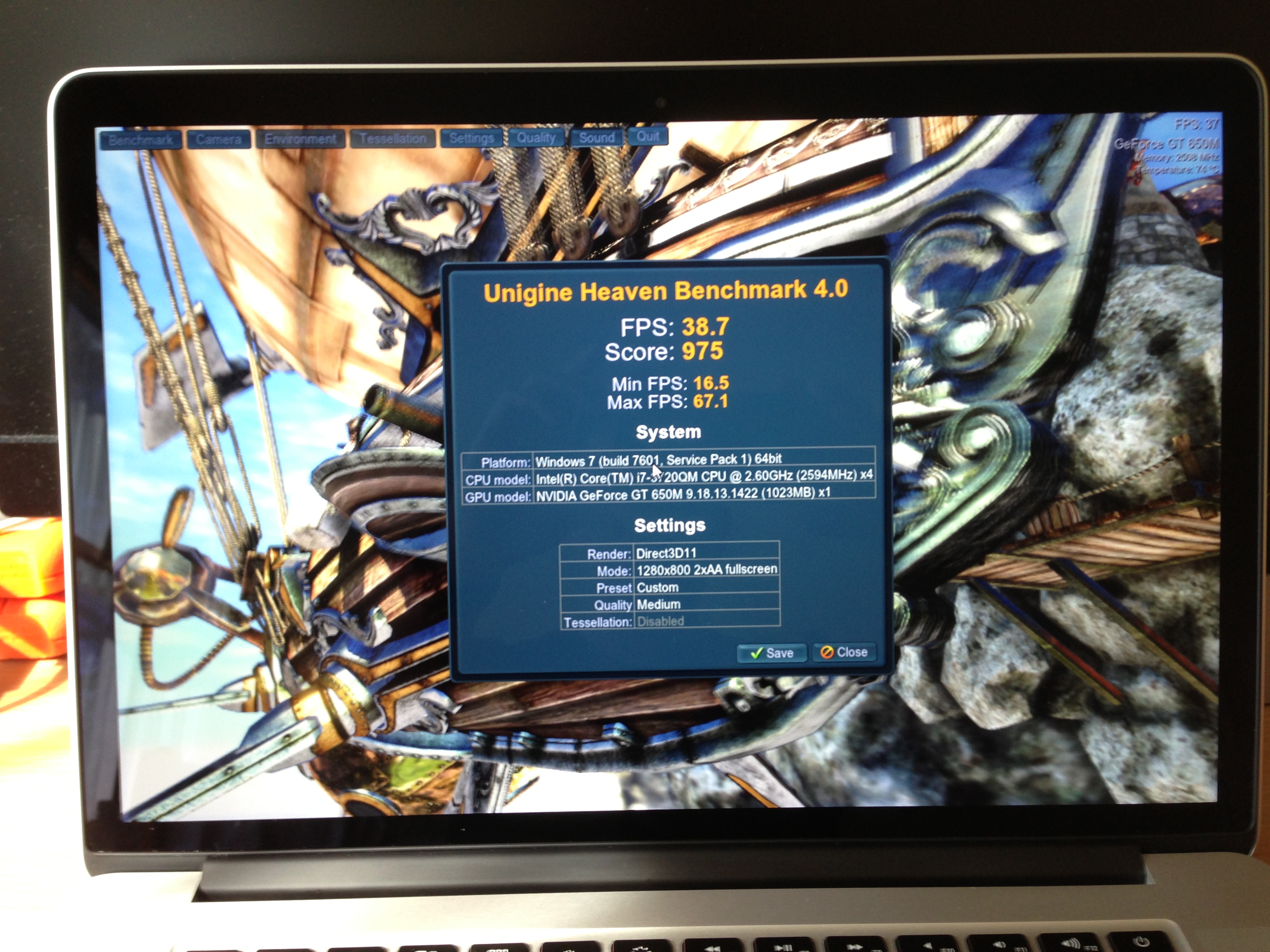

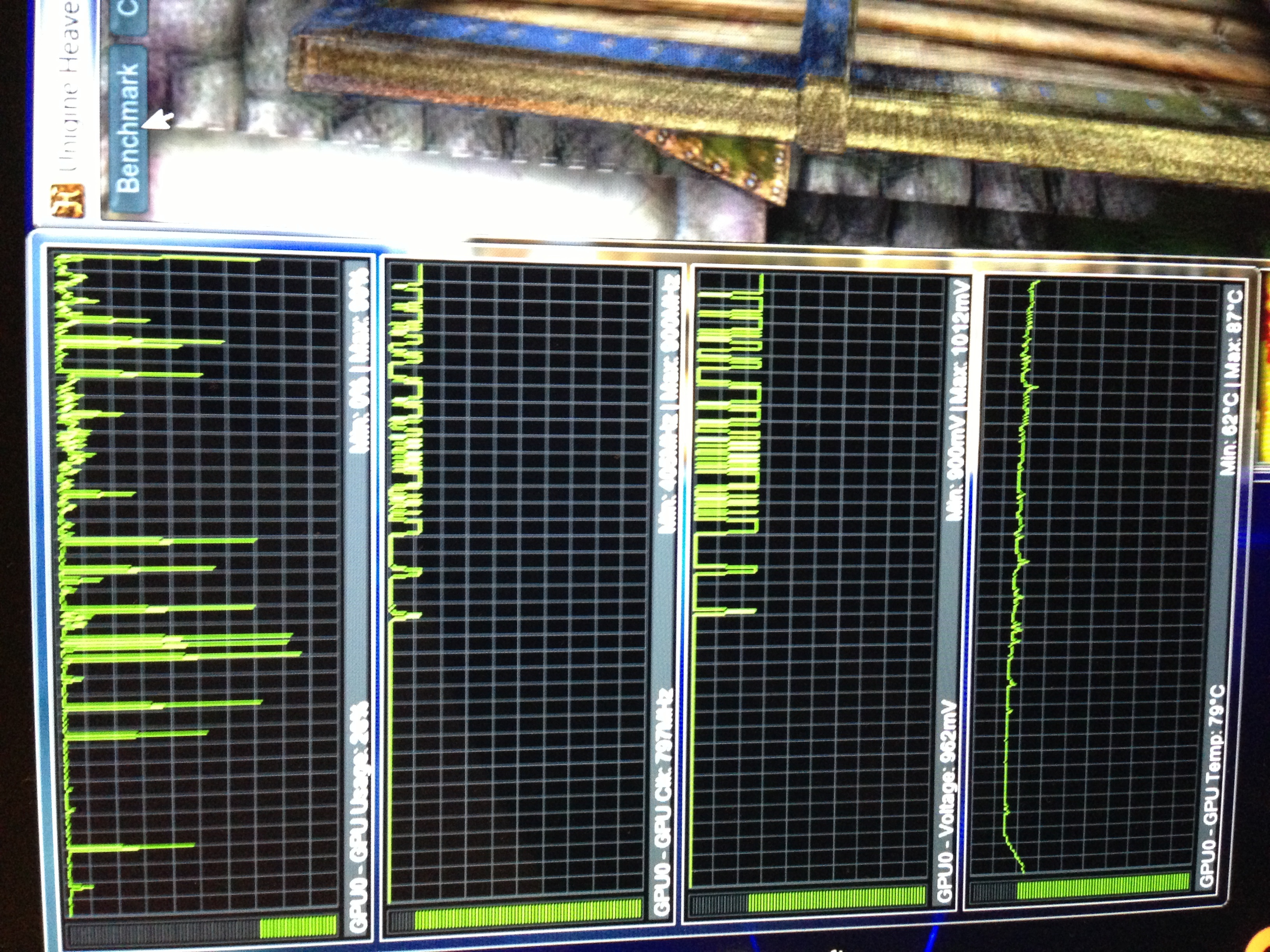

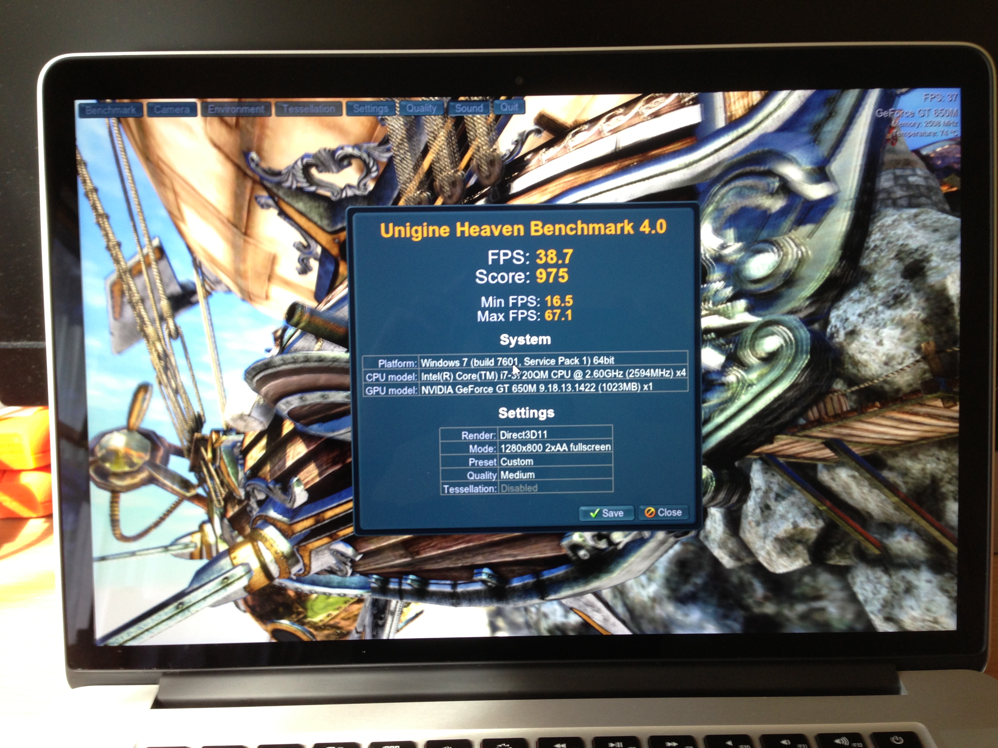

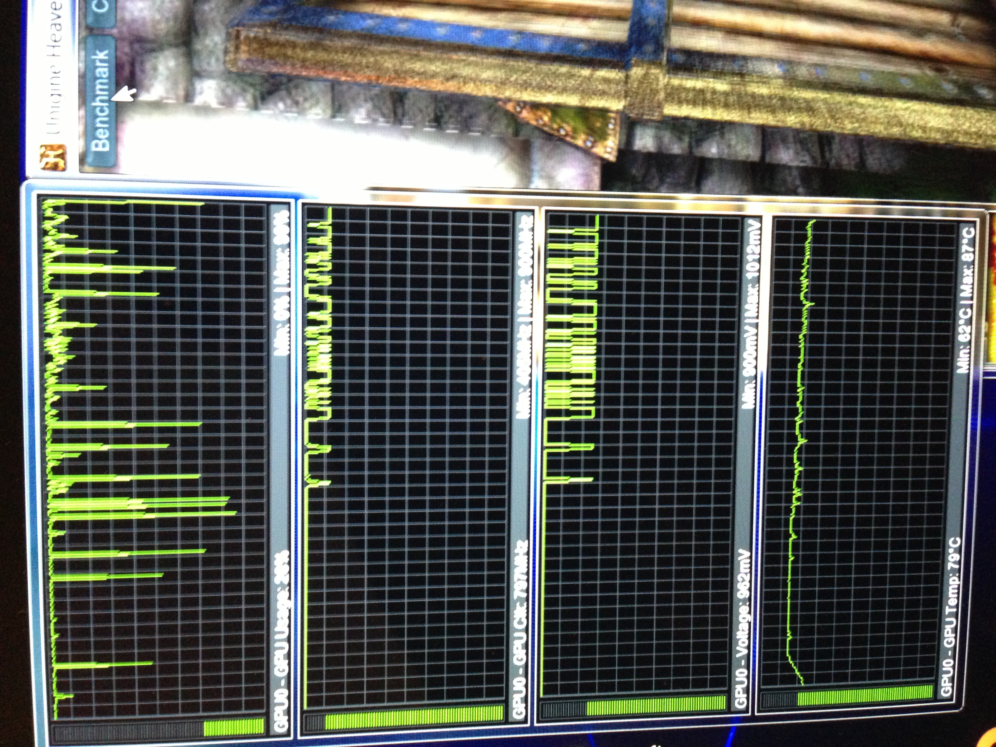

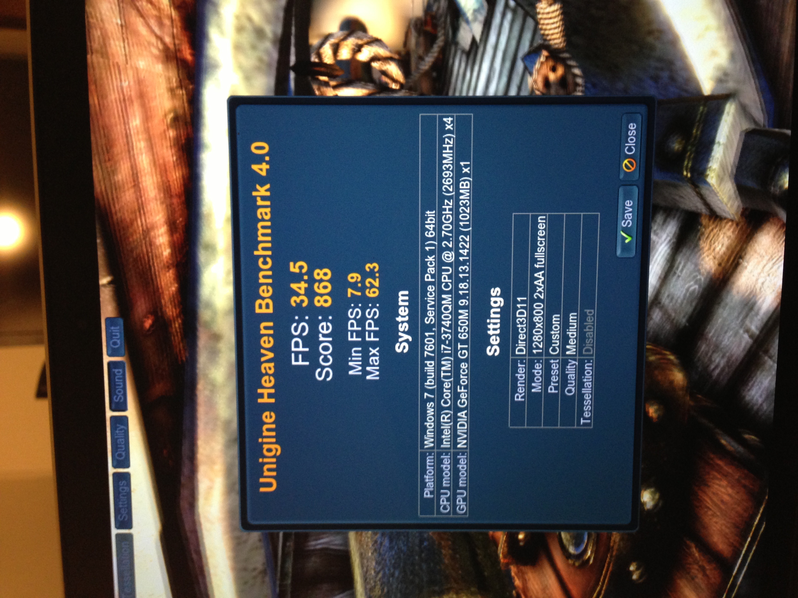

Hey Can anyone compare benchmarks with me so I see if my MacBook is working right I used the Heaven benchmark 4.0 This was done on Windows 7 Boot Camp with the higher end Retina MacBook pro Please use the same settings

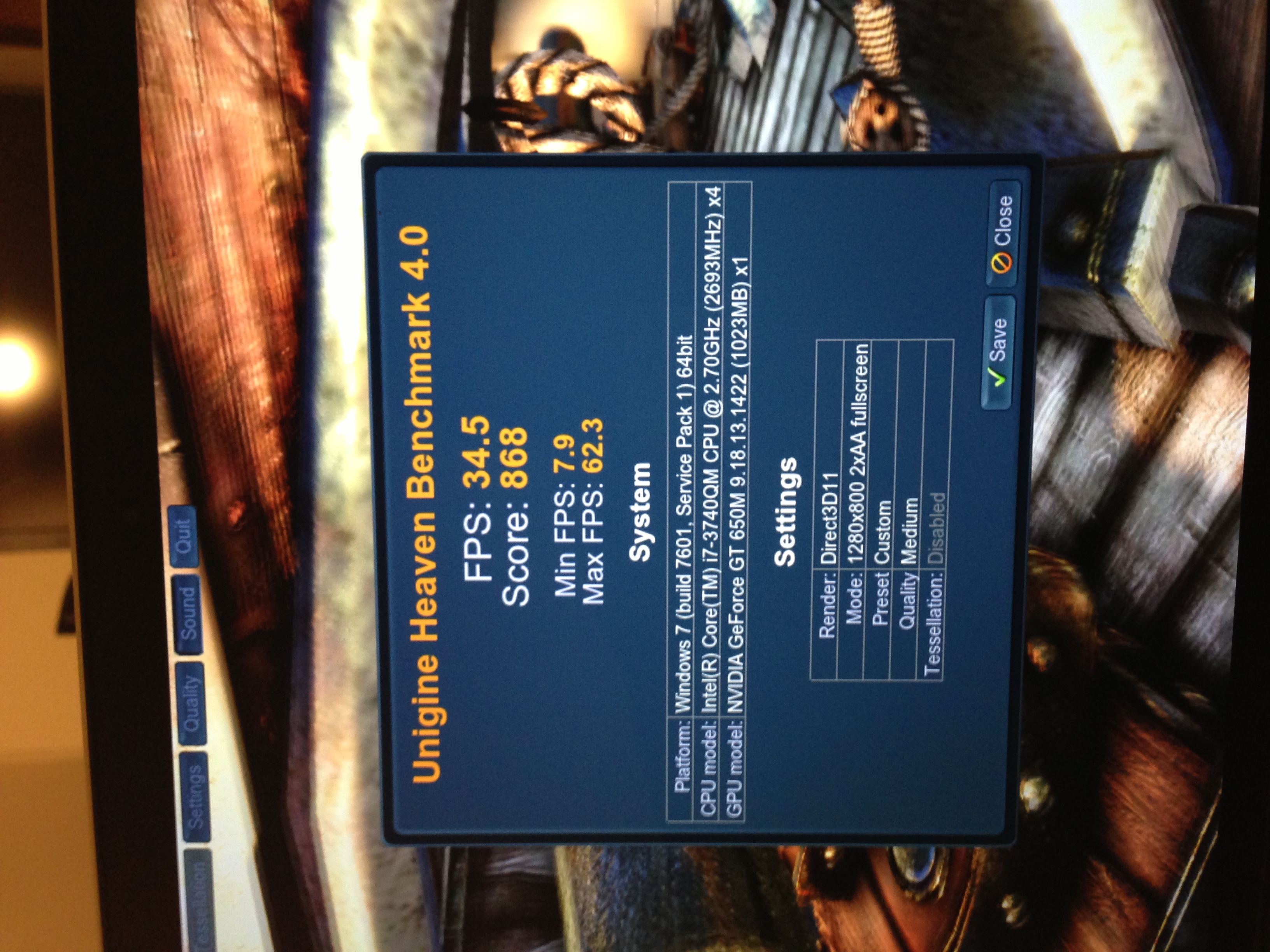

Sorry, I didn't open the image and I was on Tapatalk so I couldn't read what was on it. Mine is a 2.3/16GB. Want me to test it as well or are you just asking users with the same CPU?
be cool if you could. And also I've been monitoring my clock speeds It seems to bounce between 900 and 700 is this normal?
Could you explain this, please? What do you mean? Are you using this and getting better results? Which software?
If you wish to do it. Just right click your desktop and load up nVidia Control Panel. From there just go to Manage 3D settings then within Features there will be Multi-display/mixed-GPU acceleration. Directly to the right change it from Multi-display to single display.
