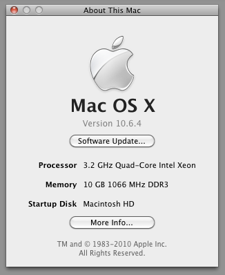

Find out for myself today, though others have already confirmed... 3.2 ghz quad core running with 2 x 4gb ram from OWC + 2 x 1gb ram from Apple = 10 gb ram
It's great to know that it works. Can you confirm that it's running in dual channel mode?

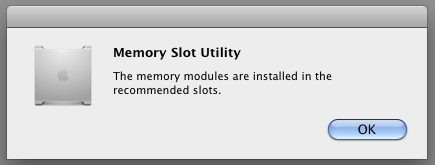

I'm sorry I don't know how to check for that. I've searched for a way or a utility but haven't found one yet.
Maybe someone else here know....
Maybe the Memory Configuration Tool (I think it is named like that in english) can help.
You can find it in /System/Library/CoreServices.

When I run this (Memory Slot Utility) I only get this simple message:
