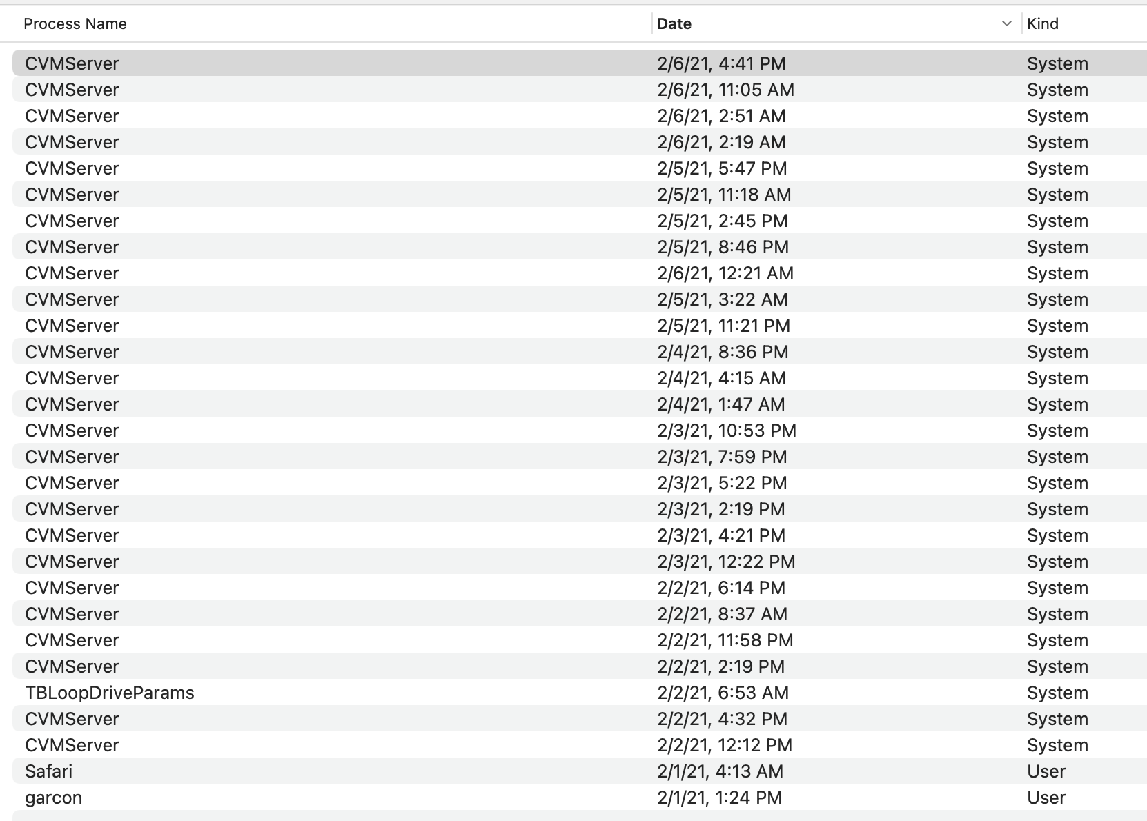

Seeing the same error on my M1 after 11.2 update. 5 automatic unattended reboots in a 12 hour period. Etrecheck has no definitive answer and suggests posting a question on the Apple community board.

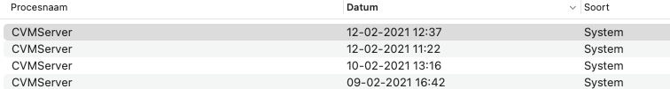

Same crash, can't associate with anything specific. Happens often when I'm not active on the Mac (M1, 2020)

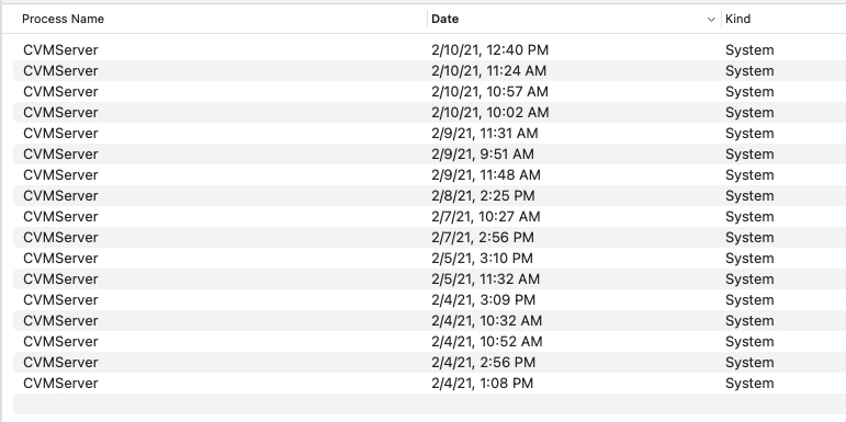

I'm having the same problem--about 3-5 times a day now. Would love to find a solution. Luckily the M1 reboots so much faster than my old MBP.
