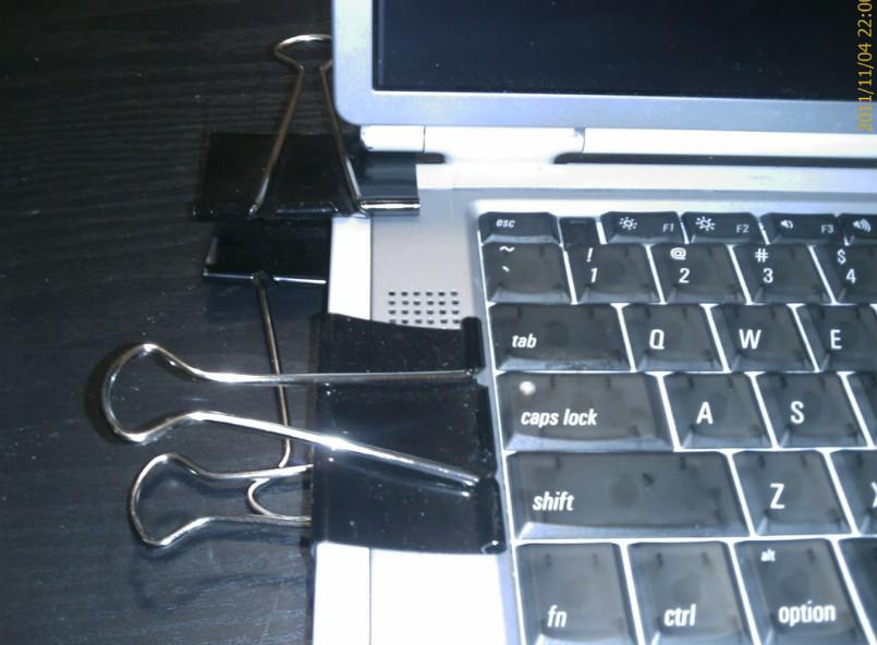

Note that the Mac I mentioned before that I did this too also had stress points. In my case however, applying pressure at a certain point eliminated the freezing.
I had two big old binder clips attached to two points on the left side of the case. At that point I wasn't really using that Mac (my wife had had her 12" PB for awhile at that point) so this was an exercise in how long I could keep the thing running.

Bet that turned as many heads as your dual 17" PowerBook G4s when you are at a coffee shop. Then again, I have used shims for iBook video cards...
LOL! No, this Mac was in no condition to go anywhere. It stayed on the coffee table at home. I'd had both of my 17"s for a couple years by that point.
