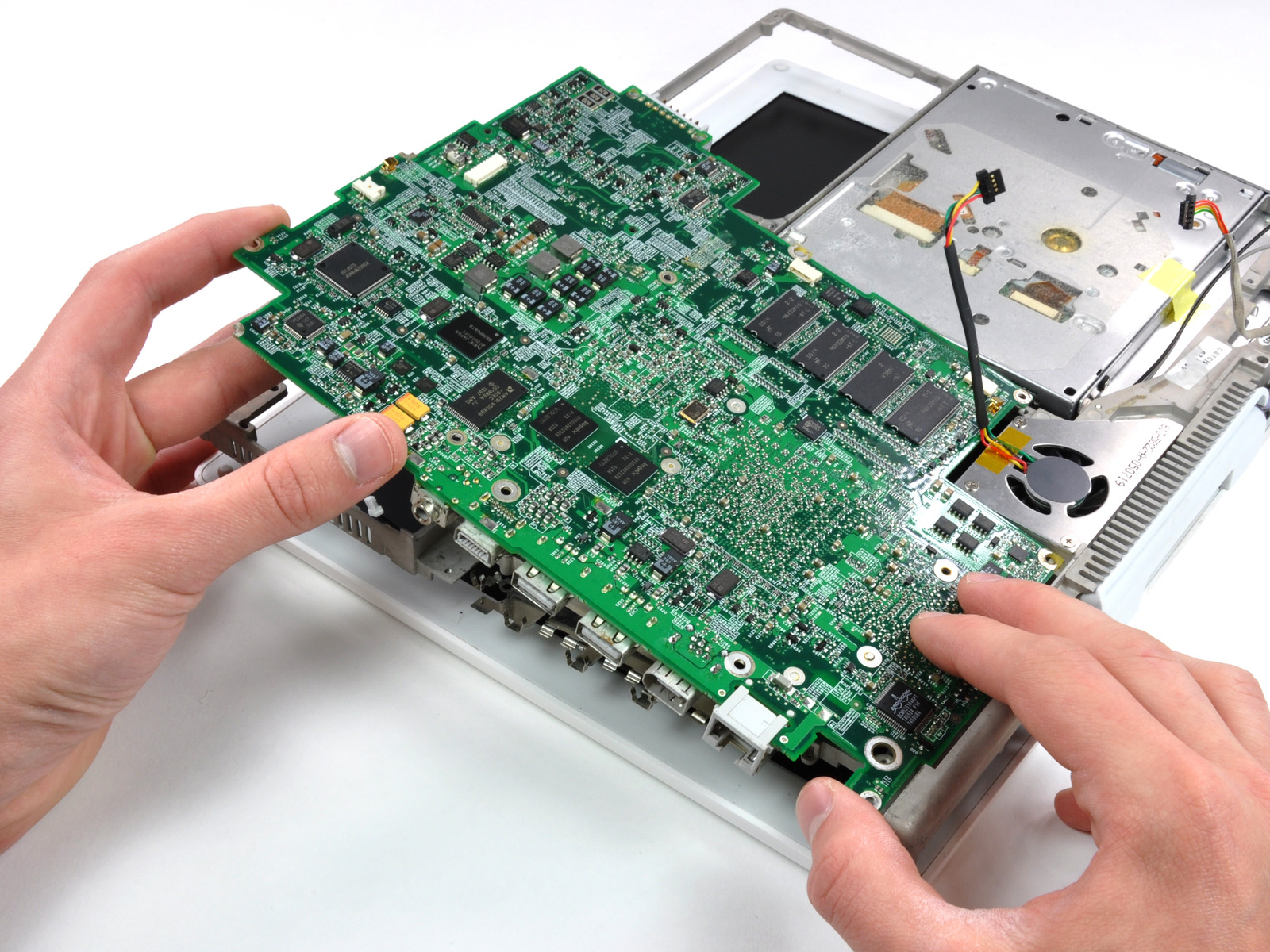

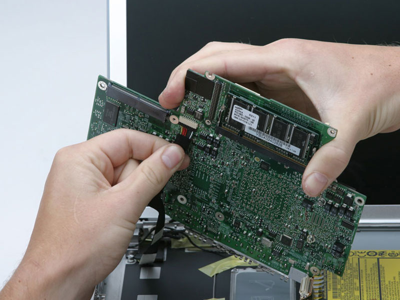

My friend wants to try swapping the logic boards between my PowerBook G4 and his iBook which he no longer uses. I don't know if his is 12" or 14" and he doesn't know either.
Assuming his iBook is 12", would the logic board in that laptop fit in my PowerBook?
No.
Square peg, round hole. Ford engine in GM car. Black ink on black paper. Somethings just don't work.
He won't believe me when I tell him, or he'll still insist on trying. Can you explain why it won't fit? Sorry to bother you with something like that.
Type into Google Images "iBook G4 Logic Board" and "PowerBook G4 12 inch logic board" and you will see. Completely different designs. Even if you fit it in the case (which it may) the mounting would be completely off.
One of these does not look like the other.
iBook<->PowerBook.

If you put the iBook next to the Powerbook, you can easily see that although the screen is about the same size, the iBook case is noticeably larger, the I/O port configuration is different, the internal connections to virtually all devices/display/power are not similar, nor in the same locations, etc. etc...
"square peg in a round hole" is an apt description.
But, if one wants to try, be sure to get lots of duct tape and superglue... 😀
Impossible is the better answer.

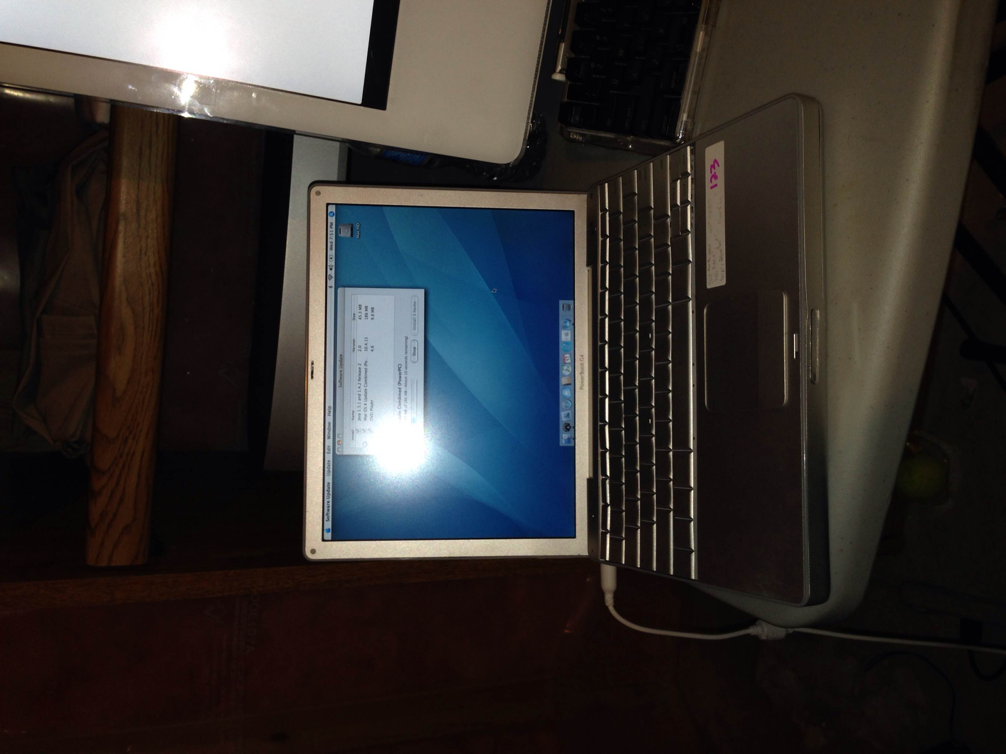

What I noticed about this PowerBook is that it really only seems to work when it has warmed up a bit. This might take a bit to do, rebooting it or trying to get it running enough to get it substantially warmed up. Because it sits in my basement, it's going to take a while for it to warm up. Once it has warmed up internally, it seems to work fine. The problems don't disappear immediately as it gets warmer. They slowly go away, then once they appear minimal, when the screen changes (especially to something more graphical) they go away completely.
Does anyone know of any proper hardware test software (particularly Apple Hardware Test, where can I find it?) for this PowerBook? For those who don't already know, it's an 867MHz PowerBook G4 aluminum, 12".

It seems to work when it has warmed up, and when it does work, it works quite well.
Either that or it could be complete luck that it is running.
I'll give it a shot.
