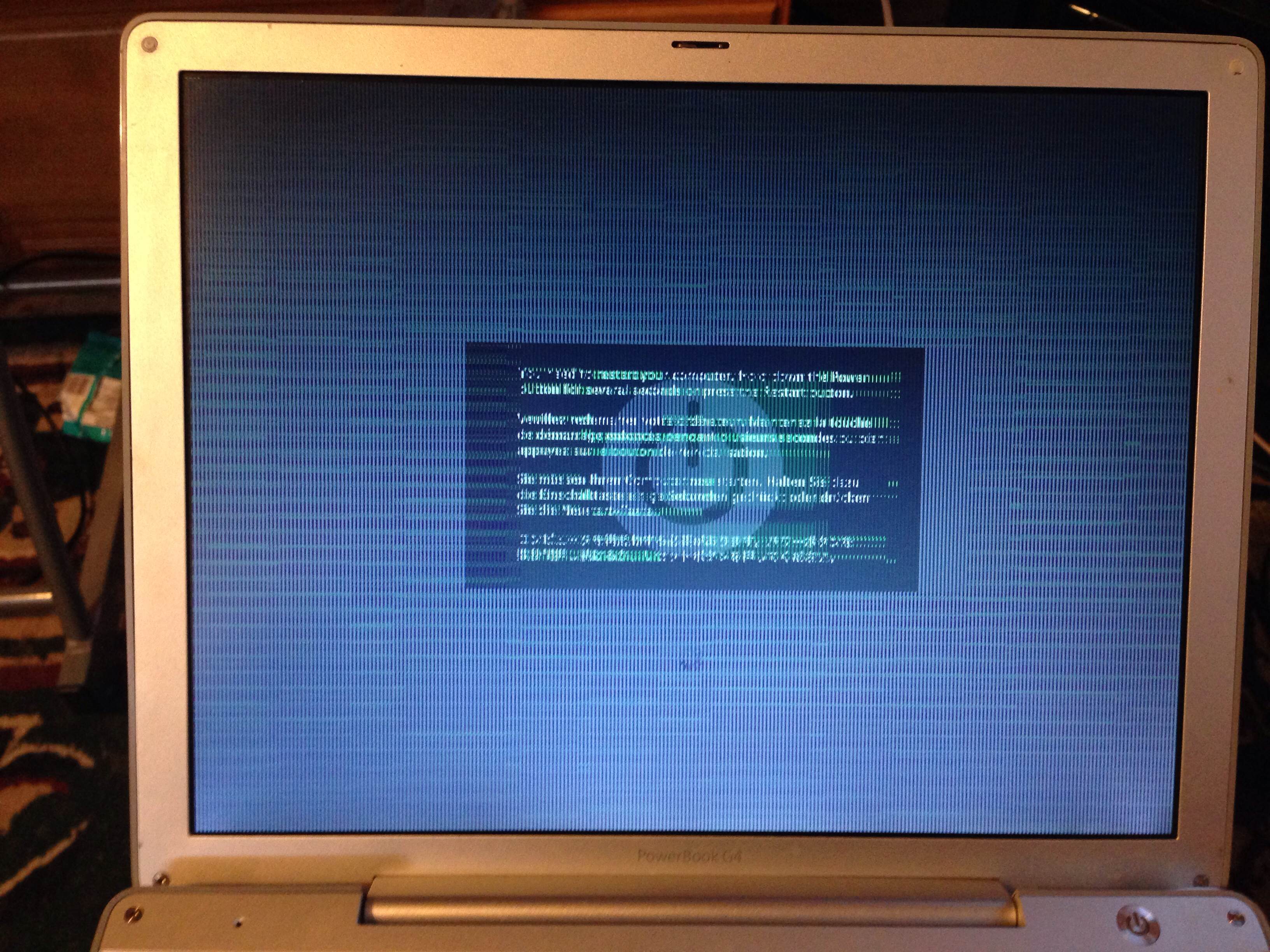

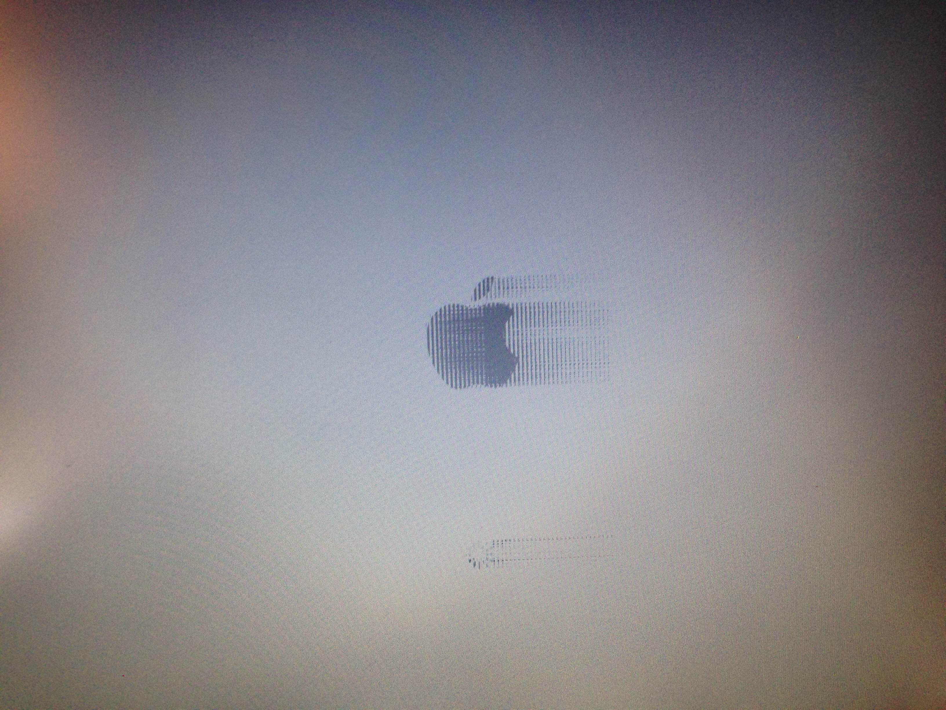

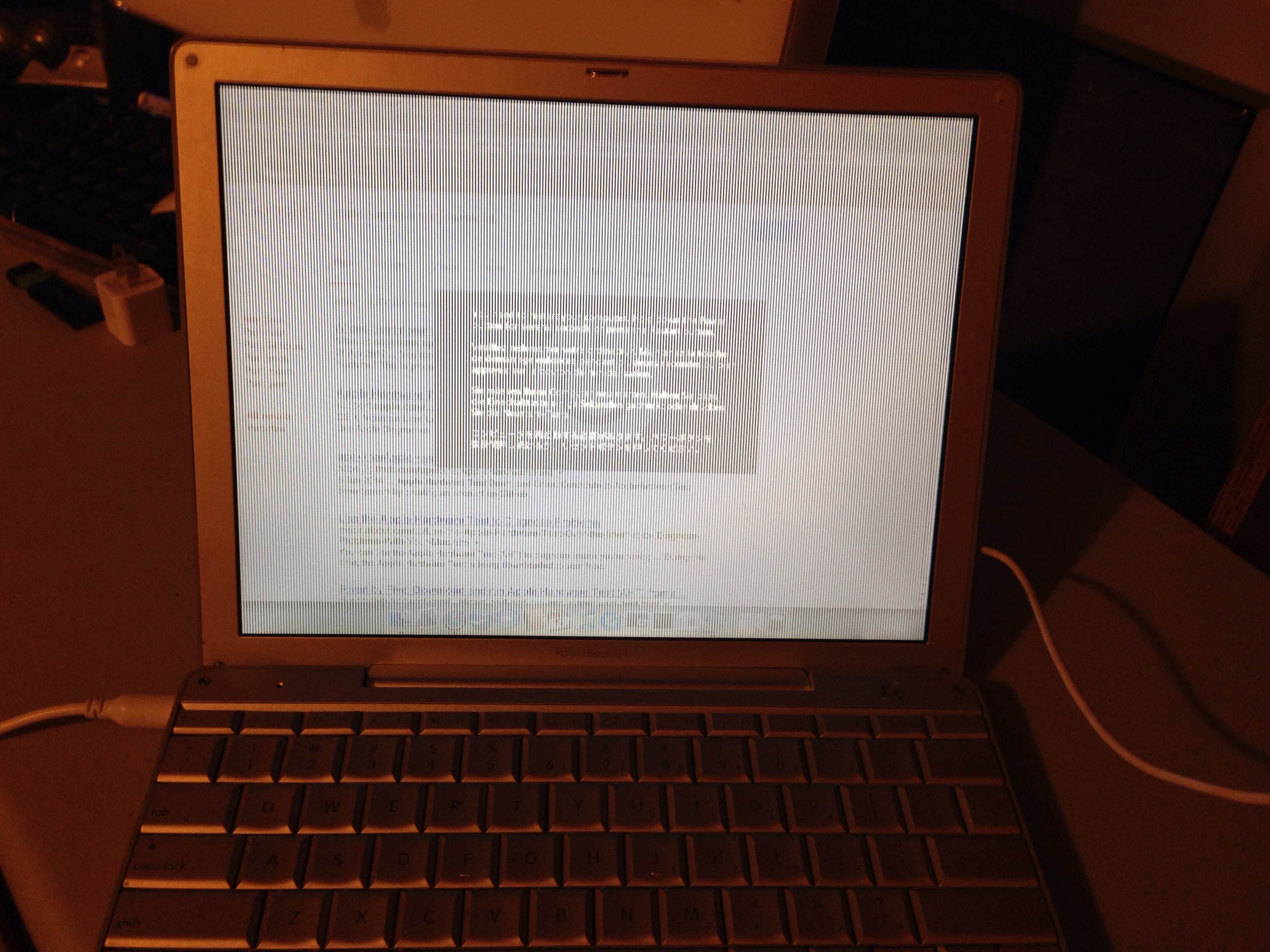

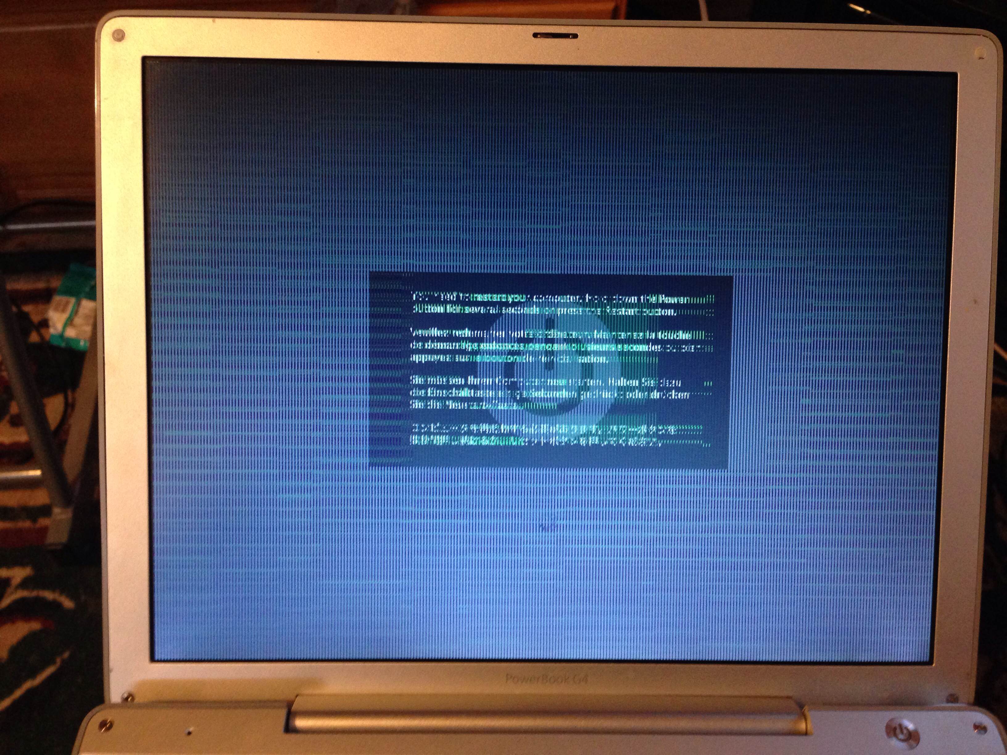

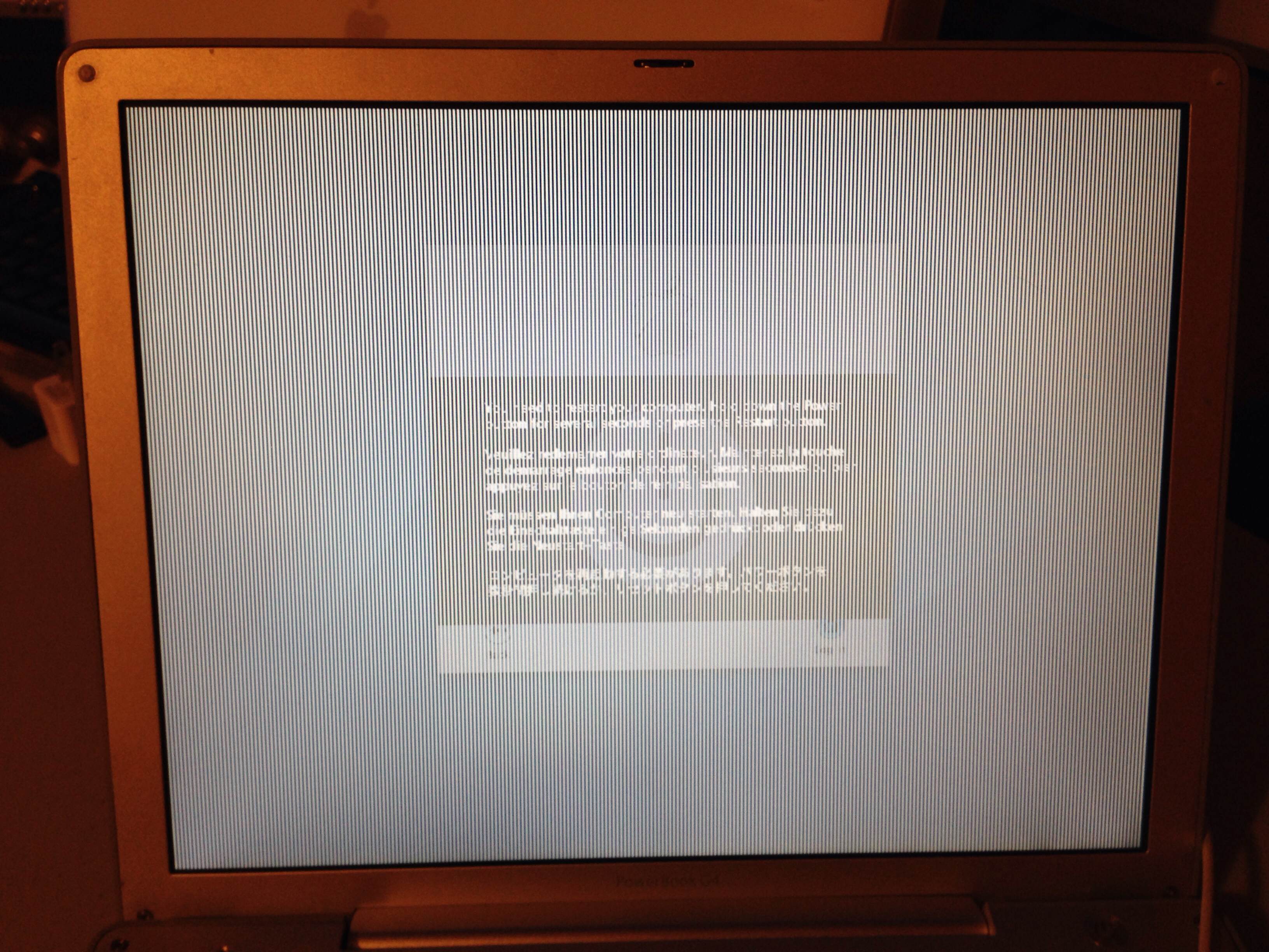

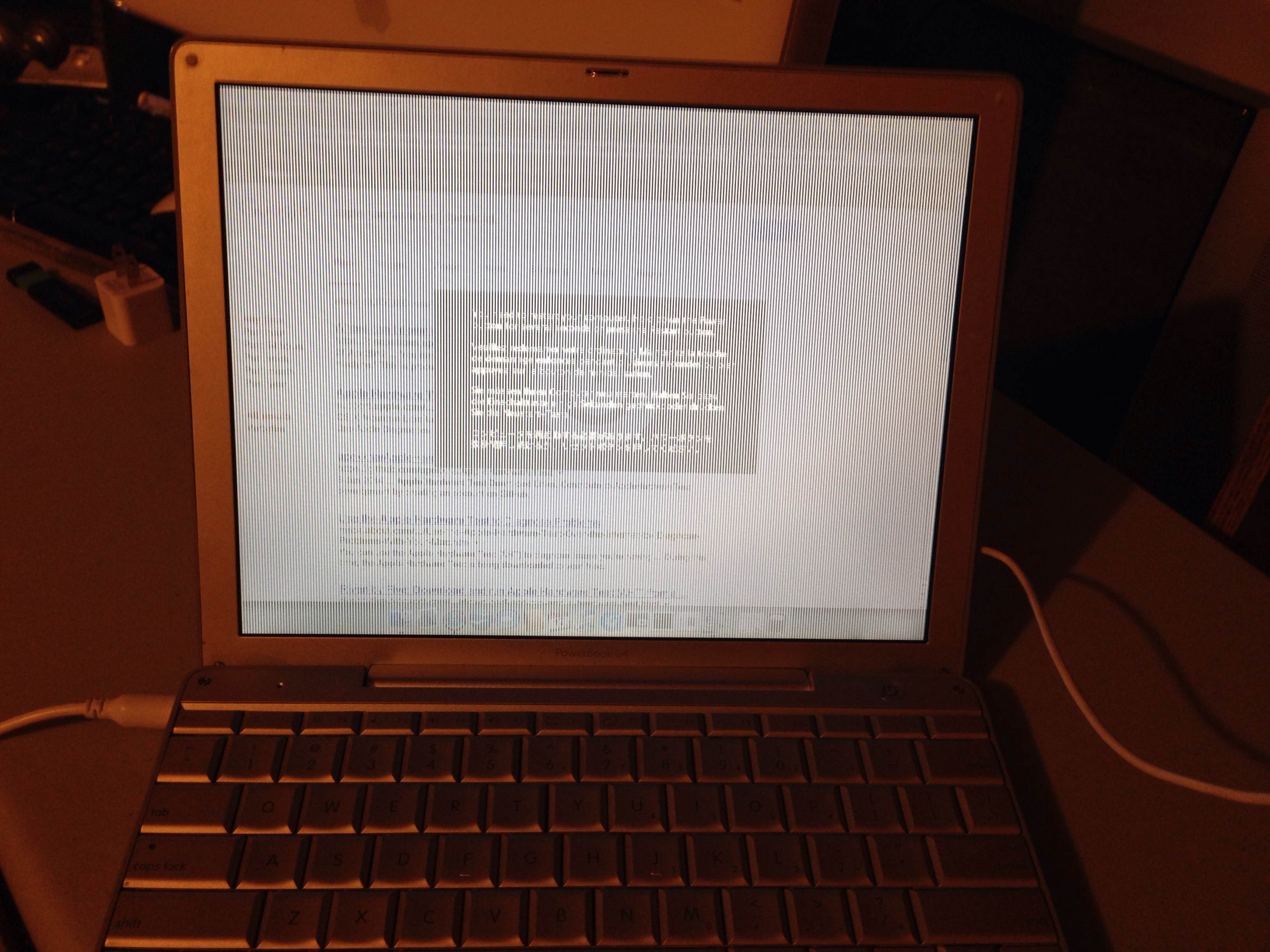

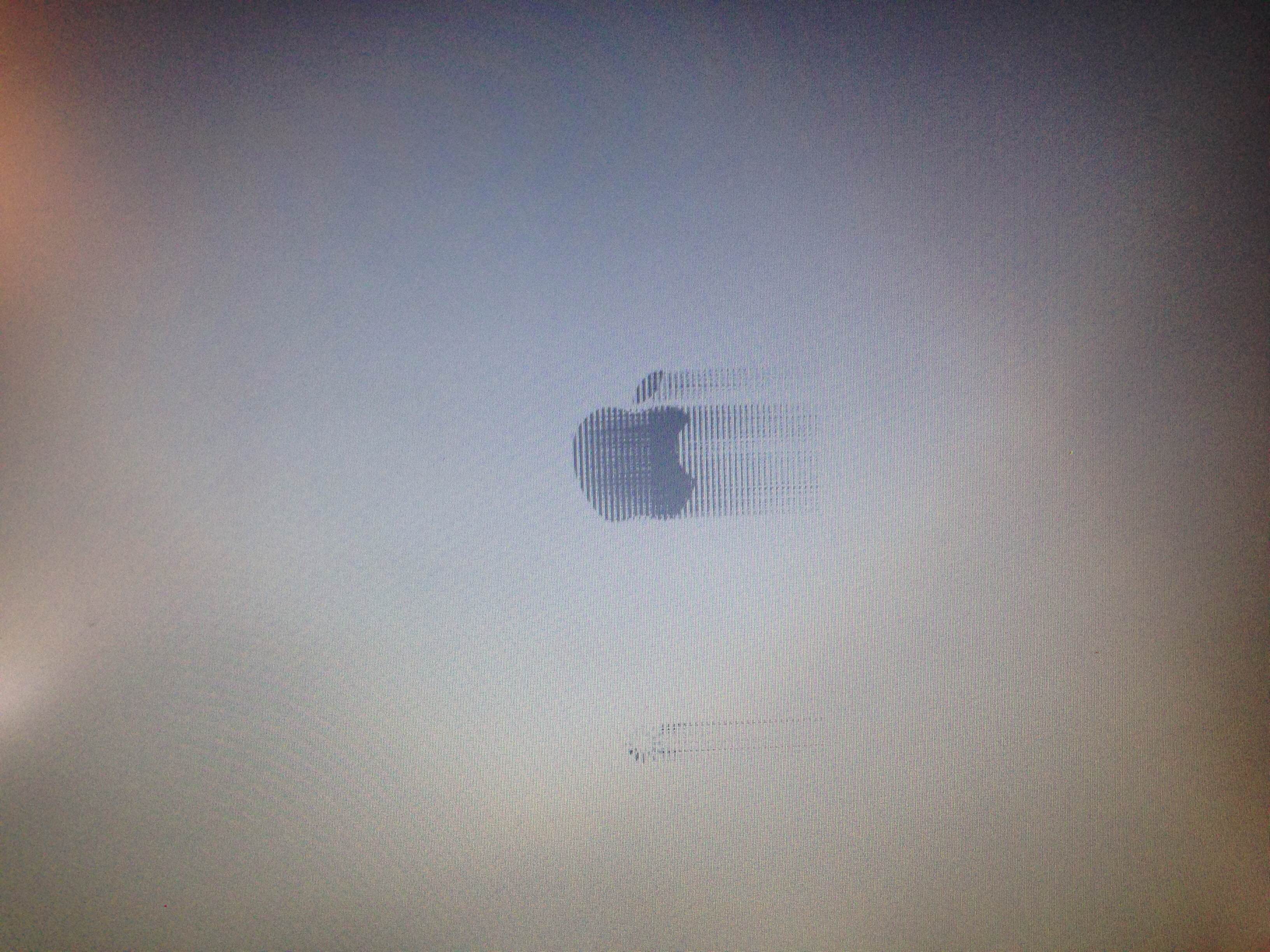

To get an idea of what's happening I have some images here:
I've seen that happen to a few 12" Powerbooks. A logicboard replacement was the only that that would work. Some of the older 867Mhz and 1Ghz ones that had this happen went through a lobotomy and ended up running screenless and with a special configuration as servers for a while. They never lasted more than 8 months like that. When one would die, we'd just switch out the drive with another failing GPU machine. For some reason we would call them "hammies", don't know or remember why.
