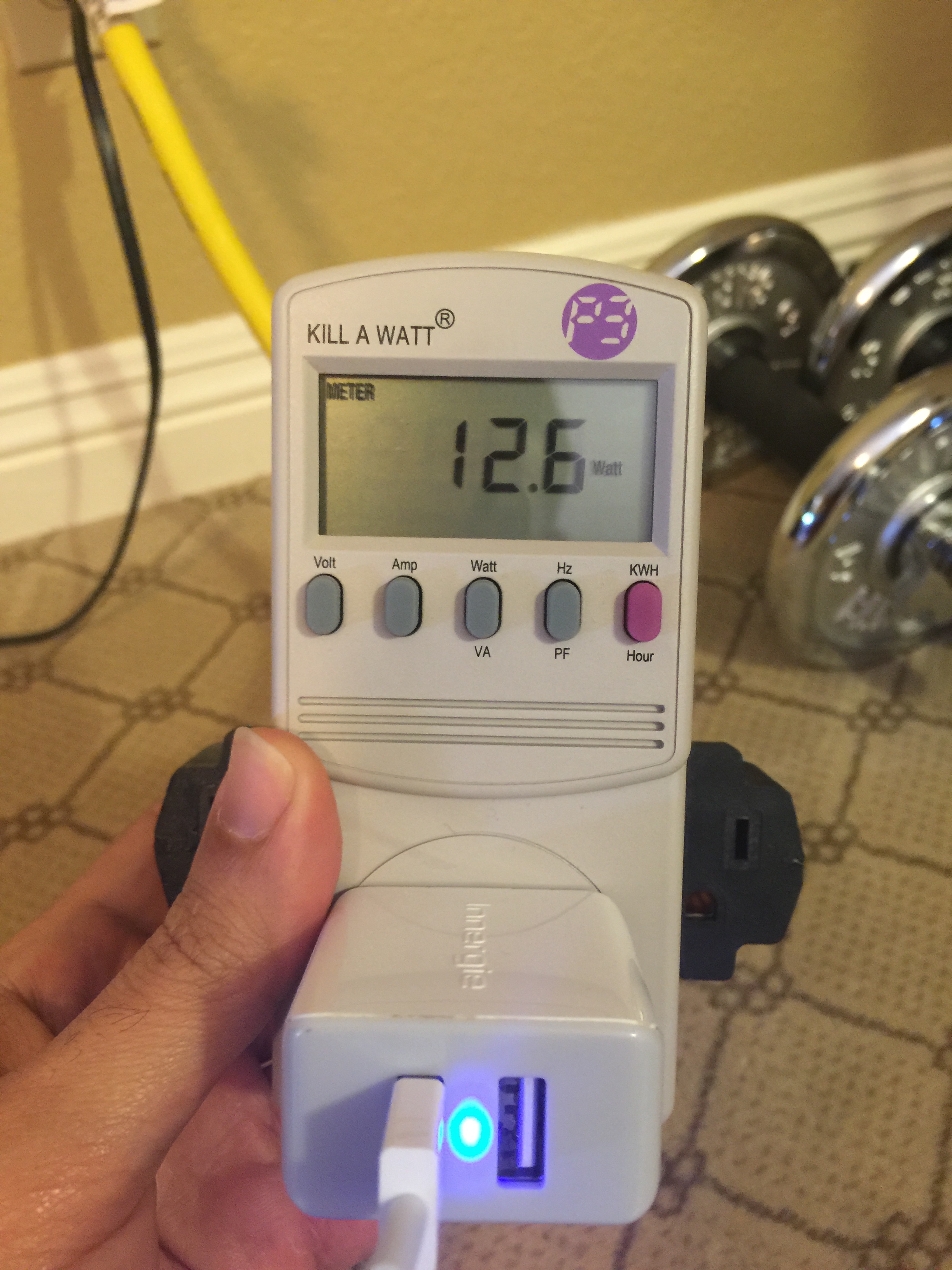

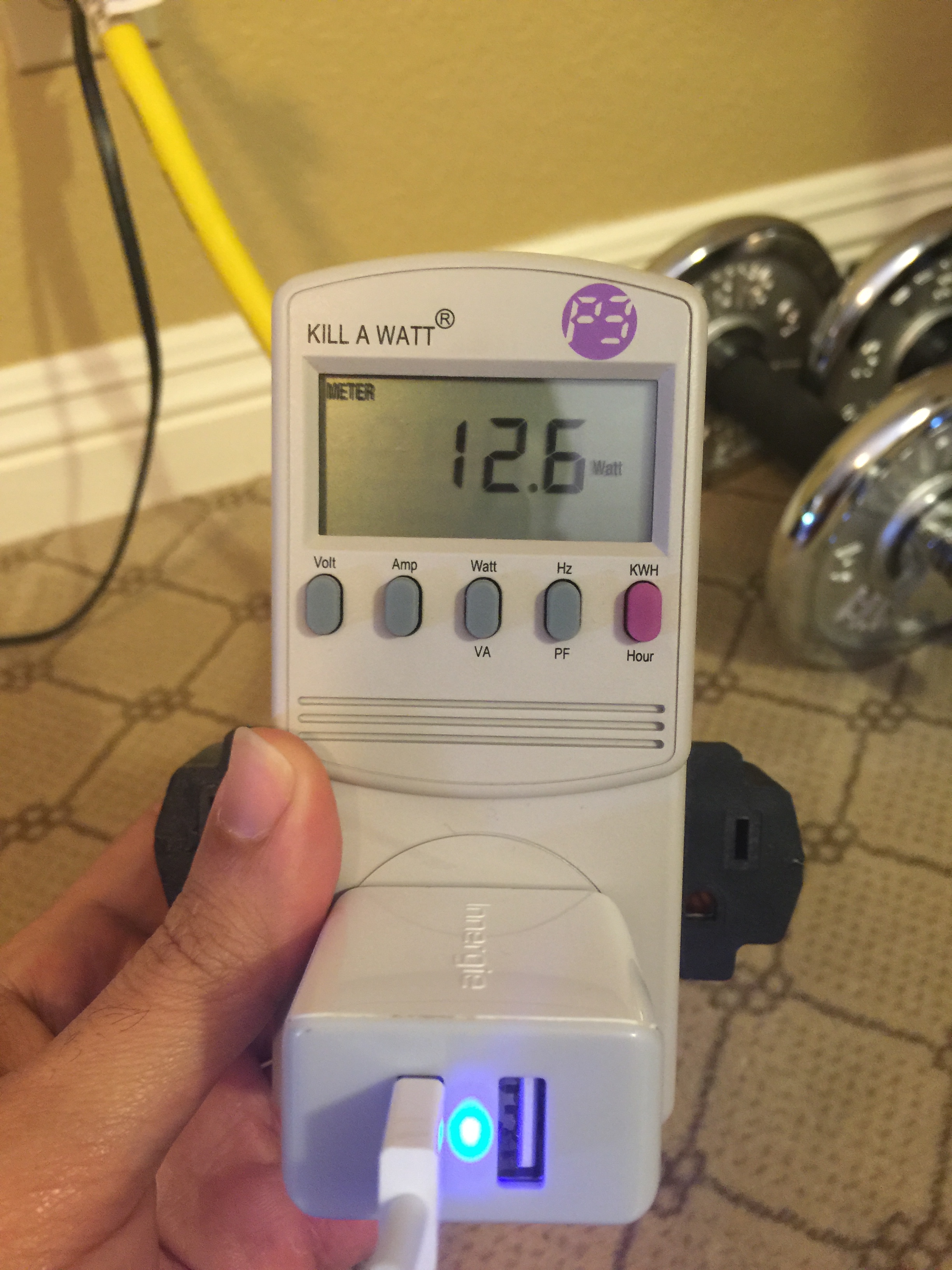

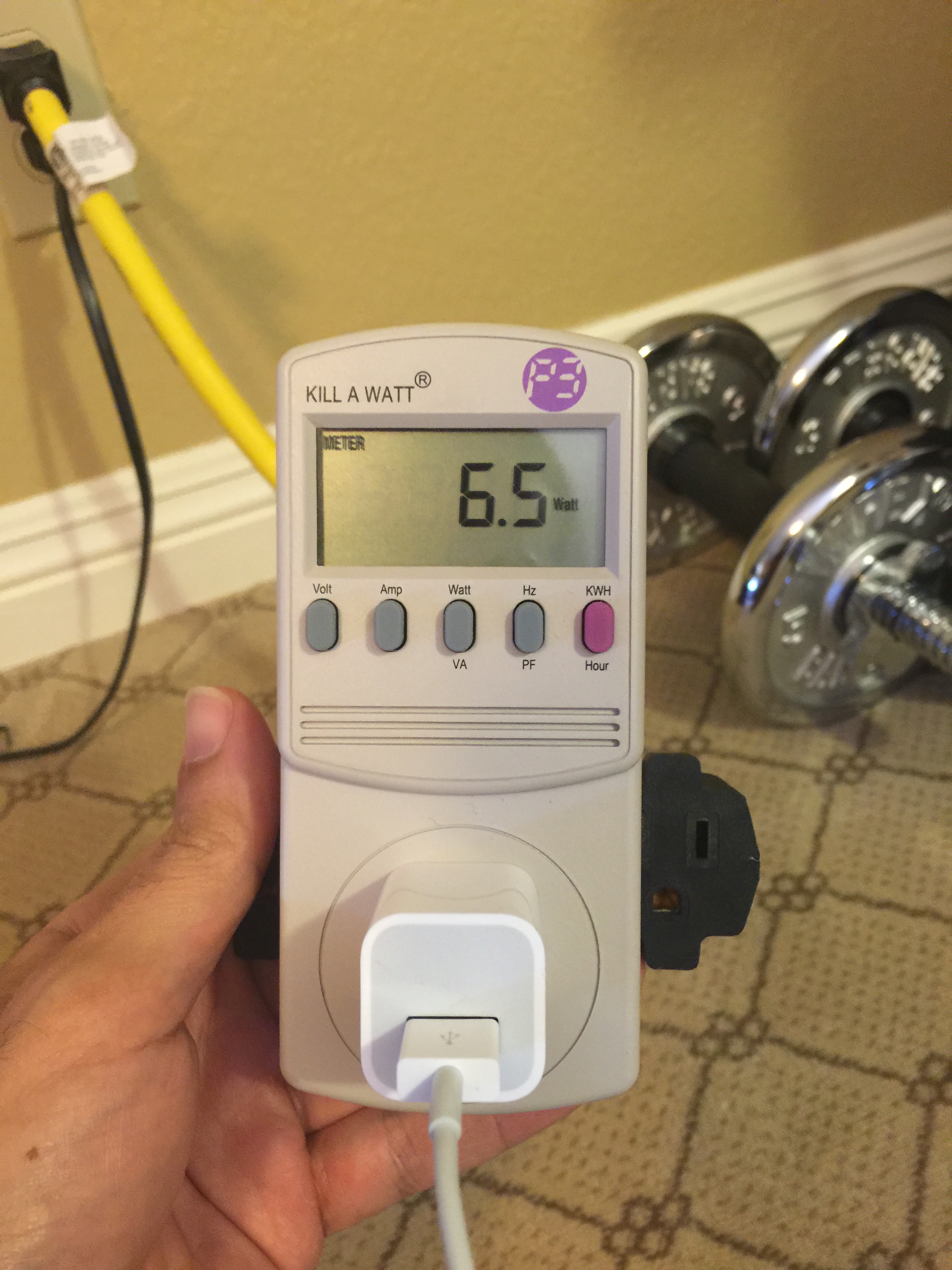

Not sure if this has been done yet, but I decided to dig up the Kill-A-Watt and take some measurements. Both chargers had a readout of 0.0 watts when plugged in with nothing but the cable attached to them. Both photos taken with an iPhone 6 Plus while being charged. See attached images.

Did some more testing... Charged my 6 Plus with the 12 watt charger, as the battery got closer to 100% the charge rate started slowly dropping, but the phone maintained a draw greater than the 5 watt charger is capable of providing up until it hit 90% where it dropped to 6.5 watts of draw (from the wall) same as the 5 watt charger it comes with.
There's definitely significant time to be saved using a higher capacity charger, and the phone only got luke warm, no excessive heat at all. a 6 may get a little warmer but I don't suspect it would be an issue there either.
