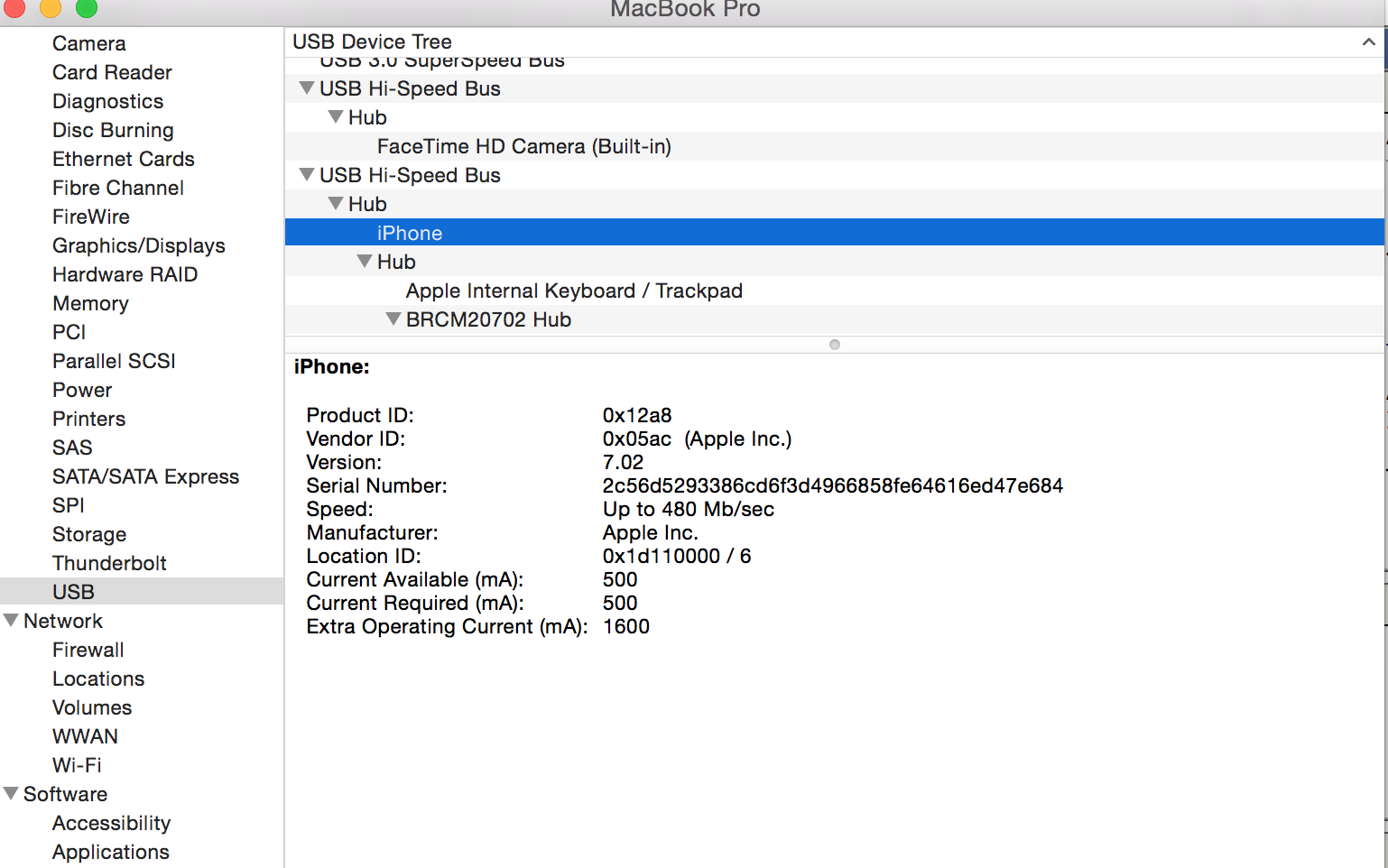

I just checked my MacBook Pro and it's showing 2100 mA or 11.55W being used for my 6.
