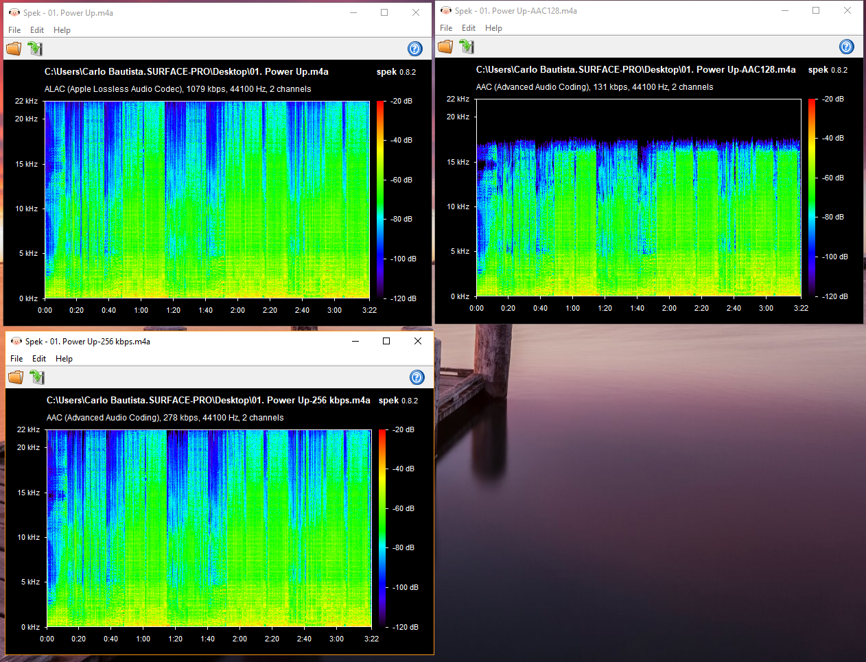

If you run the two on a spectrum, visually, you can see a huge difference. Whether your ears are sensitive enough to hear the difference is a different matter.
Here they are visually: You can see that AAC LC 256 Kbps is almost exactly as the Apple Lossless version while the 128 kbps has a cut-off at 17KHz
Wow that is amazing to see the results like that visually. Seems like the 128kbps mp3 has the high frequencies cut off in, but its difficult to hear those high frequencies for the average human. 256kbps AAC looks very impressive.
Could you do a comparison between 256kbps AAC vs 320kbps MP3 using the same method above? Thanks for doing this.

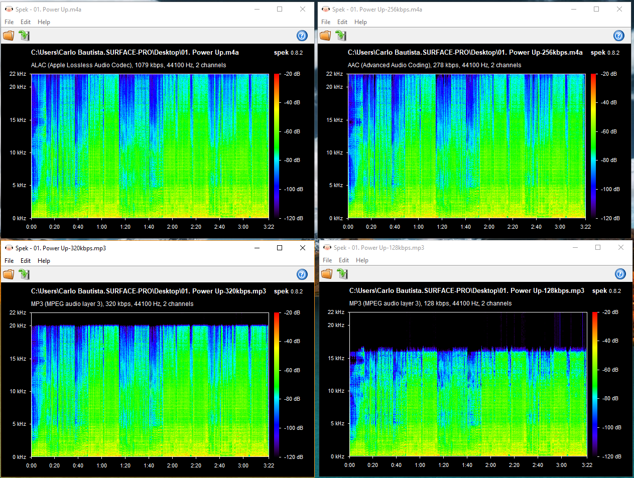

BTW, here are the 128 kbps mp3 spectrum. You can see the 20 KHz limitation of the 320 kbps mp3 (Google Play, 256 Kbps mp3 for Amazon Music) compared to AAC LC 256 kbps (Apple Music format) and Apple Lossless format

Wow, even the 320kbps mp3 looks worse when compared to AAC 256kbps. You can clearly see it gets cut off above 20kHz freq like you mentioned.
These charts clearly shows everything. That is an awesome way to analyze and compare the difference. Thank you so much for doing this. I really appreciate it. 🙂

Wow, even the 320kbps mp3 looks worse when compared to AAC 256kbps. You can clearly see it gets cut off above 20kHz freq as you mentioned. 🙂
Yes but very few humans can hear a 20KHz tone.
There is an argument that the sound might even be better if the highest frequency is cut lower. We are talking about COMPRESSED audio. Given that the bit rate is fixed what you have is a zero-sum game. In other words, if you put one thing in the file then something else has to be removed because the table number of bits is fixed.
So in order to put in a few KHz of bandwidth what did they remove? Did they remove a dynamic range in the bass? We don't know.
So the logic goes that it is reasonable to remove something you can't possibly hear if it allows room to add more of what you can hear. And we can be sure you are NOT able to hear above 20KHz.
All that said the AAC generally sounds better because they use better compression and can fit more in.
Also if you are listening using the built-in speakers and Bluetooth and so on it hardly matters. You'd need some high-end equipment, to notice But "high end" need not cost a lot. Using just a pair of $125 AKG K240 headphones plugged into a MacBook Pro is reasonably high end and if you add a good quality external audio interface you have "studio quality."
Pro-audio gear is generally less expensive than high-end consumer gear -- consumers are gullible, professional engineers aren't. So if you want to take advantage of higher quality audio files, it wil not cost of an arm and a legto buy pro level gear
Again, I just wanted to make the point that higher upper bandwidth might even make a compressed recording soubd worse. With compression is always a trade off, what to keep and what to toss out. The compression software tries to keep the part of the sound we notice the most and chuck-out what we will not miss.
