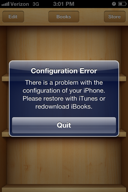

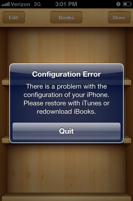

I'm having an issue with iBooks.
Below is the error I'm getting.
I've tried ibooks fix for iOS 5 from xsellize and ibooks fix2 from insanelyi and Books still doesn't work on iPhone 4 5.0.1 jailbreaked untethered with latest redsn0w 0.9.10.

Restarting after using fix2 worked for me.
I'm trying with all the patches out there but nothing is working. Come on, this is one of the most important apps for the iPads and iPhones!
Okay, i got it, maybe i was lucky, but i got it.
0. Delete iBooks and/or every other patch/patches on your iDevice.
1. Install a clean iBooks from the App Store and then restart your phone.
2. Install the iBooks Fix2 from the insanely repository.
3. Respring the iDevice.
4. The Springboard now should crash and go in safe mode (i don't know why, but the only time it crashed and went in safe mode it worked for me), so if it doesn't crash go in safe mode.
5. Restart the phone.
6. Now iBooks will work (at least it worked for me).
