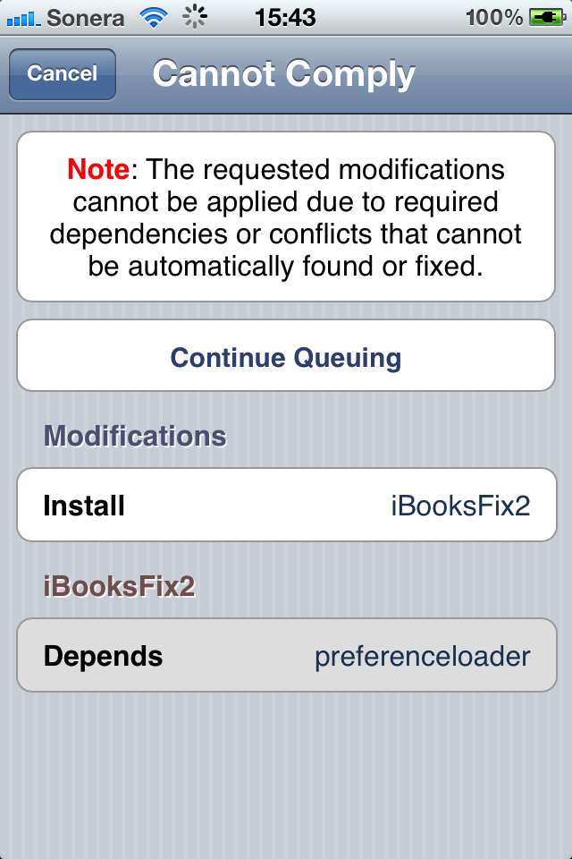

I've upgraded to the new beta of Redsn0w, iBooks is still not working.
That's why iBooksFix2 is not working:
I think we have to wait a few hours, because now there is a lot of traffic on Cydia and currently the preference loader is unavailable...
this is the problem I have.
