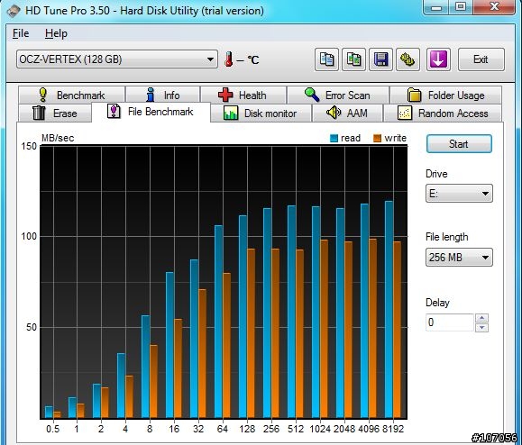

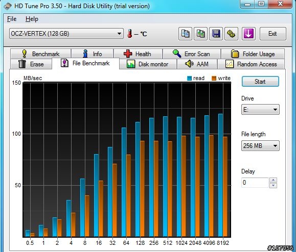

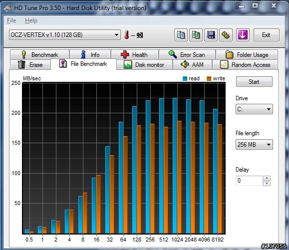

Well...I guess from my data....it shows the new MBP" is capped, when under windows 7 compare to the older MB 13"
I used the same windows 7 disc to install.....I thought that was already pretty convincing that they did cap it at Sata 1.5...

Benchmarks for the OCZ Vertex showed that every file above 64Kb is capped. Surely during booting one of the files read is larger than 64Kb.
I am willing to believe the difference is small, but I find it hard to believe it's 0,0%.
I strongly doubt that.

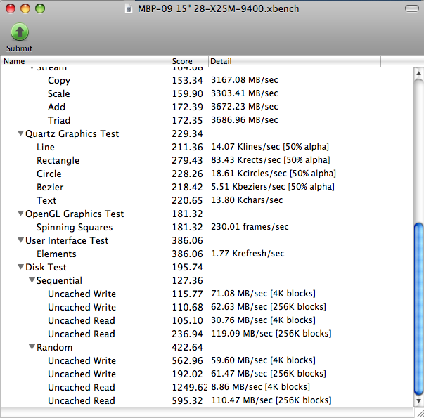

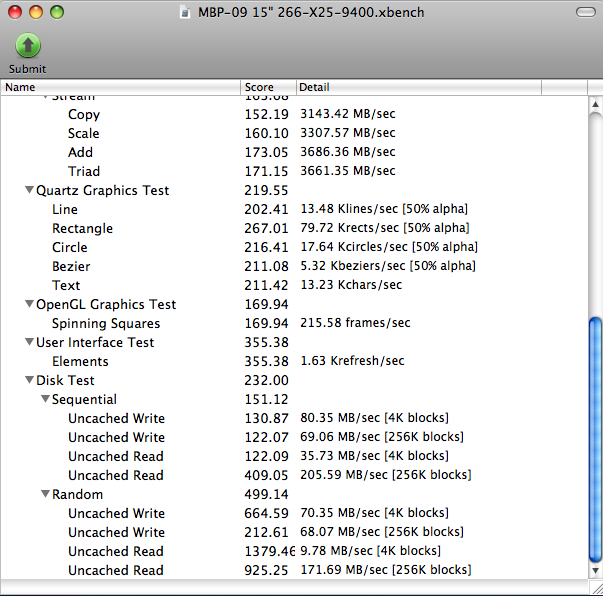

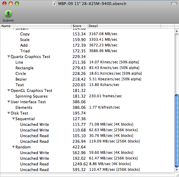

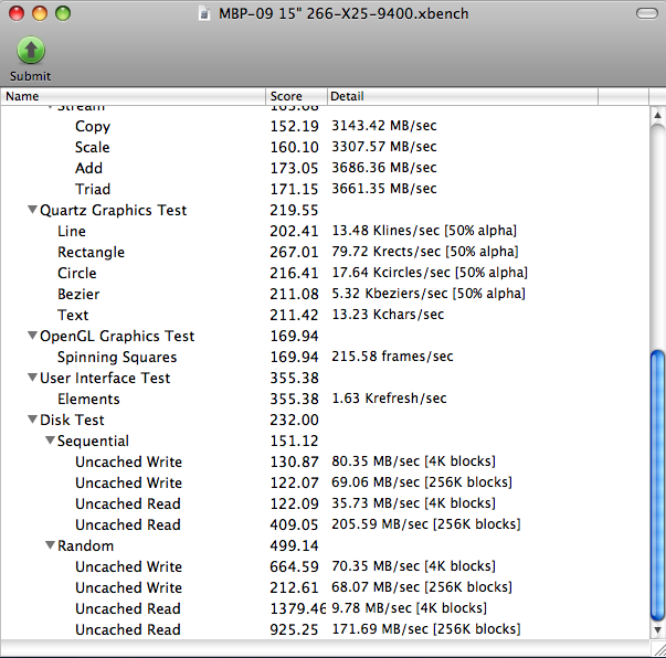

Sorry, don't believe me if you want. But the issue is not sequential read speed, it's random read speed. This doesn't go fast enough even on an Intel X25 to make a difference. Believe benchmarks over real world data if you want but I have it in my hands. You said you wanted someone to measure it. I did. The difference is too small to measure without a stopwatch (i.e. less than a second). In normal usage, the difference is also too small to see.
