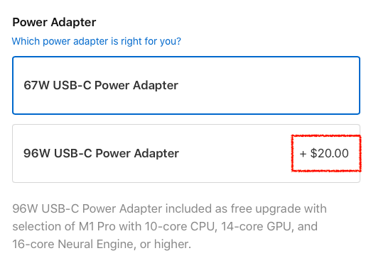

I tried to add the 96W power supply to my order, but it added 2 weeks to the delivery date. I don’t really need to fast charge, so I reverted back to the 67W option.

So can I not fast charge with the base 14 inch model I bought? (since it only comes with the 67W)
you could choose to get the 96W charger:
Or you can choose the 96W USB-C Power Adapter, which lets you take advantage of
fast charging, so you can go from O to 50 per cent charge in around 30 minutes.
Yea I already submitted my order and they can't change it without disrupting the delivery - I'll figure something out or get another charger.
Thanks for clarification. I am going to see if I can update my order.
Just to be clear, the 96 watt adaptor is the same included w/ the 16 MBP - it's rather large. The included 67 watt is a new model which I'd prefer to have for packaging reasons.
Personally I rarely use the charger that came w/ my 16" MBP due to this, instead opting for an aftermarket 100 watt gan 2 port charger that is much smaller - think it was only $40 purchased a couple years back... much rather put my $20 into another one of those.
Appreciate the advice. I was looking at some of the aftermarket chargers that were available at 100W and figured I could just grab one of those after the fact. This will be a shared computer between my wife and I so we'll each need a charger at our desk - she has a larger USB Mac charger already, I'll use the 67W at my desk, and likely just grab a 100W for travel.

You need to pay the $20 extra to upgrade to the 96W MagSafe Power Brick to "fast charge". But, you can fast charge using MagSafe on the 14", unless I'm mistaken.
The MagSafe plugs into the USB-C Power adapter, so you would need at least a 96W Power Adapter to get Fast-Charging(96W for the 14", 140W for the 16"). USB-C into the Laptop will charge at max USB-C rating (100W) on both machines, but isn't high enough wattage for the 16" to be considered Fast Charging, (Bigger battery, takes longer to get to 50%)
