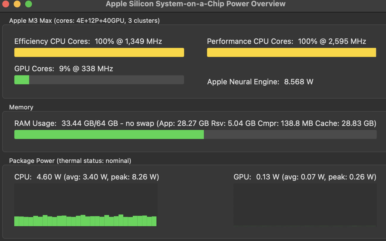

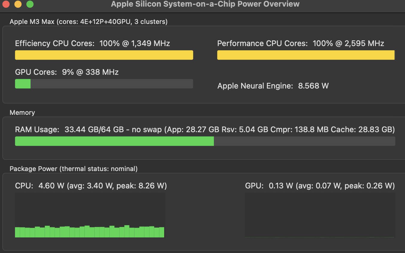

I have the 14" M3 Max 16/40 64gb 1TB and i can confirm the fan noise and boy the heat being pushed out. I was rendering a small clip in topaz AI and the idle temp is 40'c with 0 RPM and after 10-20 seconds, the temp pushes to 70'c with fans at 5k rpm or more like a jet engine. the laptop was on my lap and i had to lift the laptop up and it was like hot hot under. I waited for render to finish and temp went down faster than the fans. I did see Luke Miani do the test on his youtube channel and confirmed the same with the fan noise. I am wondering if 16" is better with fan and temp management. I also am sitting on couch and doing some editing etc and if the fans kick up like that all the time, its going to be annoying.
I don't know about the prior models and if any fan/heat issues occurred since I'm jumping from my m1 mbp to this 14" m3 max. So this is new to me.
Have you tried low power mode? Does that make it quieter?
Doing it now and seems to be quite with temp at 55'c and no fans for while and then fans went to 2400 rmp but no noise. It took the 20 sec clip 4.5 minutes to complete. I ran a temp monitor and it seems the GPU was never used or was very low in utilization.
With higher power mode, the clip took 2 min to render and can confirm again the fan ramp up at the end at 5k with temp at 55-60'c. Also, power monitor does show gpu being used a bit fluctuating between 28-40%. Could be the app itself for this example.
I left the On Battery and On Power adapter to automatic for now and work on some other tasks tomorrow.
