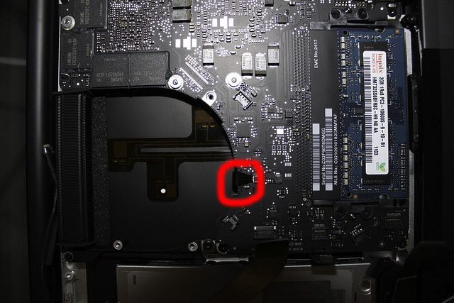

That was another MR member who went ahead and re-appled the TC, which is not covered under the first post. For your reference, the highlighted area below is what you should not touch:
There's also one under the speaker:

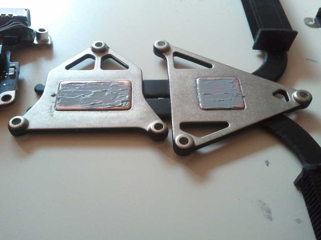

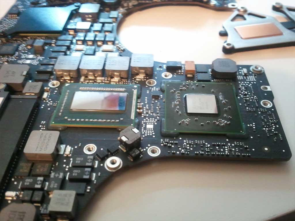

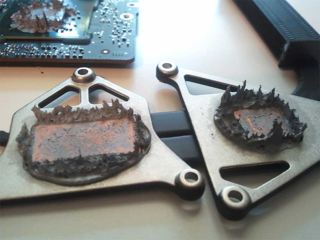

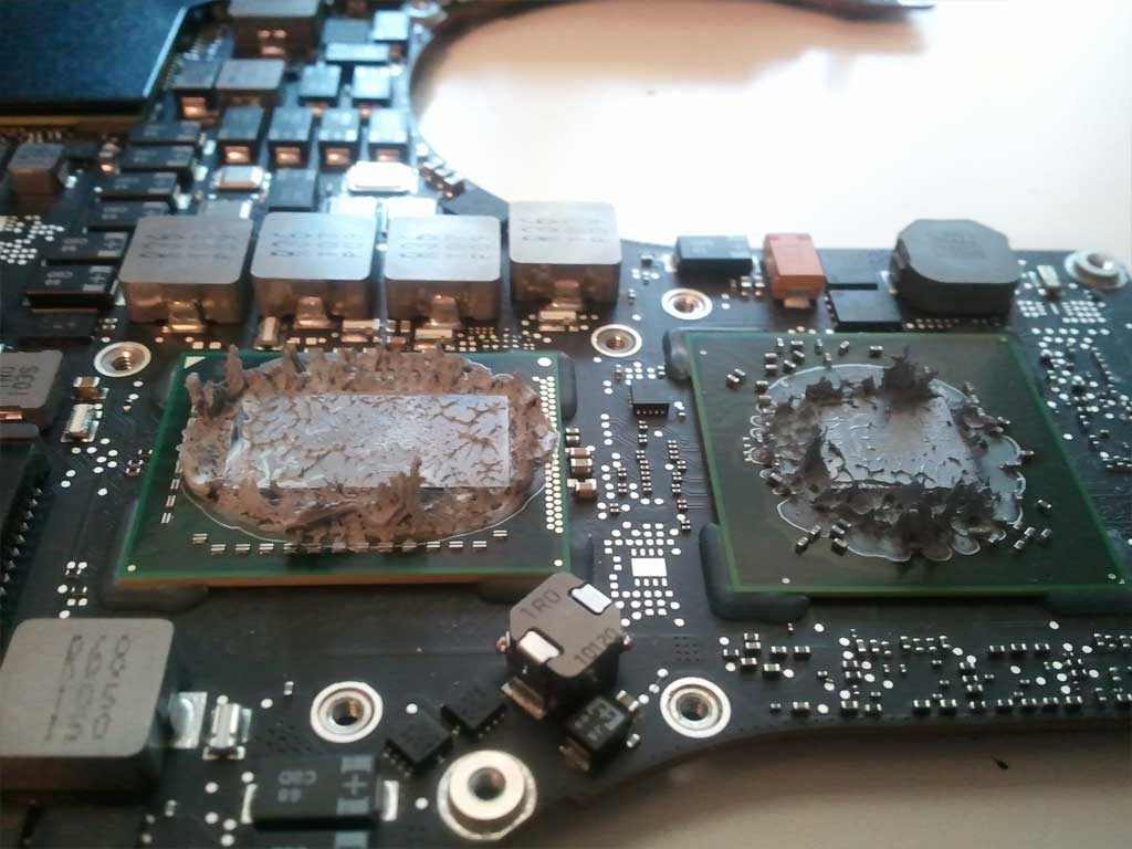

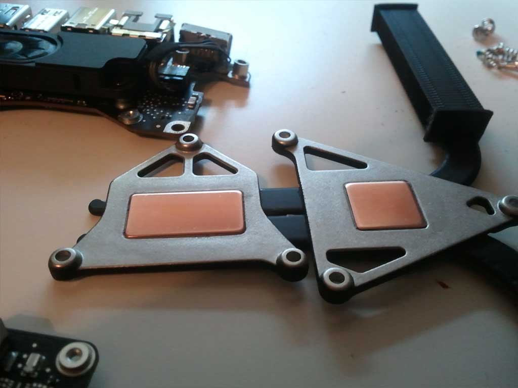

From 98C to 73C Overnight

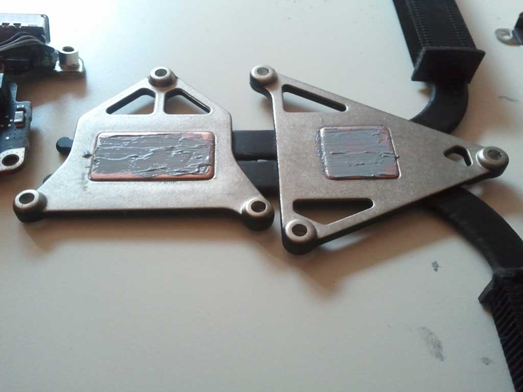

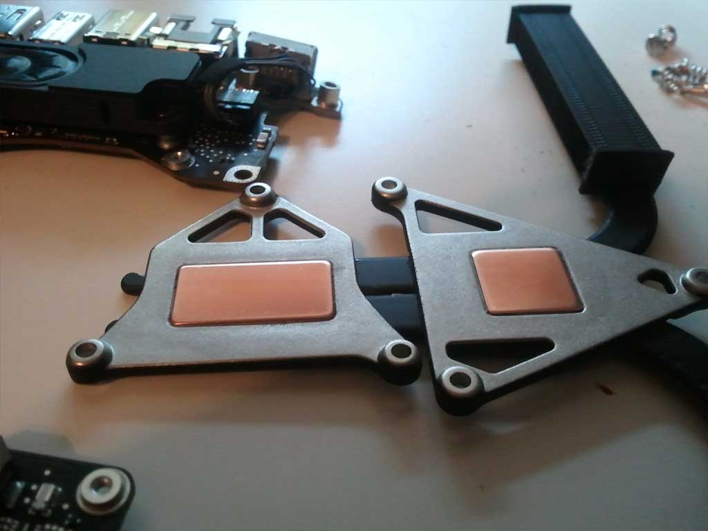

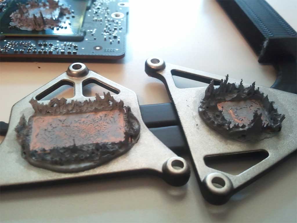

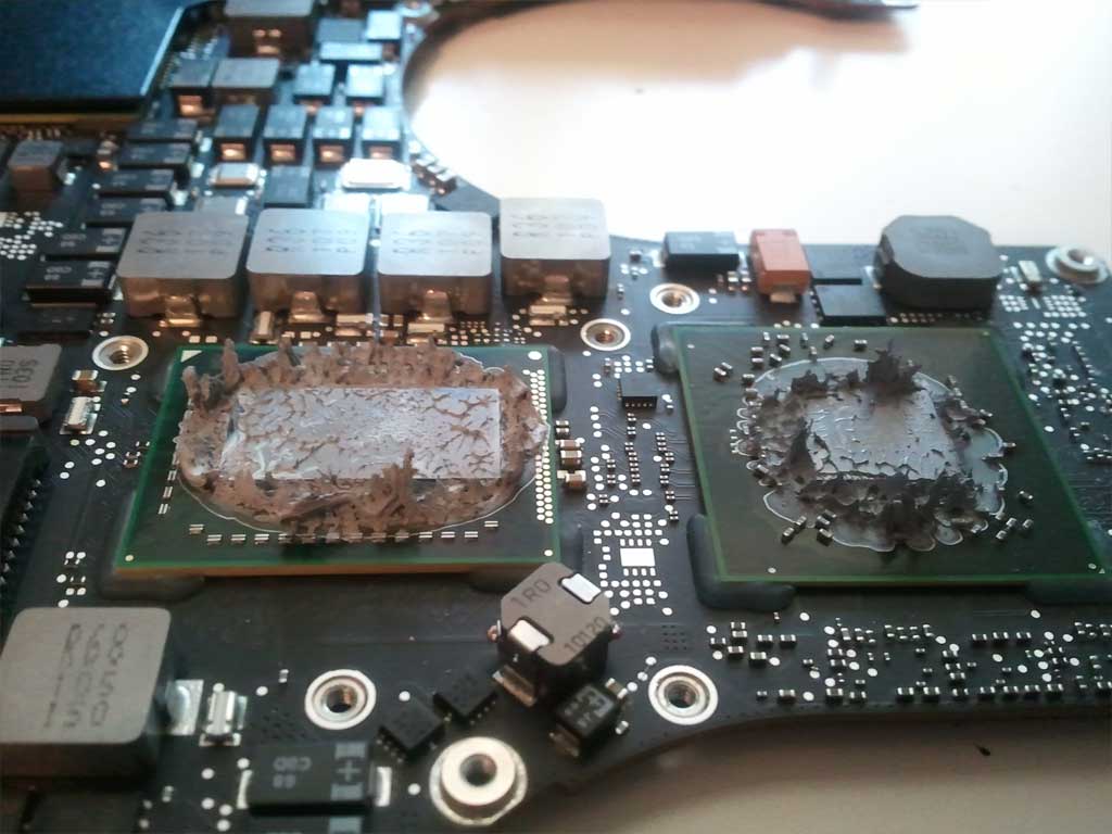

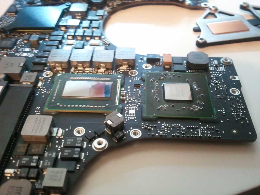

Hi guys,
just wanted to share my success story and recommend that everyone check their thermal paste if they have temperature issues and don't want to send it back to apple.
I've had my 2011 15" MBP for about a week now. I noticed crazy high temps near 90C under load and 98C under full load with CPU Test (8 Threads x 10 minutes).
So I took apart my new baby and oh my gosh... I have never seen so much thermal paste on one computer. they used enough for at 5+ applications.
anyways I cleaned everything off and reapplied some Arctic MX-2, not the easiest stuff to work with, my application on the CPU side was still a bit heavy.
so after a fresh test of CPU Test (8 Threads x 10 minutes) my temperatures got to a max of 77C and stabilized at 73C. I should say that before each test I set the fans to max and let them cool the CPU to around 42C, and left them on max during the test. that's a real 20C drop under full load. but then I had crazy amounts of thermal paste everywhere.
I'm very happy now to say the least.
-oh, and about half of the screws holding the motherboard in were crooked... seriously I'm disappointed. no real damage though.
That looks awful
I certainly agree, mine was very similar. I wish I would have taken some pictures, but honestly I was so focused on not making a mistake, or damaging anything (even though I've done each of my prior MBP's ) it's still very nerve wracking.

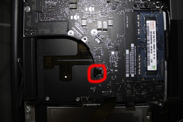

I'm not exactly sure but this one right at the fan has my attention. I just reapplied my thermal paste today on my replacement 15 inch. Really need to ground yourself. No kidding static mat run a wire to your outside main water line the ground going into the ground. I ran a 30 ft bell wire over connected to my mat. Worked a charm. I realize i just scared the **** out of everyone but I'm not kidding make sure your grounded and i wore static gloves today just for extra security. Noticed I said this is a my second MBP. 😀
