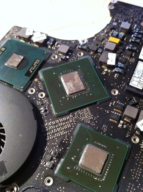

So I took apart my new baby and oh my gosh... I have never seen so much thermal paste on one computer. they used enough for at 5+ applications.
OMG!!! 😱 😱 😱
That's an INSANE amount of thermal paste. Plus all the misaligned screws... they must have monkeys in the production line putting things together. Big shame on the production process. 😡
I've redone thermal paste too. I had the same excessive amount of compound as in the photo in the previous post. I used Coollaboratory Liquid Ultra, and my themps are:

I've seen my new 15" 2.2 hit 90+ under load with the stock thermal paste.

Now I must say when I opened things up it was no where near as bad as the pictures i've seen or what others have said. Guess I just got lucky, nonetheless I did clean up the excess amount and reapplied some paste. Pictures below. If you're wondering why I didn't remove the left fan, well lets just say that one screw really hated me and decide to strip its self 😉
