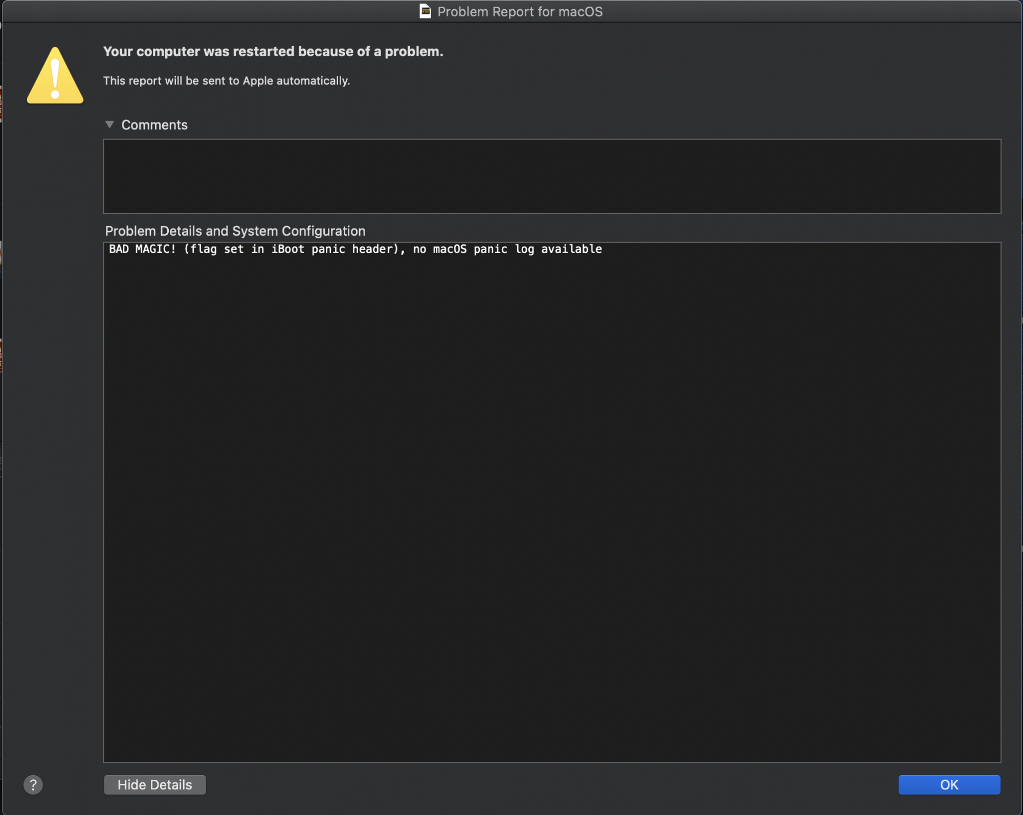

A lot of people are beginning to have GPU Panics on their machines similar to the following:
Code:
panic(cpu 0 caller 0xffffff7f8a3d1a97): GPU Panic: mux-regs 4 3 3f 1f 0 0 severity 3 WS-ready
1 switch-state 0 IG FBs 1 EG FBs 0:0 power-state 4 3D idle HDA idle system-state 2 power-level 5:0
power-retry 0:0 connect-change 0 : PowerPlay Failed Resume.
It seems to happen when running graphic intensive applications or when awaking from sleep with regard to the AMD processor. There is intermittent freezing of the screen as well. It starts slowly, perhaps a few times a week, then slowly progresses to multiple times per day. Folks have been advocated by Apple Engineering to try with a clean OS and nothing installed. However it appears that it still occurs. Most of those who got new machines no longer have the problem.
There are a couple of threads over in the Apple forums on the subject, with posts getting deleted by Apple for mentioning "cold solder joints". Maybe a nerve was hit. The slow creep of this getting worse and by people using the GPU heavily which creates heat would certainly be a culprit as it will worsen over time as the board heats and cools.
Has anyone else been seeing this problem? Its becoming fairly widespread.

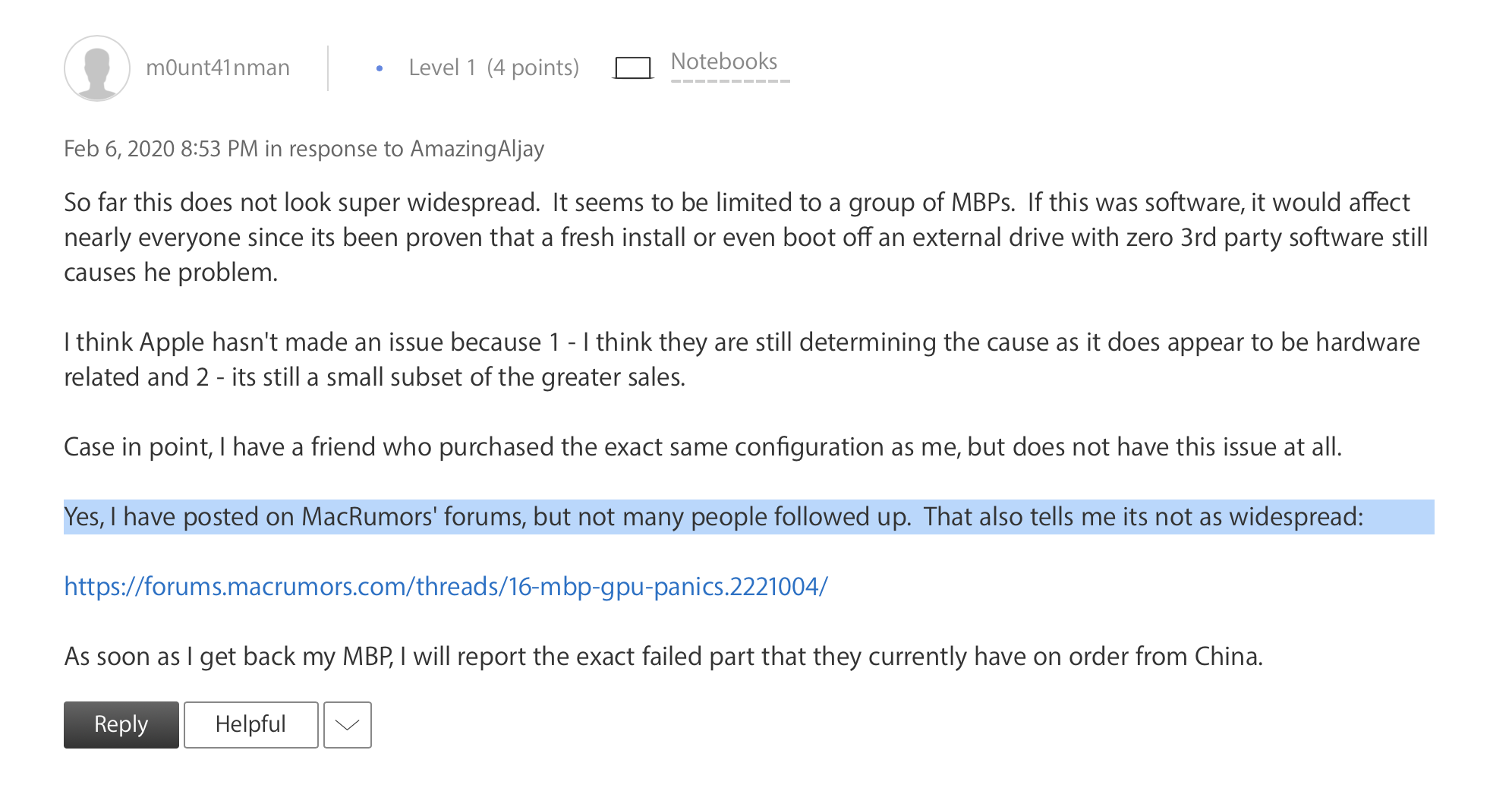

Your exact post there appears to state:
"Yes, I have posted on MacRumors' forums, but not many people followed up. That also tells me its not as widespread"
Why does this "deserve some press" if it's not widespread by your own conclusion?
How is it a "serious problem" if it's not widespread?
And those "I have this question too" numbers are artificially inflated and do not correlate to people who also are experiencing this issue.
