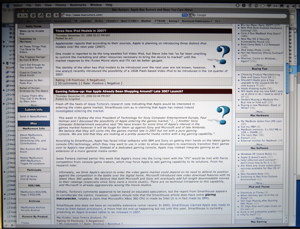

Just opened up my new 2.33 MBP glossy screen. It looks amazing. For a second I thought maybe they forgot to give me the glossy because I couldn't see any reflections.

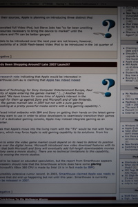

Also there is an obvious phenomenon when display the picture, when switch to full screen mode, you can see the phenomenon just like the wind blow the face of water.

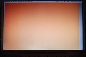

The banding issue is as described my many here. I can resolve it to a large extent by using a different color profile. But that is not what i paid for.
Far more annoying though is the light bleed and viewing angle.
I am average height, 5'9", and I cannot get the display angled enough for me to sit in an good ergonomic position. It just wont tilt enough.
If I move my head even an inch the whole screen color and brightness changes dramatically so I am forever changing the screen angle.
The light bleed from the bottom is unbelievable and as a graphic designer completely ruins the machine for me.
It looks like I have a neon strip running along the bottom of the screen.
But the worst thing is the way the color changes from top to bottom. I hope you can see this from the enclosed unretouched photos.

I got mine yesterday (17" mbp), first time i booted it i was like, damn.. light was flowing in very unevenly from the bottom, then i looked at the center of the screen and i saw a single black dead pixel.. i was 😡
Then i thought well **** it i might as well see if its okay.. when i came home, booted it again, the backlighting in the bottom was nearly gone, and i then tried to touch the dead pixel, it was just dirt... D'oh!
I then tried the gamut thingy and the other test in here, no banding whatsoever... its perfect..! the only place i see a tiny amount of banding is when i use iTunes, the white circular gradient while browsing album art that isnt downloaded yet, but its such a tiny amount that i dont really care hehe.. this mbp is so awesome, its quiet, cool, and well.. its a mac =)
