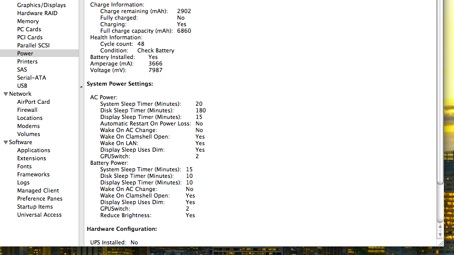

Today, I noticed something went terribly wrong with my Unibody MacBook Pro.
Before, my battery had a charge of 13,000. It had been like this for 3 months. Then today, its total charge went down to a mere 6800. I checked system profiler and it says "Check Battery".
What should I do now? What is causing its strange behavior?? Please help me..
Before:
After:

The same as System Profiler... By calibrating the battery, you mean completely draining it and then completely recharging it again right?
I guess I meant does it only run for half the time or are you just concerned because of the data change?
Now it charges twice as fast and depletes twice as fast.. This happened very recently, like 40 minutes ago... Before that, it was still normal...
Also, in system profiler, it says "Check Battery"... This is very concerning..

I am currently charging it back to 100%.. It is weird.. Usually it takes more than 2 hours to charge from 30% to 100%.. Now, it is a mere 1:02 hours... What the heck...

I had the exact same problem where full charge capacity would drop to about 1/2 of what it should be. Went to my local Apple Store. The mentioned there was a small batch that had this very issue and they simply swapped the battery on the spot. Since then, it has been solid. I am at 99% health after many charge cycles.

My battery went bad just last week, after 11 months of usage (system profiler also said 'Check Battery'). It was still under the 1 year warranty, so I got it replaced at the local Apple store relatively hassle-free. Since you've only had the thing for 2 months, I suggest you just make an appointment to see one of their Genius monkeys. They have a test that they run off an ipod to check for defective batteries.

The battery is not technically "user-replaceable" but that doesn't mean it can't be replaced. Simply removing the bottom cover reveals the battery and almost every other component in the system. The non-removable aspect of it simply means you can't swap batteries on the fly like you could with most other laptops. The Apple Store will do the swap for you since it is covered under Apple Care.
Alright, if by tomorrow this problem still persists, I will bring it to the nearest Apple store on Friday..
I bought this on eBay and it is Brand New with every thing still sealed.. I also checked online for its warranty by inputting the serial number and it turns out to be valid till 2010.. This mean I can still bring it to the Apple Store and get it repaired right?
