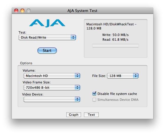

OP, I'm running the same drive and here are the speeds I'm getting:

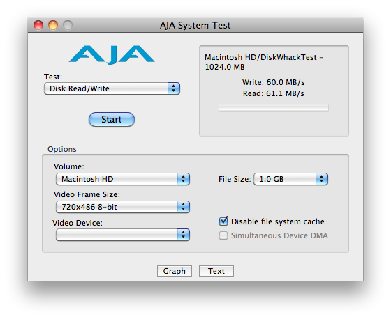

And it's not sluggish or anything?? An I didthe test using 1GB instead of 128MB..
I'd like to think I got 2 lemons in a row but at this point I'm debating getting a 500 gb 7200rpm drive...
Nope, it's actually been a very quiet, fast, reliable drive. Here's the results of the test @ 1 GB:
