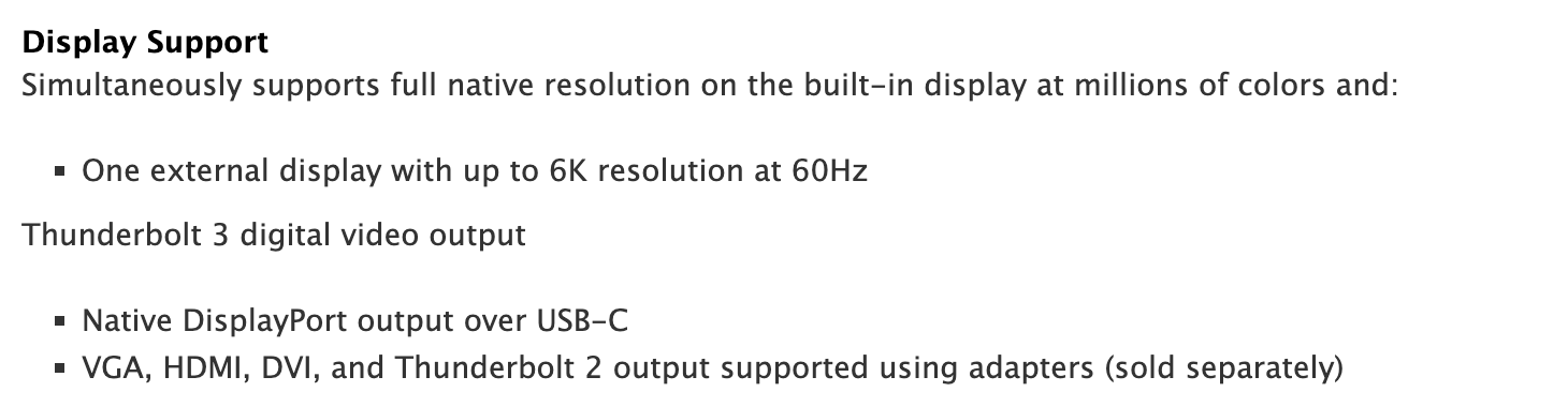

I think you're referring to the wrong model. This is what I see under the 2020 M1 MacBook Pro, or do you have an Intel model? It would be very helpful if you could post the About This Mac page or the model ID of your MBP.
Well I gave this link in the original post (which points to an intel. I never have mentioned a M1 or M2):
This is for a MacBook Pro 2020 (NOT M1) that can indeed support two external displays.
Yes, but only 1 5k display:
