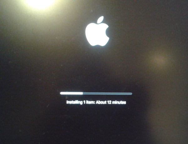

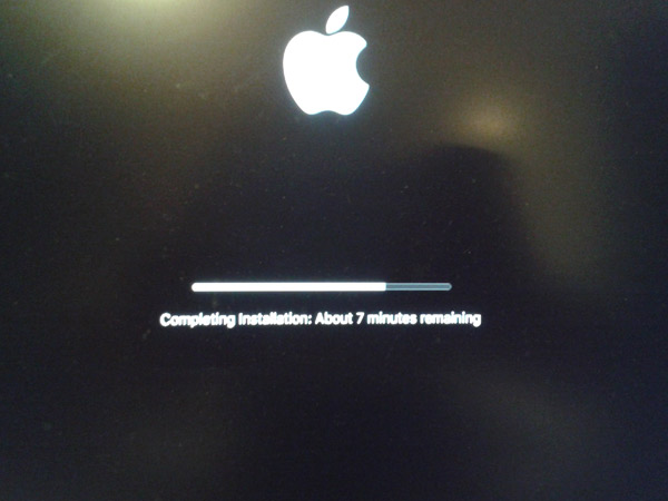

I don't know how relevant this might be, but it appears as if the El Capitan DP2 (or maybe even DP1) has a boot.efi in place that I haven't seen before, whereby Software Update messages (or may be other processes as well) are displayed, such as "Installing Software Update: About 20 minutes". I've seen this while updating my Fusion VM of El Capitan to DP2. Naturally, it uses the stock boot.efi, not Pike's. I wonder how Pike's boot.efi would behave trying to display such a message, supposing it is able to do such a thing. Any suggestions?
Edit: Just to be on the safe side, I've just got in touch with Pike in case he is able to do something about it (supposing such a thing is pertinent).
Peter, it displays messages just fine (see attachments). I installed only one update, without Recovery and Epson s**t, so it says what you see. DP2 replaces the boot.efi, so I had to replace it again manually in the middle of update process. Next it completed installation without issues. Pike's boot.efi still works as it should.
