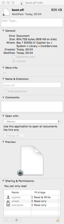

HI, I'm trying to update to 10.11.2. I have run the updater from the App Store on a spare copy of my HD. When it failed to re-boot I booted into the recovery partition and turned off SIP. I then booted into another partition (running El Capitan). I was able to change the Boot EFi in usr/standalone and the one in the recovery partition, but when I try to replace the one in System/Library/Core Services it is locked and I cannot delete it. The locked box is greyed out and I cannot alter it. If I try to give myself read/write permissions for the Boot Efi I am told I don't have permission to do that! I have also tried booting into an old Tiger partition and I still cannot replace the file from there
I would be very grateful for any advice on where to go. Luckily I am working on a clone of my system drive so nothing is broken irrevocably!
Thanks
Robin.

Thanks, I think this is my problem as well. I can't unlock the boot efi in System/Library/CoreServices on my updated 10.11.2 system even with SIPP turned off.
I will wait patiently to hear of the workaround as currently I can't use the updated system!
Strange that some people seem not to have had this issue though, it clearly is not consistent?

I downloaded the el capitan boot.efi from pikes page but not getting the checker to work. It says to put :
openssl md5 boot.efi = 036476dc081da904f50736eb56acbcfa
Into a terminal but I get get: "no such file or directory" No matter changing to that directory or using the files path
You need to make sure that you are in the same directly as that file in order for the command to work. Might I suggest you try this, in terminal type the following: openssl md5 boot.efi then press the space bar to ensure you have at least one space after the "i". Next drag the boot.efi file and drop it on the the terminal window. This will put the full path to the file. Next press enter.
Reactions: iMattux
Tried your suggestion and it still said "no such file or directory" but it did show the checker and its good.
Thank you
Had been trying use the el capitan boot.efi anyway and was getting a crash every 2 minutes. Was worse if trying to use the app store updates. Maybe the 12 gb ram min is still needed for now? anyway went back to yose and its good for now I guess.
Thank you
Sorry to hear that didn't work. If you wouldn't mind sharing can you copy and paste the whole line you are trying to run in Terminal?
openssl md5 boot.efi /Users/lysanderlenihan/Downloads/boot.efi
boot.efi: No such file or directory
MD5(/Users/lysanderlenihan/Downloads/boot.efi)= 036476dc081da904f50736eb56acbcfa
so worked but not sure what error is
no openssl probably...
