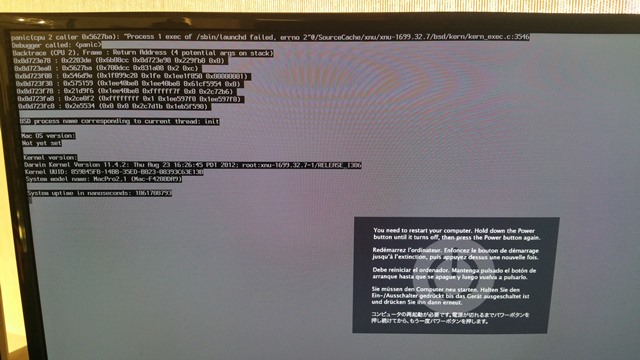

Even with the boot.efi in both standalone and coreservices, cleared the boot plist. I boot to the drive and get a kernel panic. Any thoughts?
Hello hkbladelawkhk,
Lots of users have reported random kernel panics (KPs) with El Capitan installs. In all cases that I know of, those users have reported that they still have original 512Mb memory sticks installed. We have advised everyone to buy new memory of at least 2Gb per sticks and replace their memory. Buy as much as you can afford.
In all known cases, once the 512Mb sticks have been removed and replaced, the system has stabilised.
Alternatively, using a pre-built disk image as your install method may also be contributing. I'm biased of course because I'm the author of the pikify3.1 installation method (page 56, post 1390).... You might consider reinstalling using the pikify3.1 method....
If you still get KPs, then it is almost certainly RAM that is your issue.

MY Mac Pro 2,1 with nvidia Geforce GT120 is running 10.11.1 and randomly reboots. Does not happen when running Lion, Any ideas?
