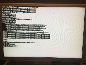

I created the install media with the latest Pikefy and when I start booting the install disk, I get a kernel panic. Screen shot attached. Any suggestions?
Thanks
16GB, all 2GB DIMMS
The text in your screenshot seems to point towards a problem with a firewire device. Disconnect all your peripherals except mouse, kb, monitor. Especially disconnect the firewire devices....
If you built the installer on an external firewire disk. Use Disk Utility and run first aid on the whole disk as well as any and all partitions. Consider a complete reformat of the firewire disk (that you put the installer on)...
Thanks for the suggestions, I will disconnect the firewire device (it's an audio device). I put the installer on a USB drive but looks like I need to rebuild it anyway with a newer version of the installer.
