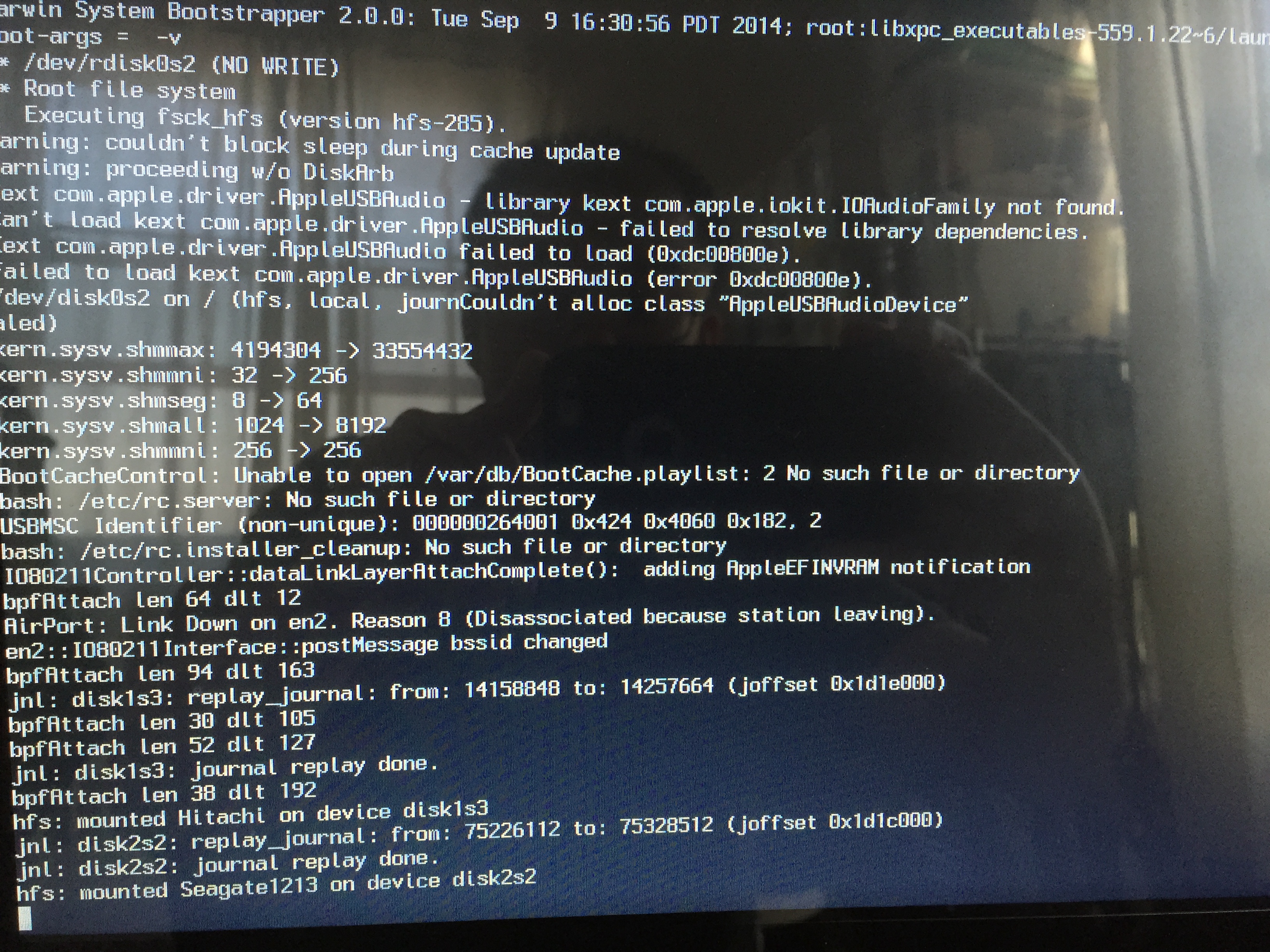

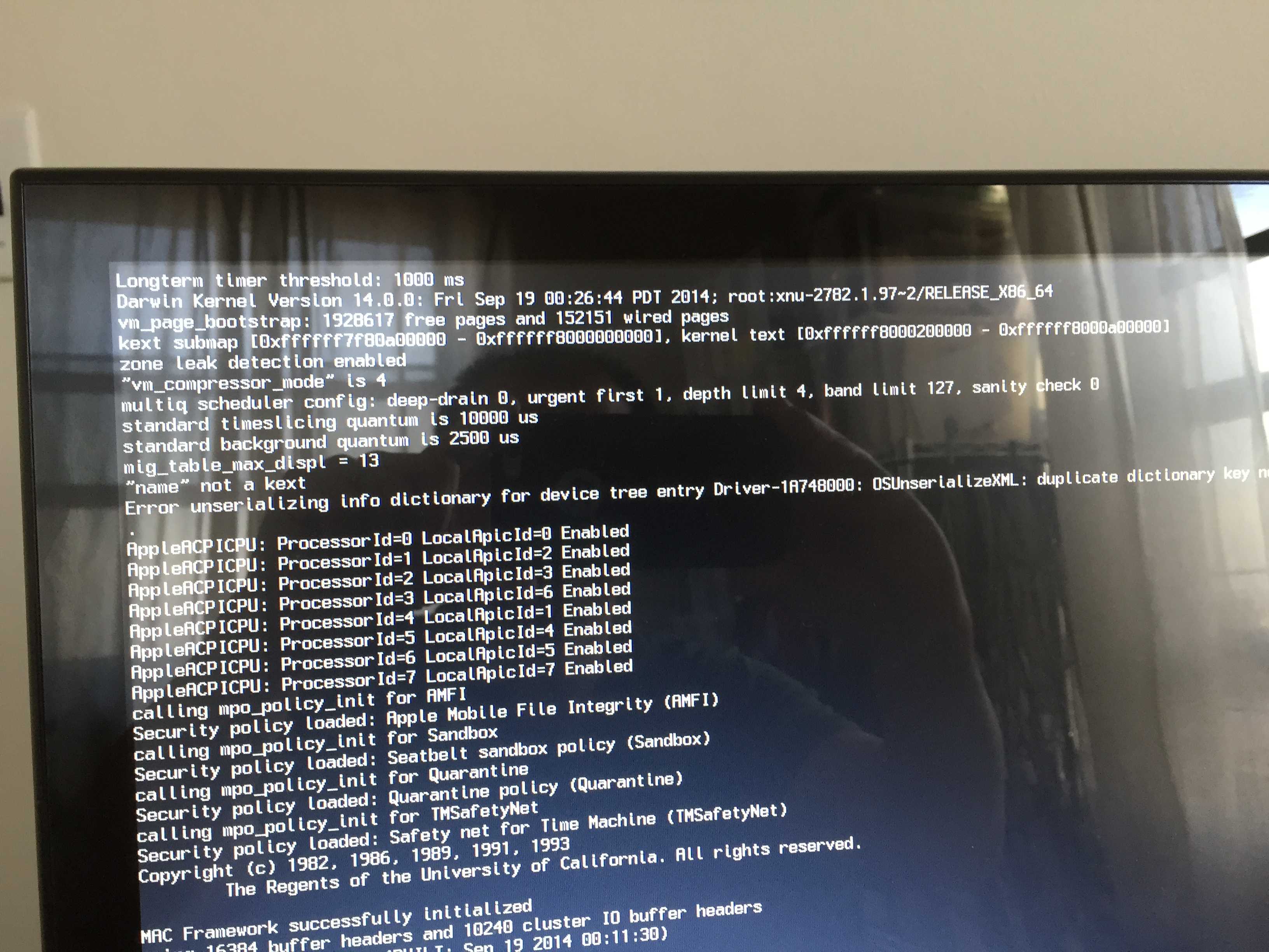

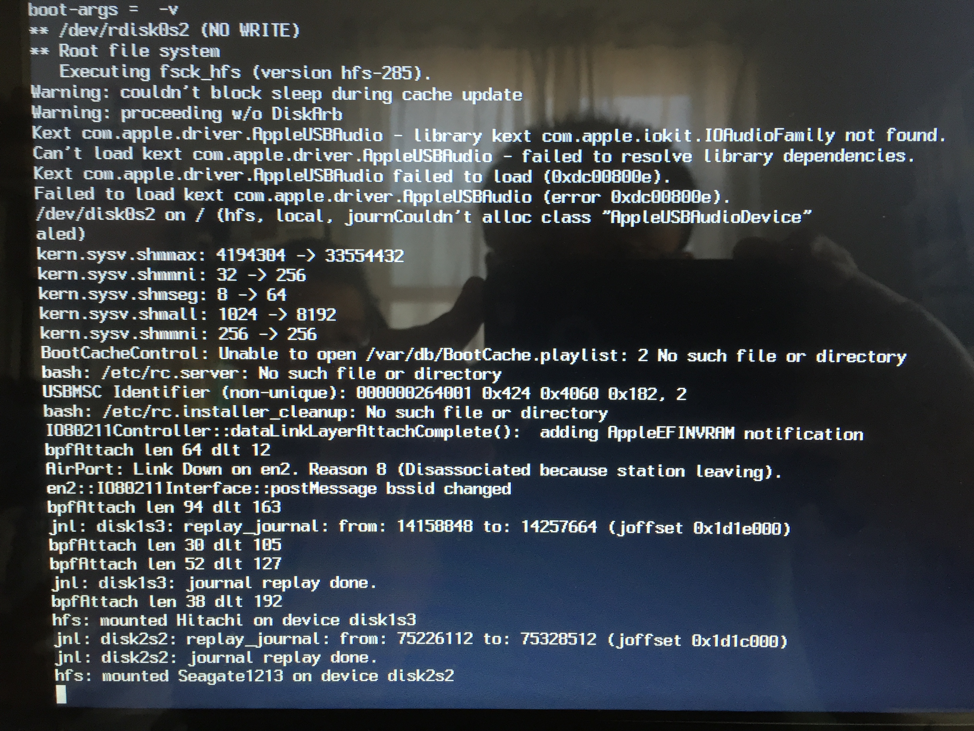

I was able to replicate the issue by zapping the NVRAM (command option P+R) twice and which caused the volume to hang at about 50%. (I had to boot off the USB key and rebuilt permissions/repaired the boot volume)
I got a couple of screenshots: Also a set of pictures of what I could grab on Flickr https://flic.kr/s/aHsk5sqbfy
One odd thing: I tried booting from a Carbon Copy Clone of the Drive I made last night and it exhibited the same issue it seems. (Granted the backup copy is on a rotational drive, but still moved very slowly.)
When I installed Yosemite, I upgraded the current volume--it was not a fresh install.

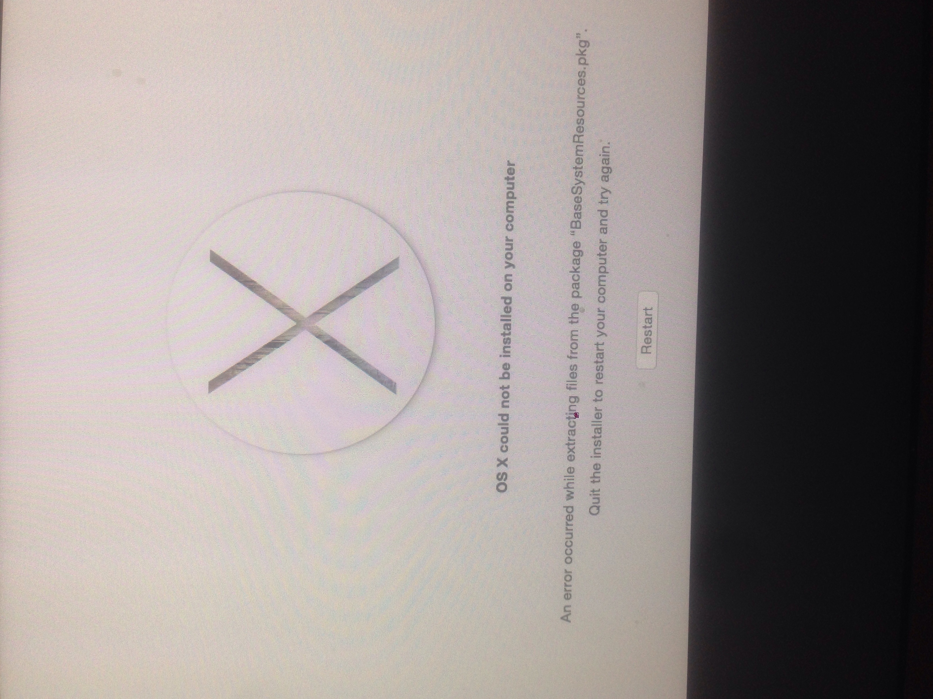

I have been able to get a bit further. Now I am getting an error occurring while extracting files from the basesystemresources.pkg causing me to restart. Could that .pkg be corrupt or something?
*update I went ahead and replaced the packages in the packages folder to see if that makes a difference.
**update it made no difference
***update I am downloading another Yosemite torrent to test out my theory on that specific basesystemresources.pkg in the installESD.dmg of the Yosemite installer I used. Replace both packages folder and the hidden basesystem.dmg which has its own basesystemresources.pkg that could also be also corrupt. Really I am just going through every single possibility with my scope of knowledge and experience.
****update That didn't work either. And I forgot to update my carbon copy of the Mavericks I was running.....YAY!
The basesystemresources.pkg is the wrong file. You need the BaseSystem.dmg, it's a hidden file in the root of the InstallESD.dmg. Let the Finder show hidden files first - see also Post #863 for this and further steps.
I did all that. This what is happening sorry for the orientation uploaded from my iPhone.
Maybe your downloaded Installer files or your created patched Installer are defective.
Try to install Mavericks in a Virtual Machine and download the Yosemite Installer therein from Apple's App-Store again.
Oh wow, I didn't know that would work in a VM. I will give that a try tomorrow thanks.
