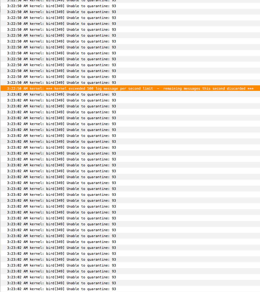

Odd Kernel Error
Did a fresh install on my MacPro 2,1 (upgraded 1,1) of the release version of 10.10 using the SFOTT beta. I now have an odd error filling up my log reading "kernel[0]: bird[349] Unable to quarantine: 93"
Also had to restart after the system locked up, once it rebooted it said there was a graphics error. All I had done up to this point was log into iCloud..
Otherwise the install was pretty flawless, I appreciate the effort everyone is putting into this and will keep updating with issues if more come up.

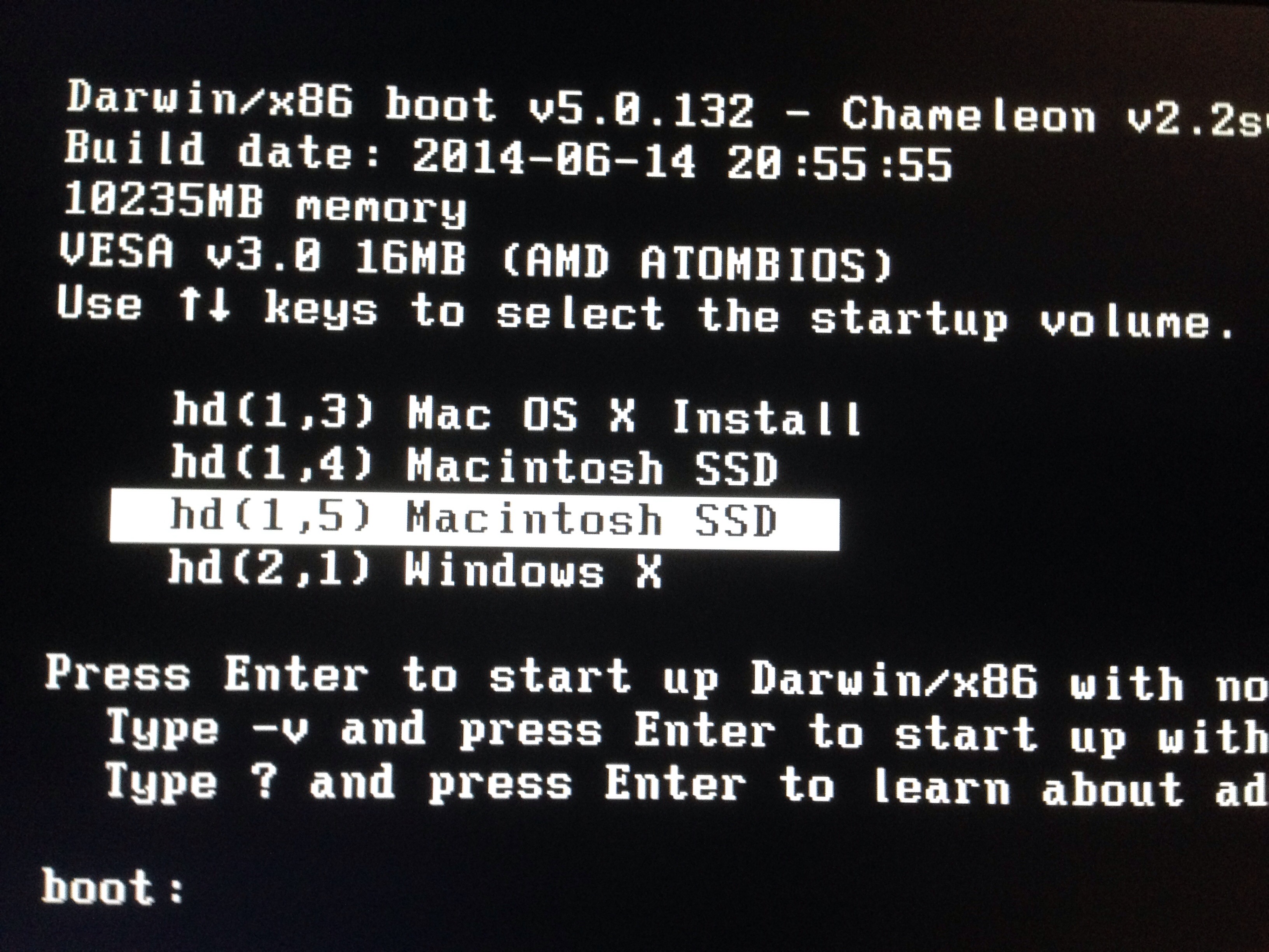

Did the Boot.efi_Method.
Macpro 1.1 apple ati 5770
All went smooth during installation on new partition.
A big thank 2 all of u people.!!!!
I am not sure but i think minors hickups occured.
I set up the mouse, and lost it after a while. The same with safari bookmarks. Change the look and after a while back to default.
Keep checking...
I was using chameleon to select at boot. I used to use system preferences to choose back with 10.4 to 10.7 and in windows bootcamp installed something similar
Yea I have done Chameleon and Clover. I prefer the native boot.efi method and I can still dual boot. I have a manually created Hybrid MBR with Yosemite and Windows 7 on the same disk. There is also a small partition that still has Clover installed in the middle of those.
