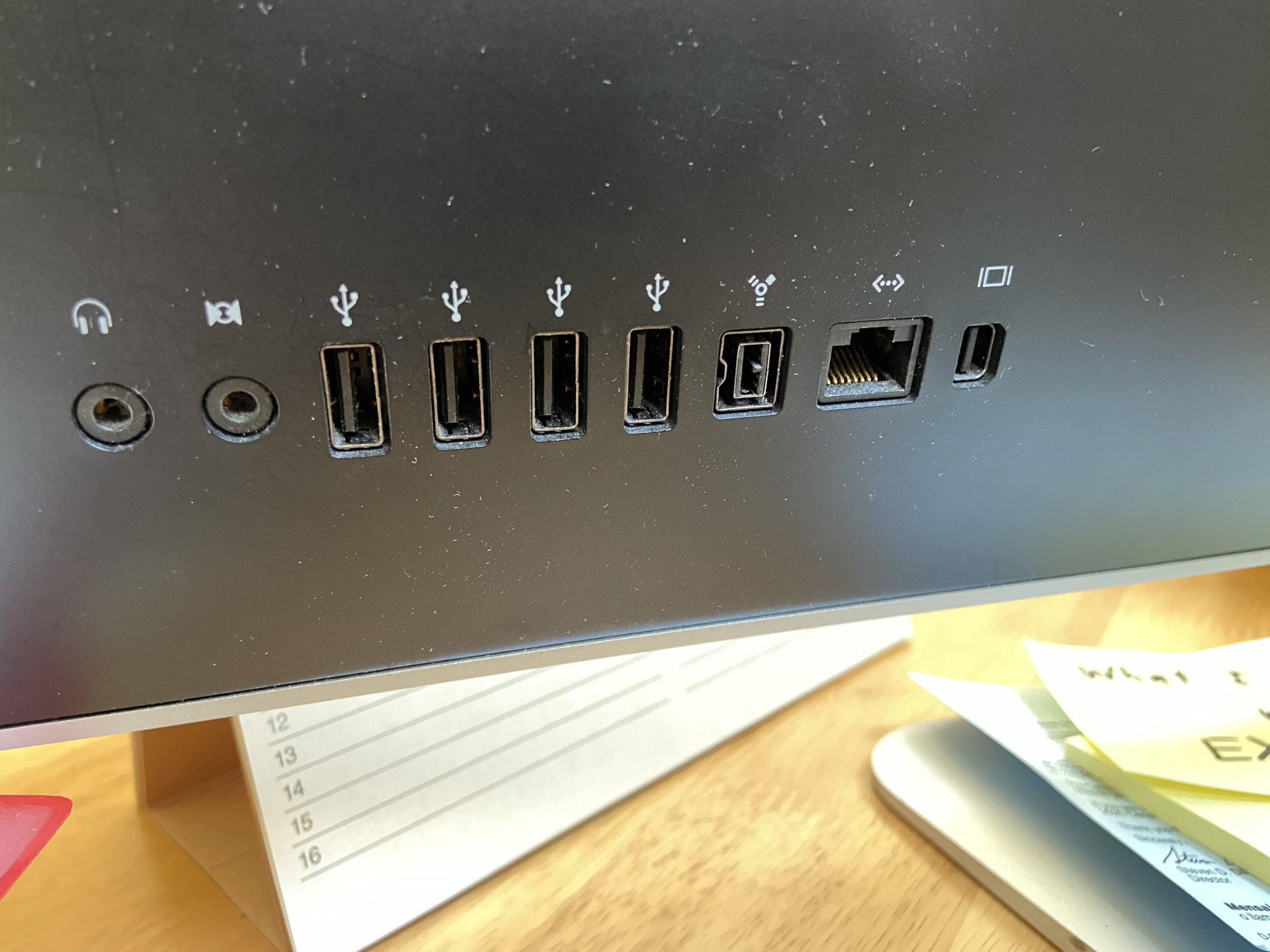

Hi, I am trying to determine if it’s even possible for me to turn my old 2009 iMac into a monitor. It was purchased mid 2009 and I believe it’s 22 or 24”. I checked the ports on the back of the machine and I’ve included a photo here. There appears to be what I think is called a “mini display port” on the far right.
I would like to use this iMac as a monitor to use with my new MacBook Pro or my Microsoft Surface tablet (if it’s possible). Can anyone confirm if this is possible? If so, I assume I’ll need to buy a mini display port cord (other end USB?), correct? Recommends on where to buy this would be helpful.

I don't think its supported on any iMacs of your generation.

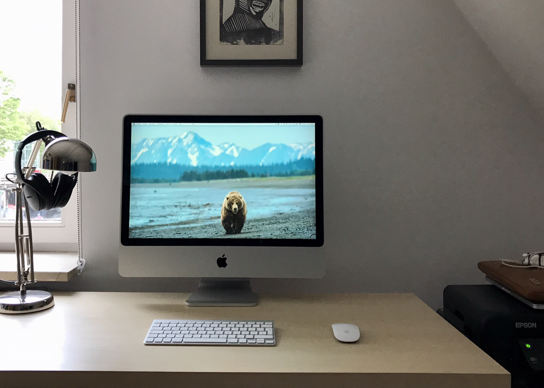

Here is a picture of my setup back then with my 2013 MBP retina running in clamshell mode. The monitor is still in use today as a ps4 display by my brother 🙂
The one advantage that the 24" iMac has over most new displays is that it's 1920x1200, not 1920x1080. In other words it's a 16:10 aspect ratio display instead of 16:9. You can find 1920x1200 monitors (e.g. Dell U2412M) but they aren't as dirt-cheap as 24 inch "1080p" 1920x1080 monitors.
Bottom line, still not worth the trouble unless the journey is the goal, or unless you have a sentimental attachment and can afford it.
