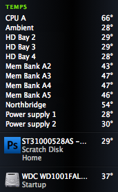

Hi guys, I have a 3 week old Quad 2.9 Mac Pro with ATI 4870. I have noticed the temp to get around 75C+ while CPU is 99-100% idle. I've noticed mostly when running itunes the temp will just keep climbing...fast! Within 3 min of running itunes my computer is at 65C (attached). When running Photoshop/Dreamweaver/Lightroom, the temp doesn't get as high. I've installed SMC Fan Control, and it helps, but the temp will still climb, just slower. Do the new Mac Pro's run hot? Any ideas? Thanks!

Your ambient is high so all the other temps (besides the CPU) are about right. The CPU is running too hot, yes. With your ambient I guess 45c to 55c would be about right or a tad on the hot side.
With smcFanControl set the CPU fan a little higher.

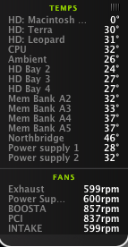

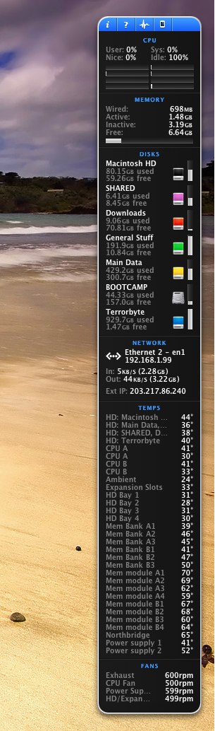

Here is mine 2.93 Octo with the 4870. I just started working about 30 minutes ago, so nothing really processor heavy open right now. I work at home so my first hour or so of the day is spent drinking coffee and catching up on email and news. 🙂

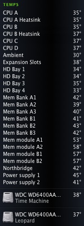

this are the current values of a 2008 Mac Pro (2.8 x 8).
point to note, the ambient is 30ºC and no fan control whatsoever yet, been on since day 1 with the typical reboots after hardware upgrades & software updates. times when mac is shutdown - due for cleaning, system maintenance, esp. the dust collected on the ATI 2600 card.
note: mac was just awaken barely 15 mins ago when screenshot was taken. 'll take another screenshot maybe in 3 hrs time. nothing cpu intensive going on yet.
Seems a tad warm for Nehalem. I'm used to seeing idle temps in the low 40's C.
Not bad, particularly for your ambient of 30 C. 😀

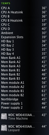

Here's mine… granted it's not strictly relevant to the 2009 models, but I'd expect my Clovertown 8x3.0 to be pushing higher temps on the processor, and of course the FB-DIMMs are known for being hot.
The machine has been idling for a while, so this is about as low as it gets 😎

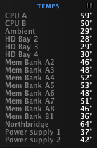

Early 2008 Mac Pro's temp
as promised, an updated post on the temperature after ... well, more than 3 hrs of not so cpu intensive use. i thought i would be encoding quite a few videos but apparently i took a lazy route.
the main difference is the hdd temp i believe. i didn't see the details, comments welcome as usual. thax!

Here is my Mac Pro '09 Quad 2,93

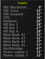

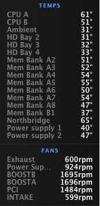

Here is mine this morning with the fans and temps. I haven't installed any fan control yet.

Your Mac seems hot 😕

Again my temps for the moment. I'm not using any soft for fan's control.
